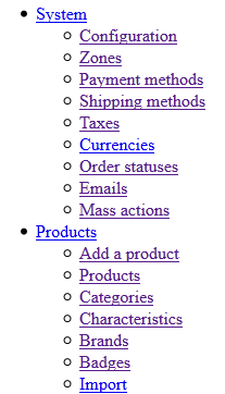

When adding a customer to a new order I used the filter for finding her, which didn't work BTW, I had to manually select the user in the list. I left the name in the filter field though and now when I go to look at this customer in the order I set up the popup is blank. Whats even worse is that when clicking on Customers in the Customers dropdown gives me this!

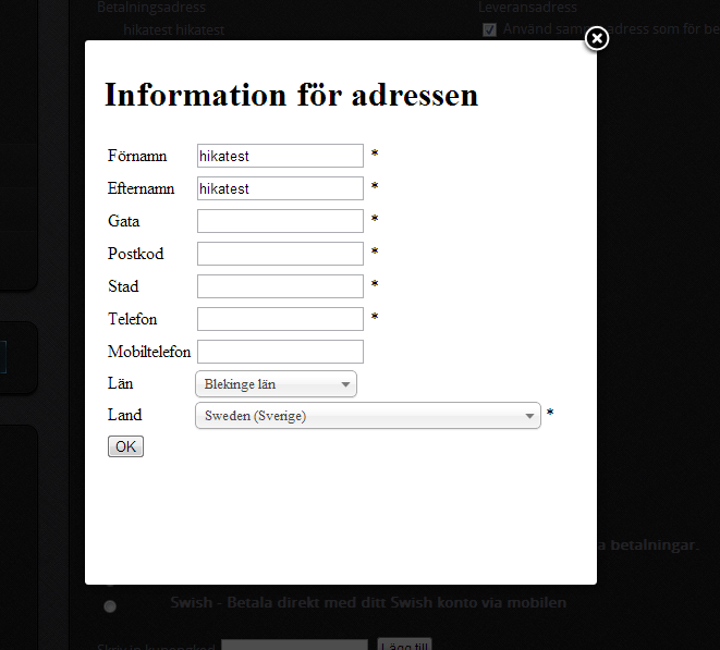

It's always working for me regardless of the link which is redirecting me to your checkout I can add an address through the address popup :
What do you mean by :
I'm not using the link on the checkout page but the one in the TOP RIGHT menu.
Can you explain it to me with some screenshots for example ?

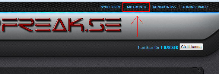

Screenshots comming right up:
From the store frontend.
You click here at the top

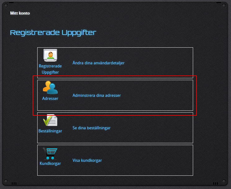

Then you see this which is the control panel from Hikashop

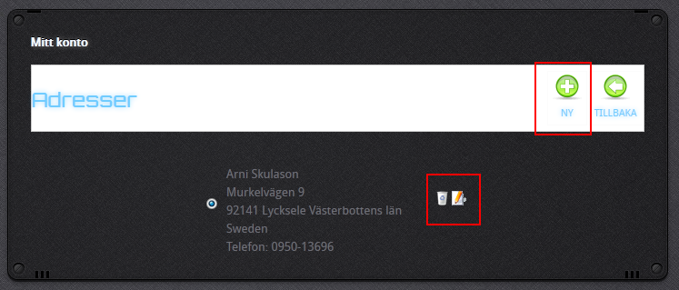

Finally you come here and it's these two buttons that, for me atleast, isn't working.
Pointing at them and looking at the links, they go nowhere: www.puterfreak.se/index.php/mitt-konto/address#
I'm not 100% certain but I do think that they have worked before.
