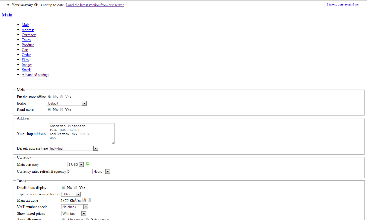

I tried to add a picture.png as watermark and immediately the configuration part stop working. Now when I try to access to the configuration page, this is what I have:
What can I do?
Thank you.

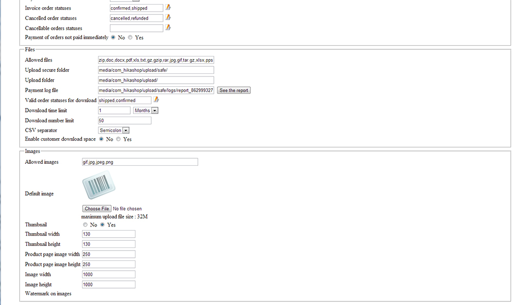

As you can see on this screenshot, there is nothing at the bottom of the page and there is no PHP error log visible (where I can find it?):
I hope to read you soon.
