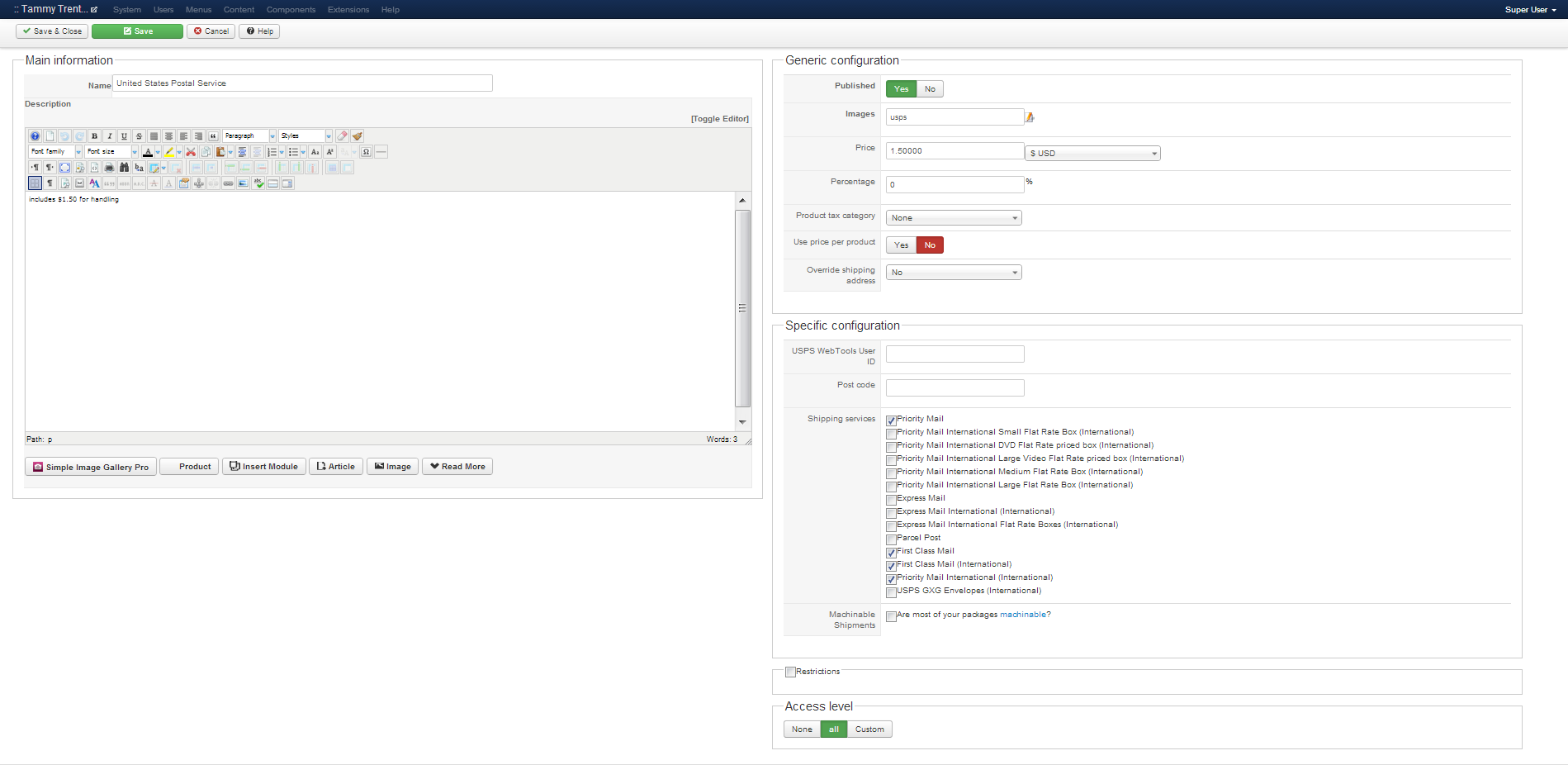

Please provide a screenshot of your USPS plugin options (you can remove the credentials).

13 years 2 weeks ago #119075
Here you go. I took out my web tools ID and zip code.
  • Posts: 86081
  • Thank you received: 14190
13 years 2 weeks ago #119093
These settings are fine. Please make sure that you entered a weight and dimensions for your products.
