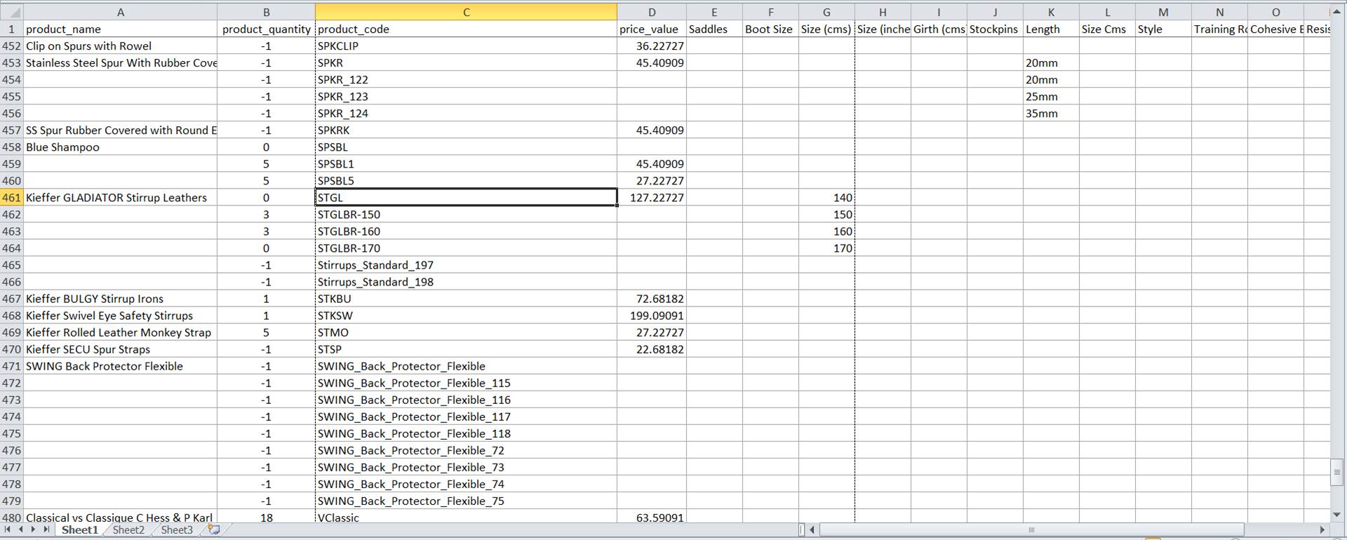

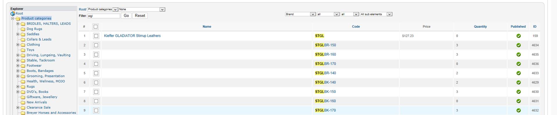

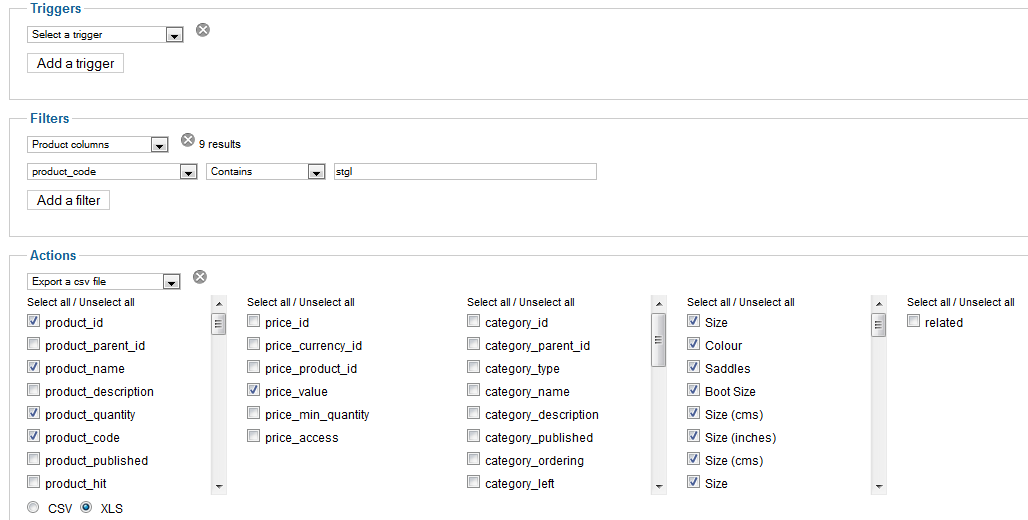

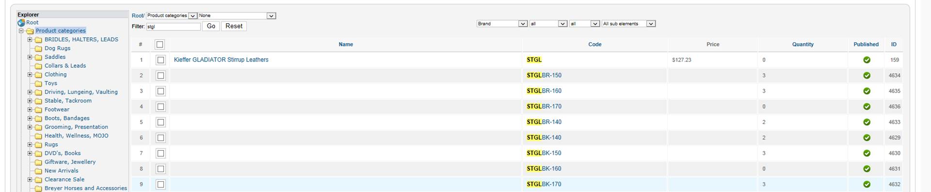

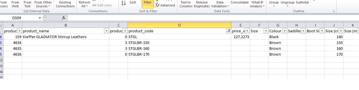

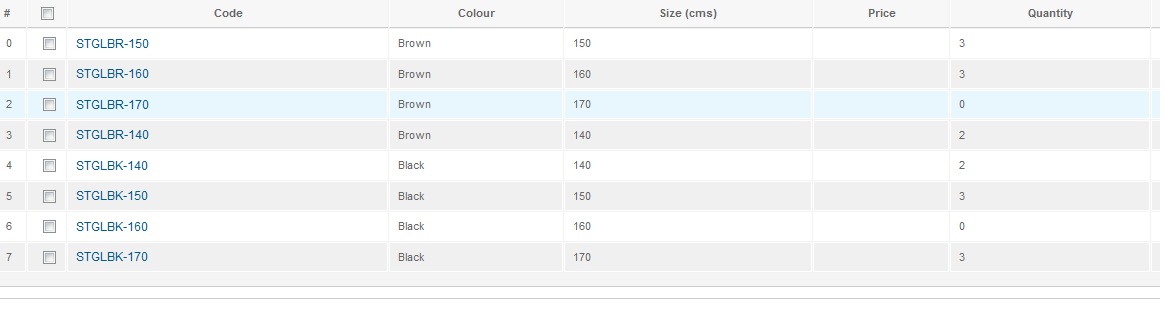

I have set up a mass action report to export all my products and sub item products to a excel report.
However when i run the action it does not reflect the current levels of quantity in the my products within Hikashop.
I have attached 3 images

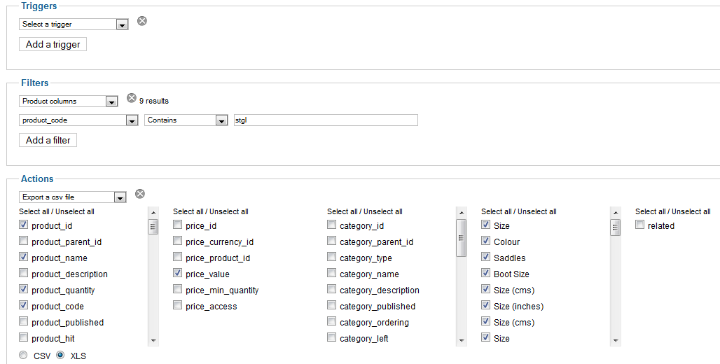

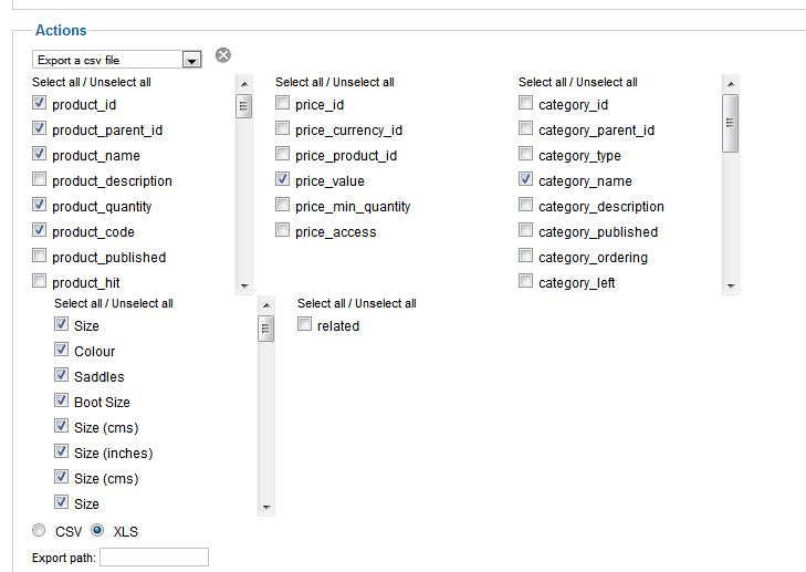

One showing the settings (no filters applied)

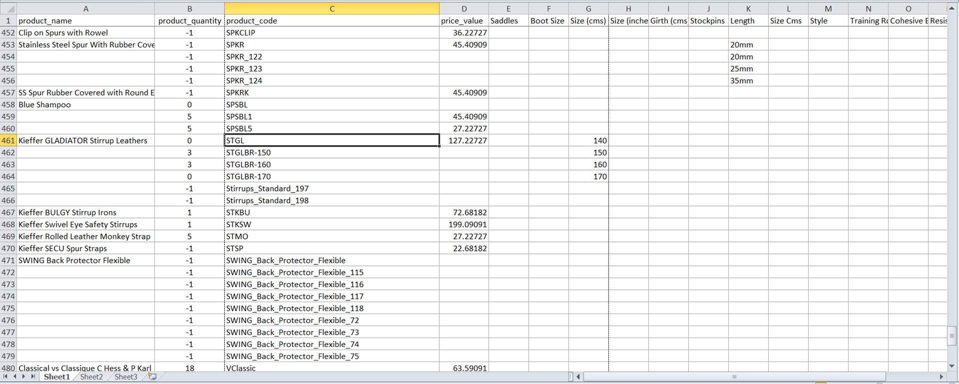

One showing the xls result not showing the correct quantities or missing variants

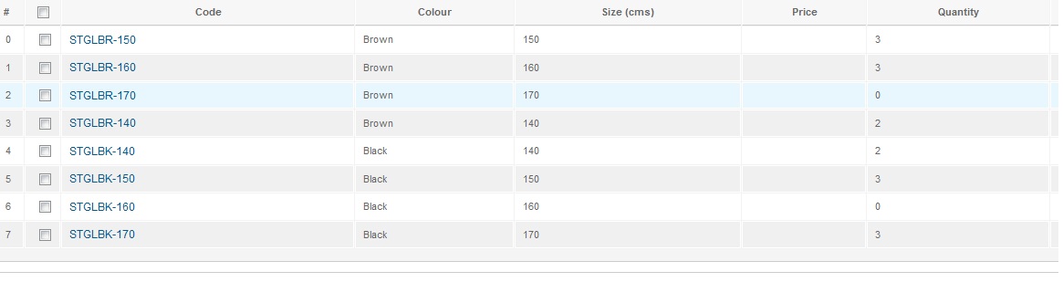

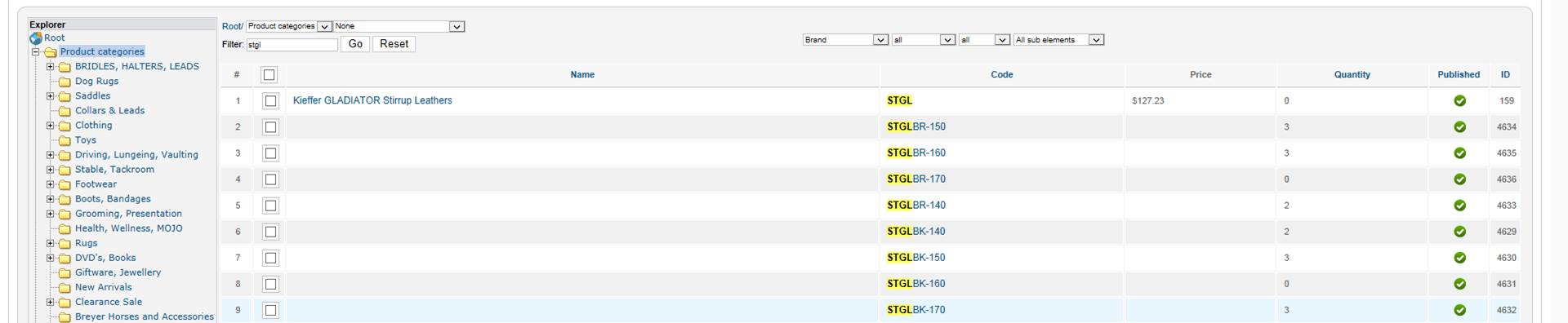

The last one showing the quantities view within Hikashop
It is not a sorting issue btw in the s/sheet
HELP please :)

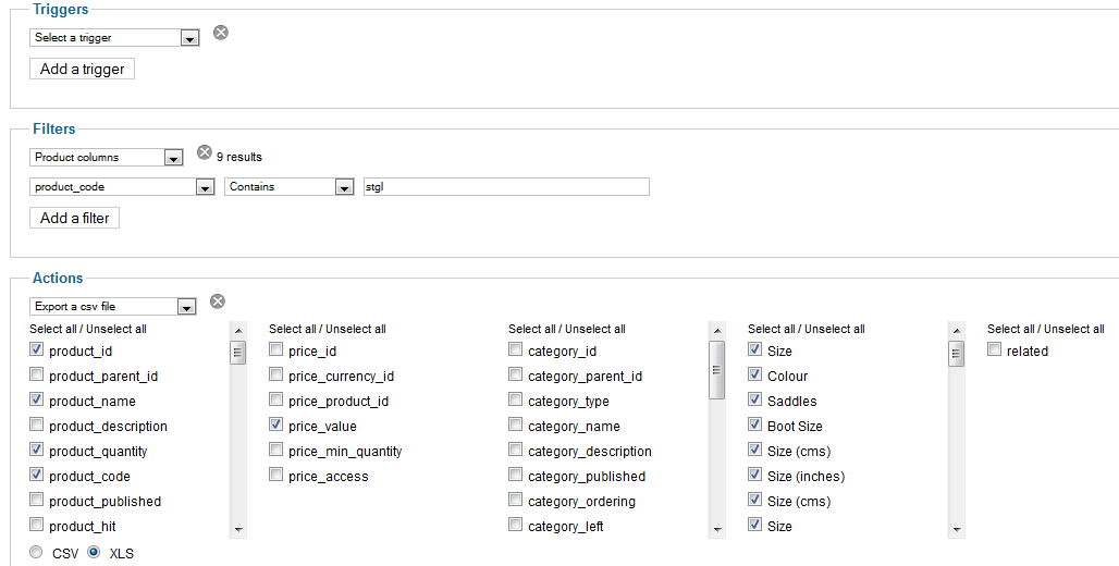

As I can see, the quantities are correct, but some variants are missing.
Are these variants specifics in some parameters, or they are like the other one ?
Can you try to add a filter on the product column code, and add a contains "stgl" to see if all the variants are exported ?

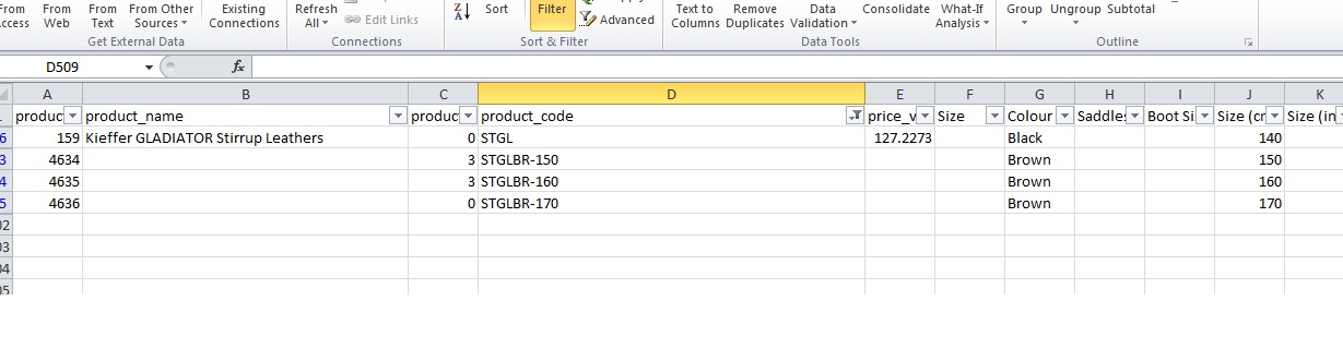

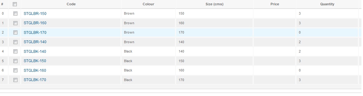

  • Posts: 46
12 years 11 months ago #124116

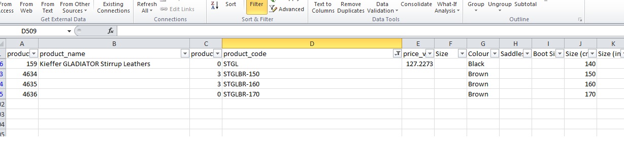

Yes i did that and applied the filter and still they do not all show..
Please see the attached two files
I really need help with this ... many thanks

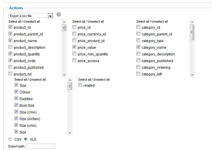

12 years 11 months ago #124662
I just tried the following parameters:
And all the variants are exported well.
I think the problem is that you have too many products to export in one csv, thanks to try to use the limits in the filters and make 2 or 3 export.
We will improve this part of the code nearly.
