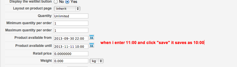

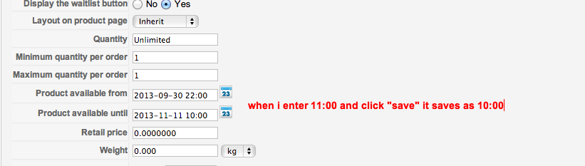

When I go to save "product available to" it saves the hour 1 hour prior. Is there a setting I need to change? This did not happen in the past.. could it be daylight savings?
Actually I now notice that each time I open the event and "save and close" it sets the time 1 hour earlier... so 10:00 becomes 9:00 becomes 8:00 etc without touching the field. Just clicking on the event and then "save and close"

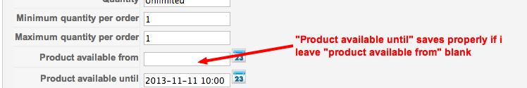

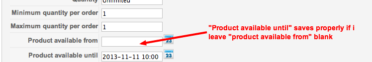

Interestingly the bug does not persist if i remove the "product available from" date/time (eg... leave it blank as in screenshot)

I don't have the issue, regardless of whether I set the "from" field or not.
I can't reproduce the problem with LA as a local zone in the joomla configuration so it's something else.

To be perfectly specific, the timezone is properly set for your PHP scripts, and I don't see any PHP setting on the server that can convert this way the data you submit. For me personally, this is an issue with the component, and a confirmation for this is that if you leave the field Product available from blank, the submitted data is saved properly. If it was an issue caused by server-side setting both fields would have been affected, regardless if one of them is blank, as they both relate to timestamp value.
