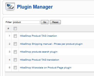

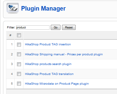

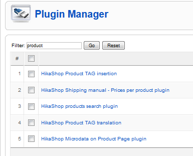

The shop was installed 3 weeks ago, are they up to date?? I've attached a screen shot of my plug ins filtered. None exactly as you mentioned...is it in this screen shot?

It is the plugin "HikaShop Product TAG Insertion".
When I open an HikaShop page in your website I've got:
<!-- version Starter : 1.5.9 -->
Are you sure that HikaShop 2.2.2 is right installed ?

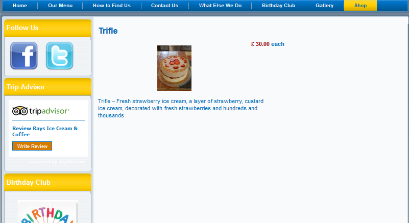

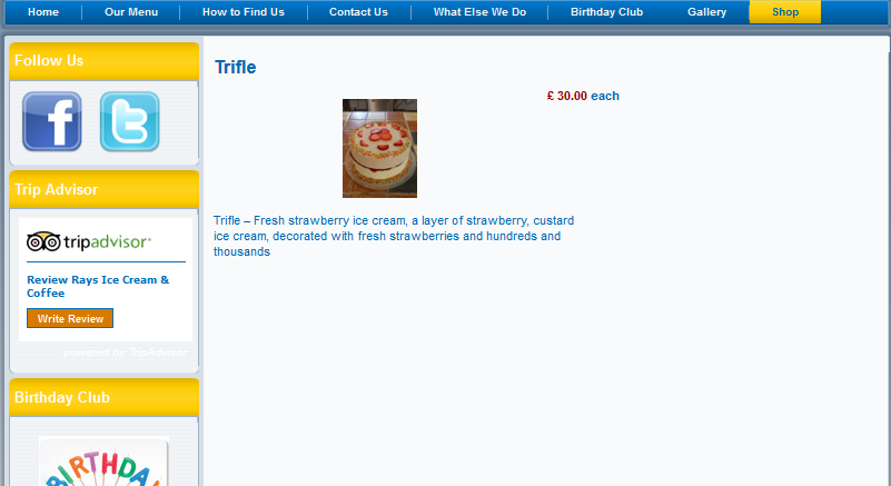

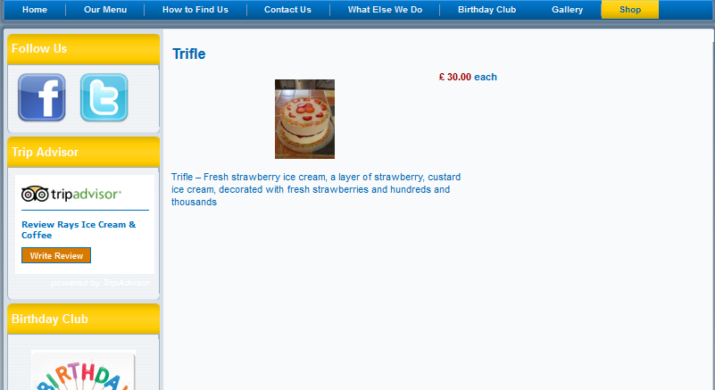

Yes sorry, My site owner turned it off as she didn't want anyone trying to buy anything. When you click through to the product there is no add to basket button. I've attached a screen shot. I have turned the shop off again, just let me know if you need it on and I'll let her know it's been turned back on.

Are you sure that the "catalogue mode" option is not turned on or that the "Display add to cart button" is not turned off in the configuration of HikaShop ?
