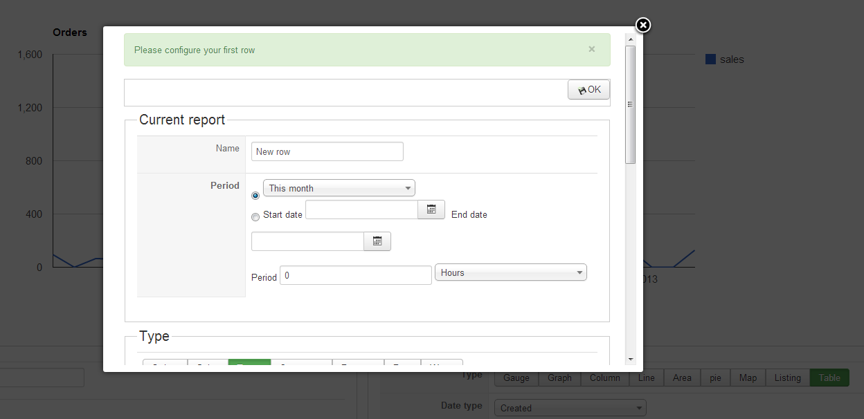

12 years 8 months ago #135795
Also if you try to display a table with tax data (image attached) the following error is returned.
0 SQL=SELECT SUM(prod.order_product_tax*prod.order_product_quantity) as Total, a.order_currency_id FROM jos_hikashop_order AS a LEFT JOIN jos_hikashop_order_product AS prod ON a.order_id=prod.order_id AND prod.order_product_tax > 0 LEFT JOIN jos_hikashop_order_product AS prod ON a.order_id=prod.order_id WHERE a.order_type='sale' AND a.order_created > 1384020571 AND a.order_created < 1386612571 GROUP BY a.order_currency_id
Last edit: 12 years 8 months ago by MumsHealth.
12 years 8 months ago #136126
Please use the "mysqli" driver for your Joomla 3, this database driver have some patch which give you a precise error message for the SQL query (the patch for the "mysql" driver will be in another Joomla 3 release).
Like that I don't see any particular problem in the query so the database error message will give us some precious information.
  • Posts: 68
  • Thank you received: 8
12 years 8 months ago #136283
Changed it and the error is now.
1066 Not unique table/alias: 'prod' SQL=SELECT SUM(prod.order_product_tax*prod.order_product_quantity) as Total, a.order_currency_id FROM jos_hikashop_order AS a LEFT JOIN jos_hikashop_order_product AS prod ON a.order_id=prod.order_id AND prod.order_product_tax > 0 LEFT JOIN jos_hikashop_order_product AS prod ON a.order_id=prod.order_id WHERE a.order_type='sale' AND a.order_created > 1384282128 AND a.order_created < 1386874128 GROUP BY a.order_currency_id
