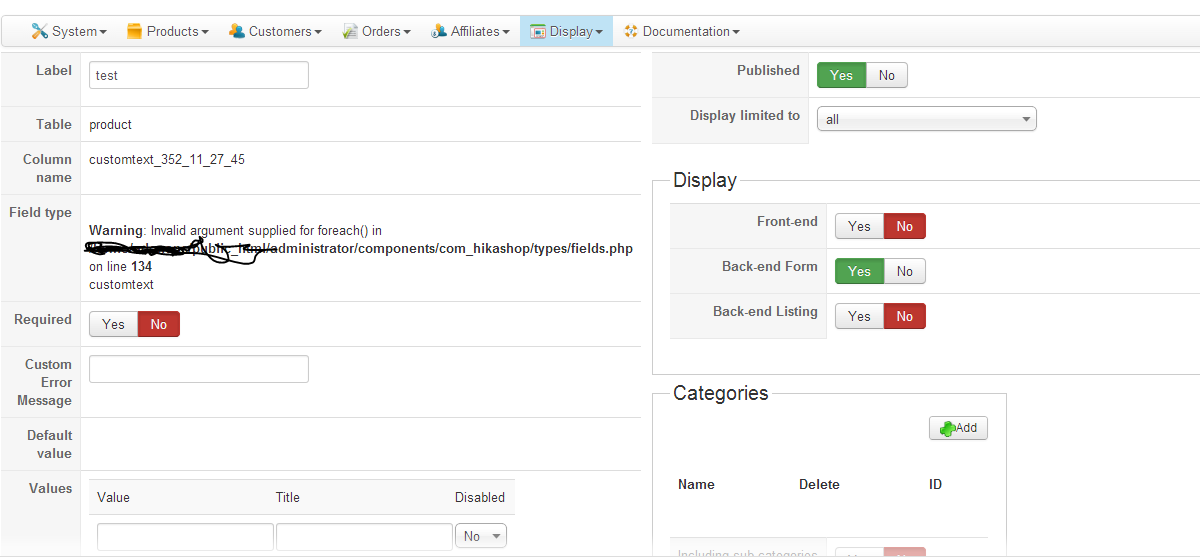

Hi i am having a problem whenever i try to use the custom field type "custom text" under product layout. It gives the following error
Warning: Invalid argument supplied for foreach() in /home/xxxx/xxxxx/administrator/components/com_hikashop/types/fields.php on line 134
customtext

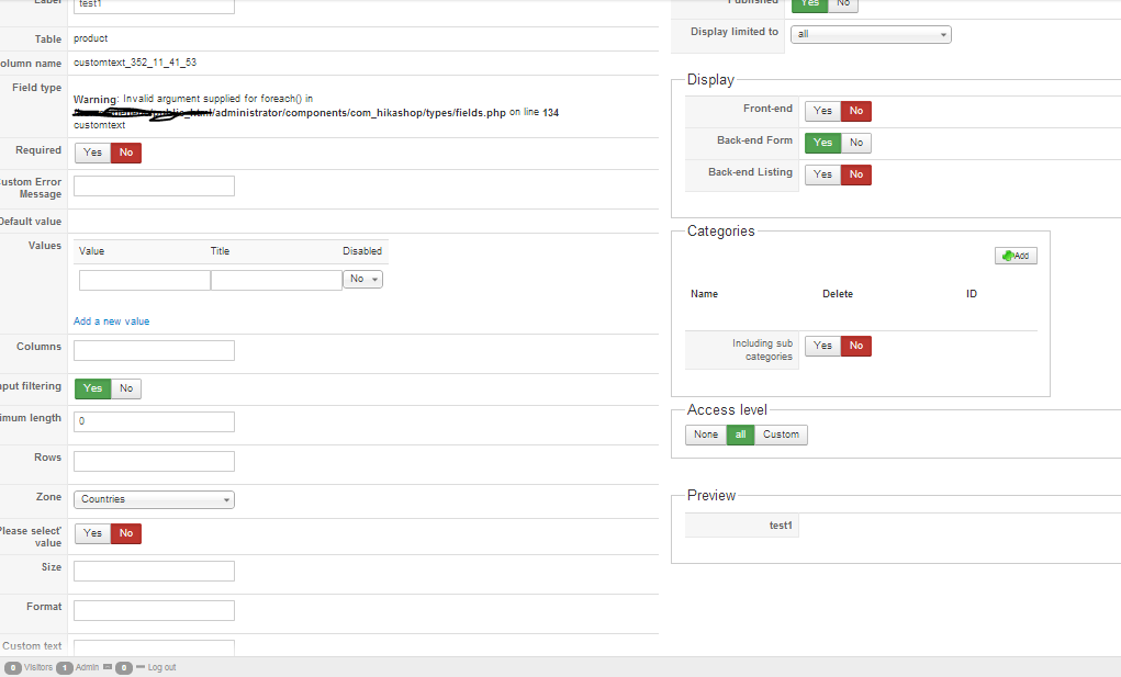

Every other type of custom field works but this. How do i fix this? From what I can tell this seems to be a bug. I attached a screenshot for you. Also, I forgot to mention it seems to show every type of custom field after you save this type. I also attached a screenshot for this.
Thanks,
Josh

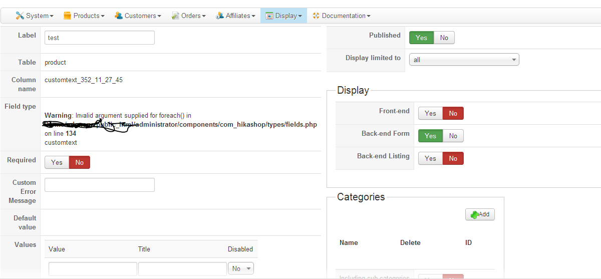

12 years 8 months ago #137346
Thanks to edit the file:
"administrator/components/com_hikashop/types/fields.php", function "addJS()" and add the following code at the top of the function after the "{":
$this->load();
  • Posts: 165
12 years 8 months ago #137401
Hi thanks for the quick response. Where do in insert the code at in the file? What line?
Thanks,
Josh
  • Posts: 86081
  • Thank you received: 14190
12 years 8 months ago #137524
As Xavier told you, it should be just after:
function addJS(&$requiredFields,&$validMessages,$types=array()){
