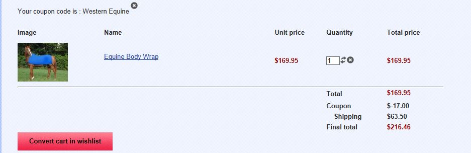

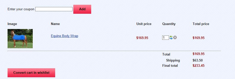

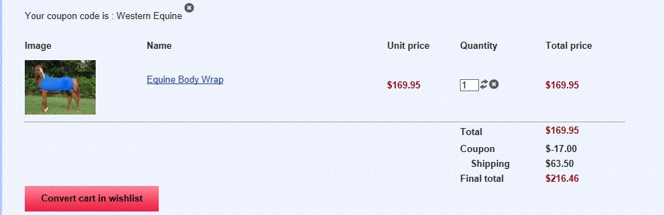

We are using a 10% off coupon and when the order is totaled in the checkout portion, it is not correct. Below are screenshots that clearly show the problem:
Order with shipping only - no coupon. Totals correctly:
Order with coupon applied. Total is incorrect:

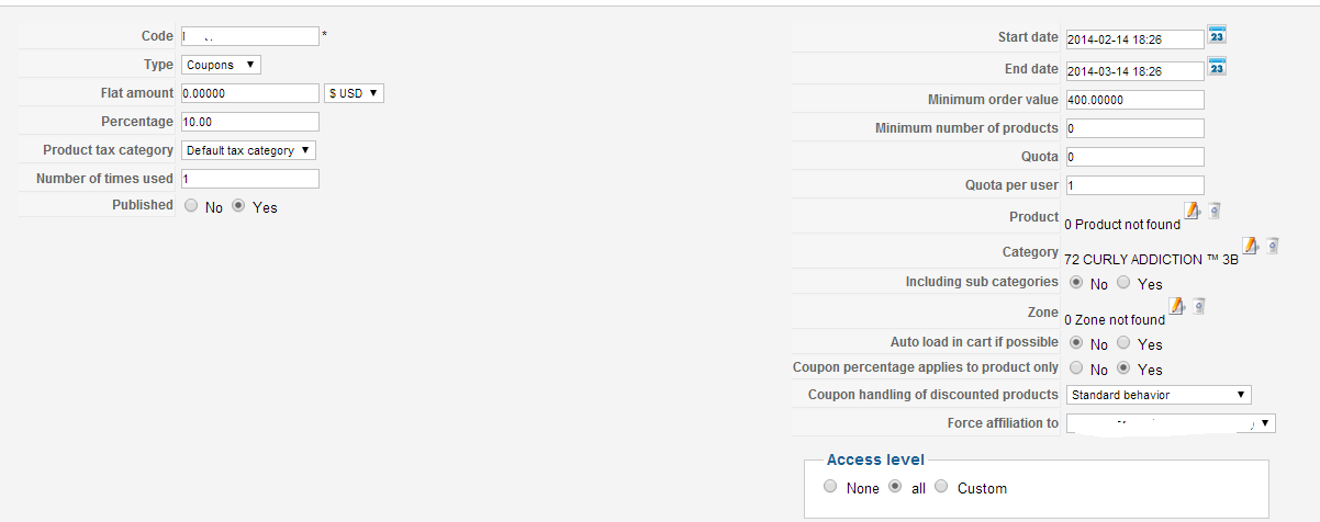

Hello, this is kind of urgent. :ohmy:

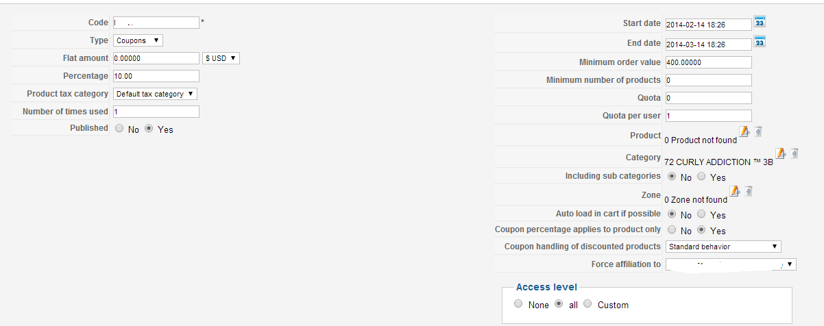

I am running a special and have discount code that I forced to an affiliate.
For some reason, the code is taking more than it should.
The code is for 10% off but below are the subtotal and the amoumt deducted wjich is clearly more than 10%
Subtotal : $819.96
Coupon : $-111.99
Attached image is how I have the setting.
Your earliest response will be appreciated.

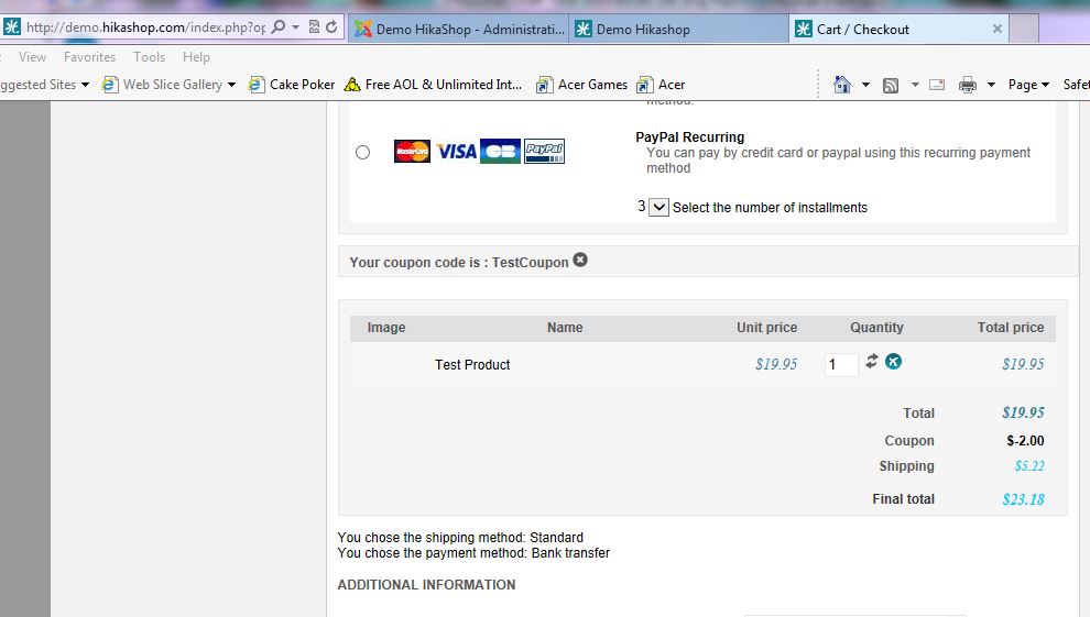

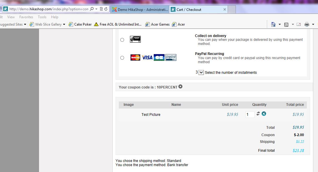

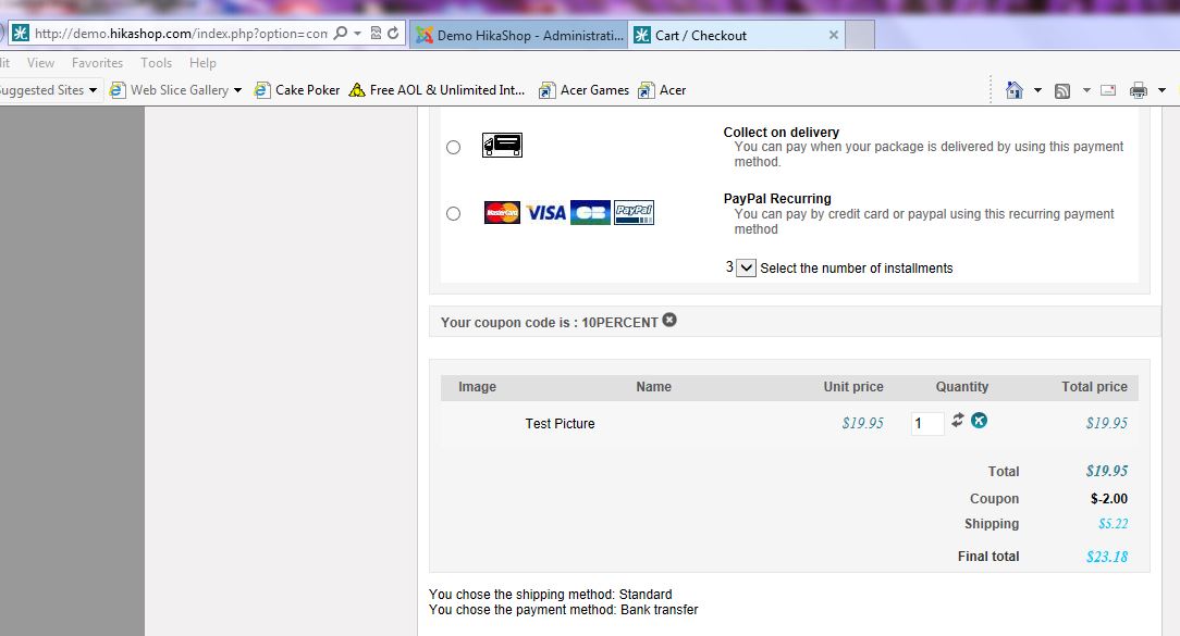

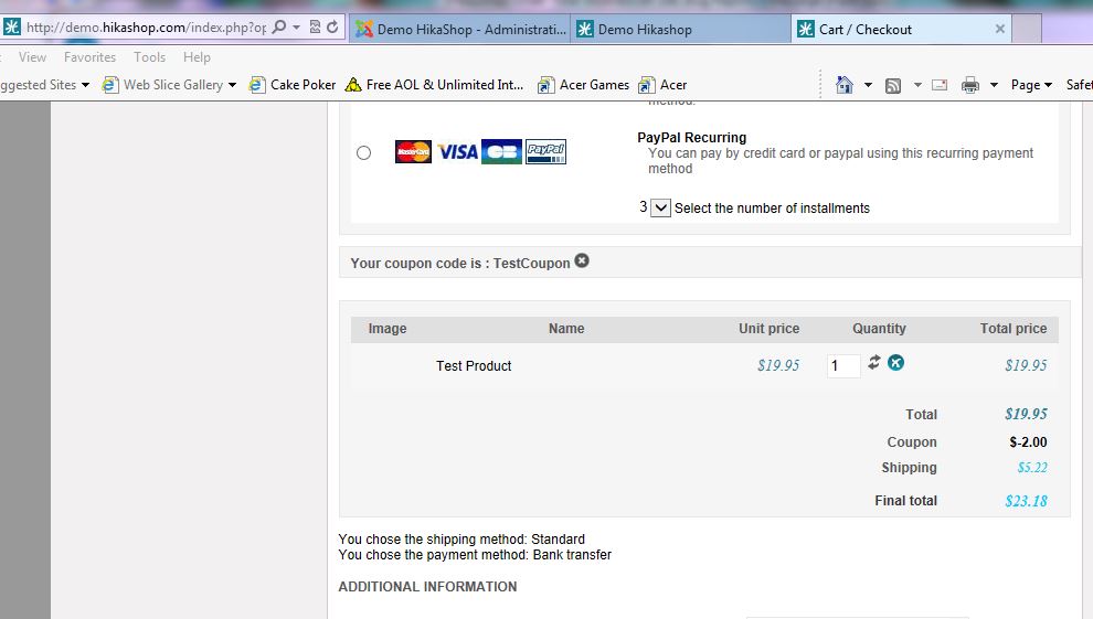

I have just confirmed that my issue with the coupon and cart calculations is DEFINITELY a bug in your software. I used your own DEMO site and replicated the coupon I have on my site. I've provided a screenshot of the cart calculations from your DEMO. I am really a bit disappointed that I've had no response to this issue in almost a week!

12 years 5 months ago #146720

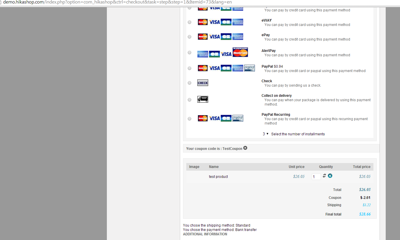

I was able to replicate the issue in your Demo environment though...
Here are the steps I took to replicate my issue in your demo:
1. I added a new product, price $19.95 USD. to the Fashion, Men category called Test Product
2. Changed Main Currency to USD
3. Check that Round prices during calculations is set to yes.
4. Created a 10% off coupon called TestCoupon
In the Demo shop, add one Test Product to the cart, then go to checkout. Apply the TestCoupon at checkout.
Price will be off one cent.

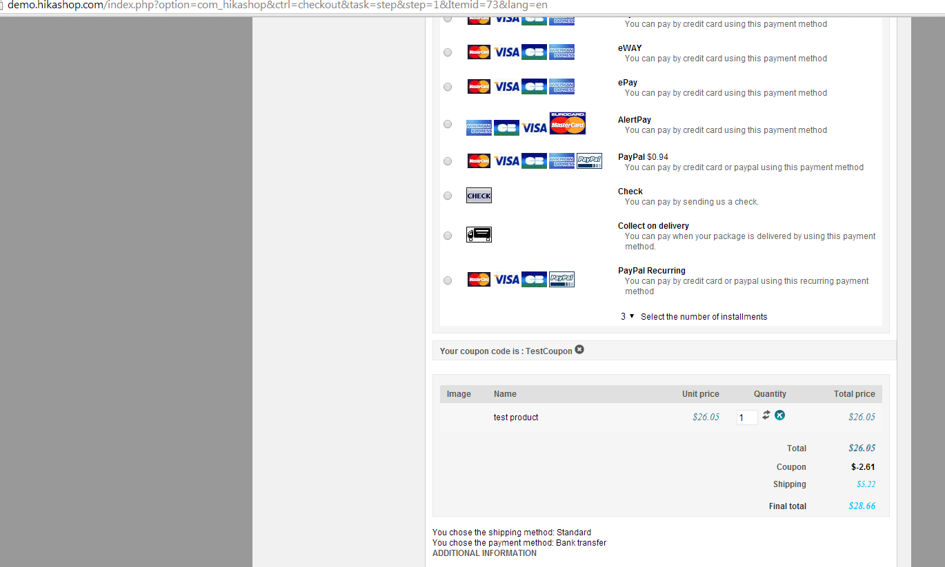

  • Posts: 86081
  • Thank you received: 14190
12 years 5 months ago #146744
Thank you for the exact step by step.
I was able to reproduce the problem now.
Please add the code:
$config =& hikashop_config();
			if($config->get('round_calculations',0)){
				$currencyHelper = hikashop_get('class.currency');
				$coupon->discount_flat_amount = round($coupon->discount_flat_amount,$currencyHelper->getRounding($coupon->discount_currency_id));
after:
if (bccomp($coupon->discount_flat_amount, 0, 5)) {
				$coupon->discount_percent_amount = 0;
				$coupon->discount_coupon_nodoubling = null;
in the file administrator/components/com_hikashop/classes/discount.php and that will fix that rounding issue with percentage coupons with the rounding option turned on when the coupon has .several decimals after the rounding number.

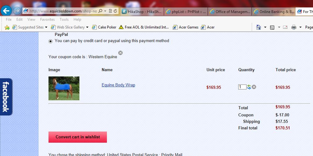

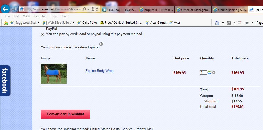

Here is a screenshot from my shopping cart after adding your code:
  • Posts: 86081
12 years 5 months ago #146859
That's why I said that we need to look directly on your website...
It's working fine on our demo website with that fix:
Now could you please provide a FTP access with write permissions so that we can add traces on your website in order to understand the problem that you have ?
