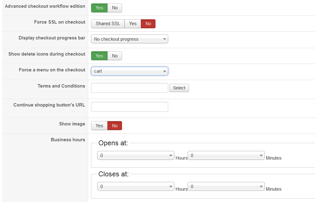

Force menu on checkout is set to "cart" (Site loads originally in NL language. Switching it to EN produces the same 404 error)

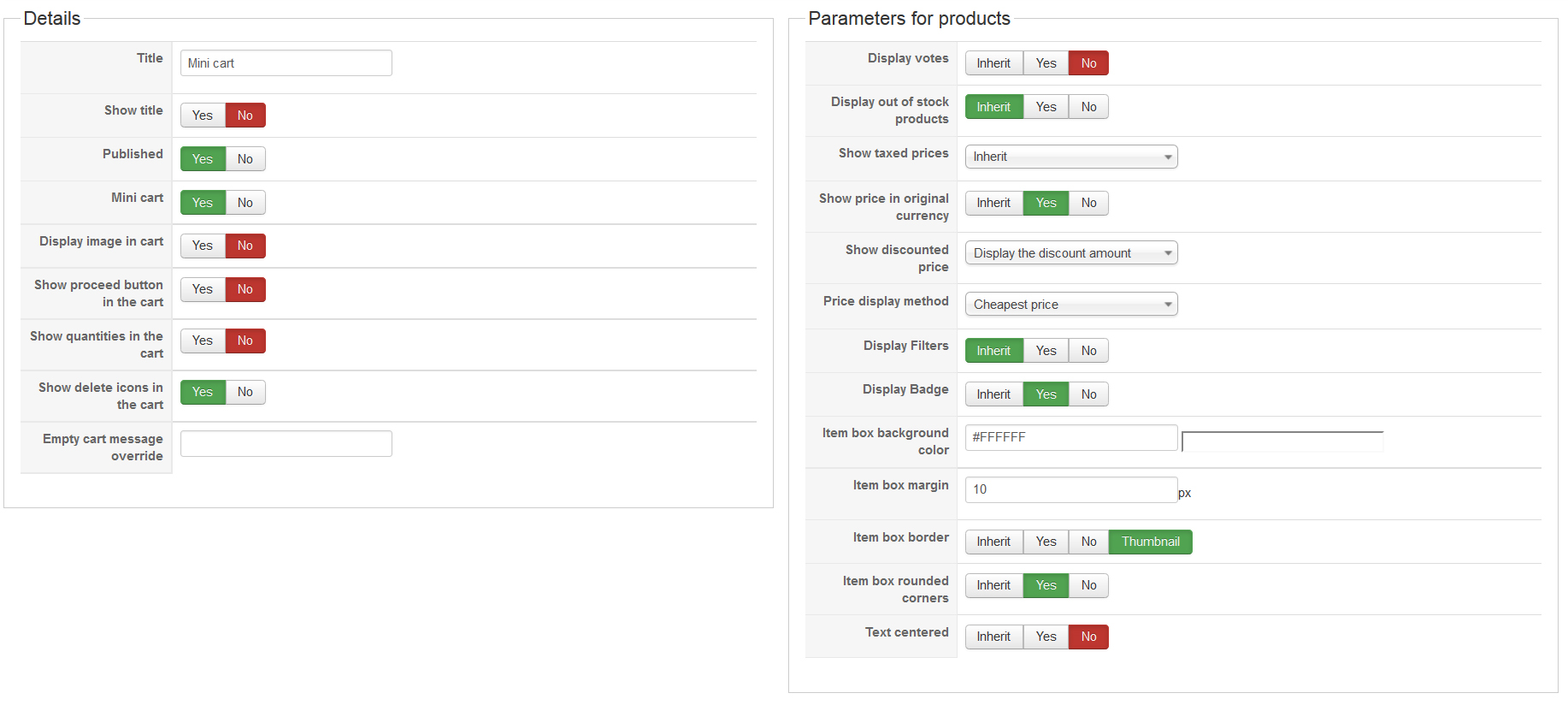

12 years 5 months ago #148906
Hello Drago,

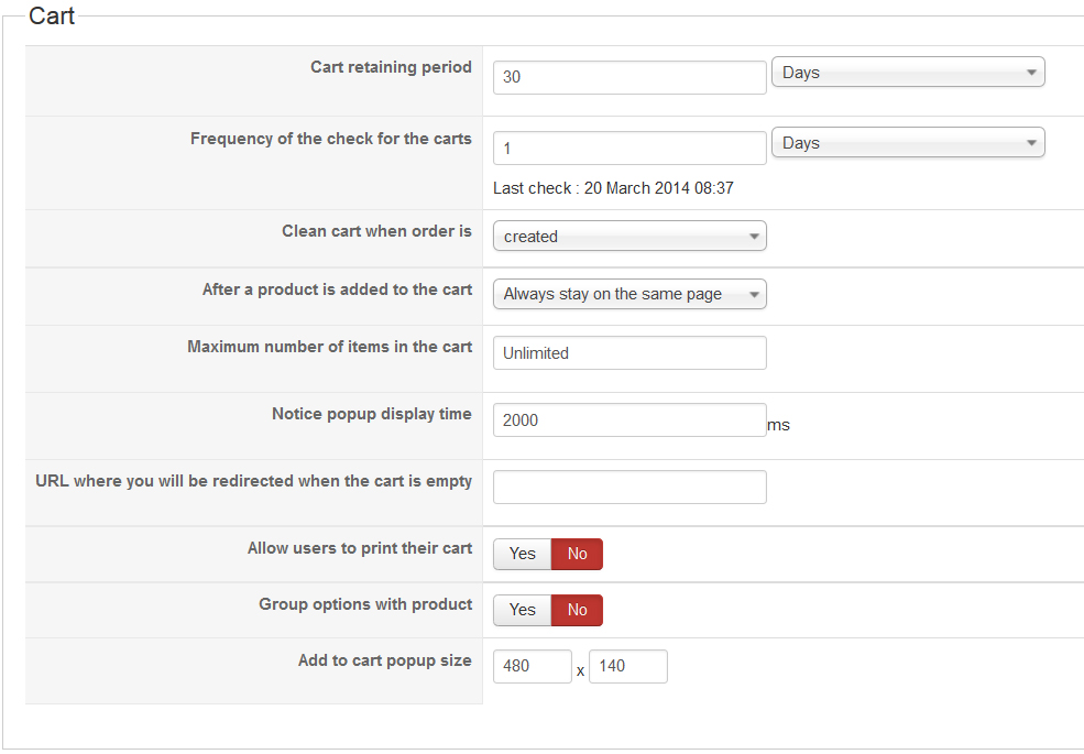

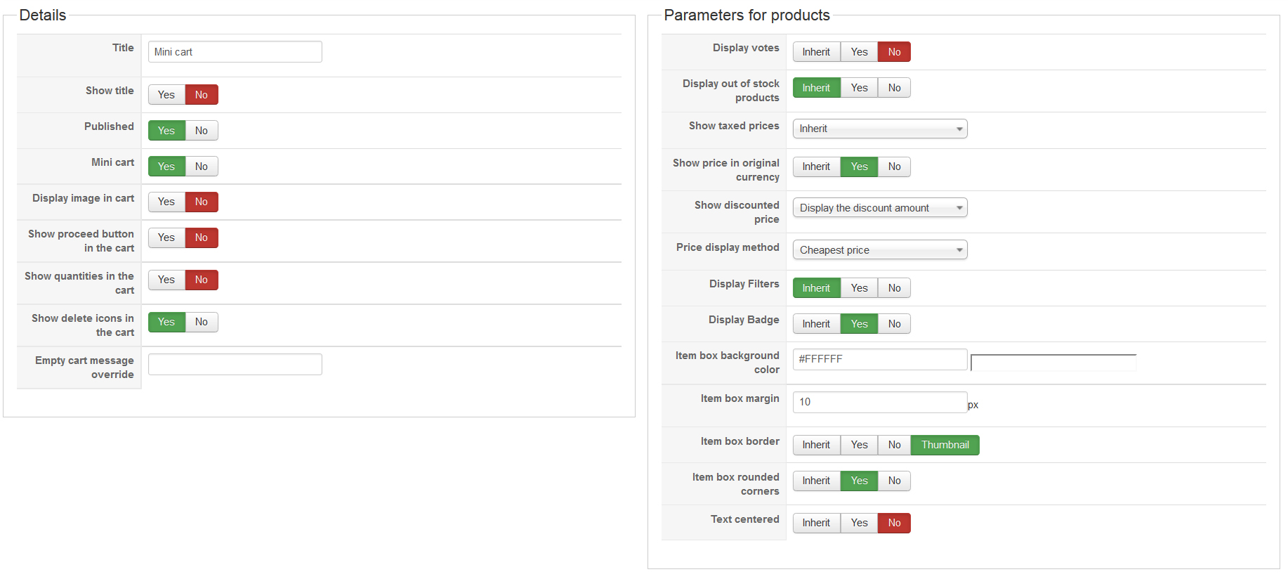

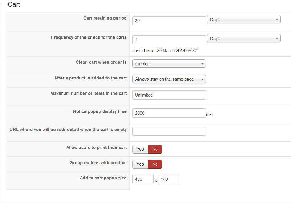

Can you show me some screenshots of how did you configured your Hikashop cart module ?
  • Posts: 57
  • Thank you received: 5

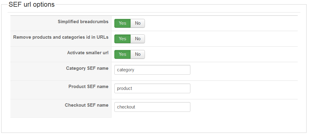

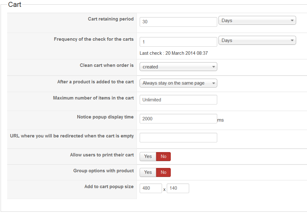

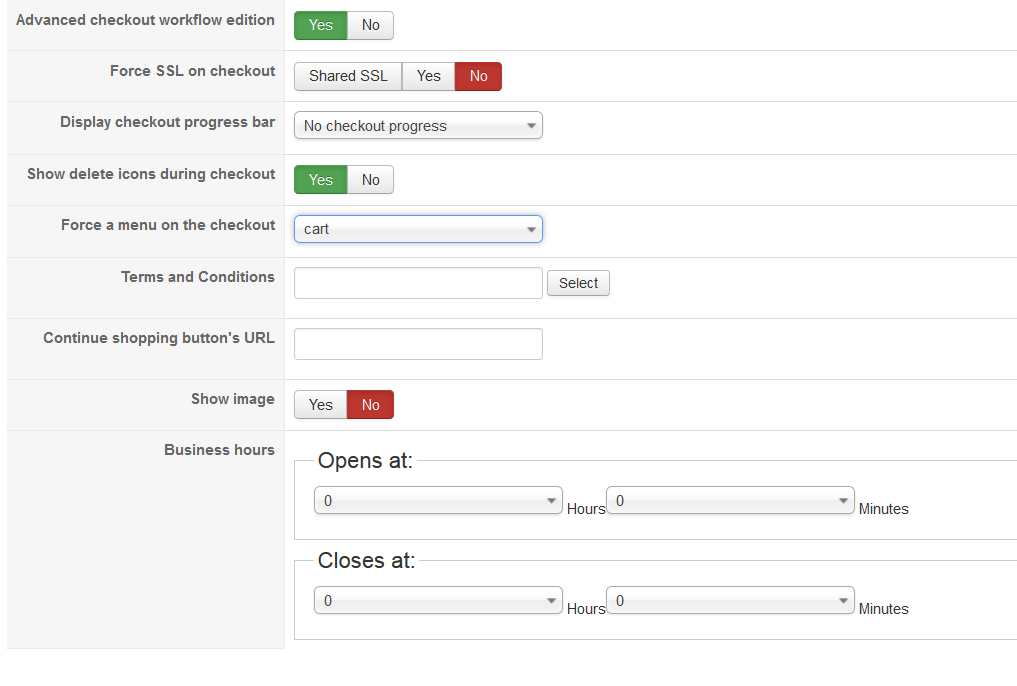

12 years 5 months ago #148914
Hi Mohamed,
Here are the requested screenshots.
Should I set up an admin and ftp account and pm you the details?
Kind regards,
Drago.
