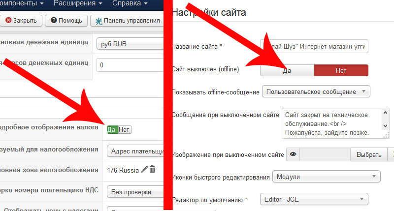

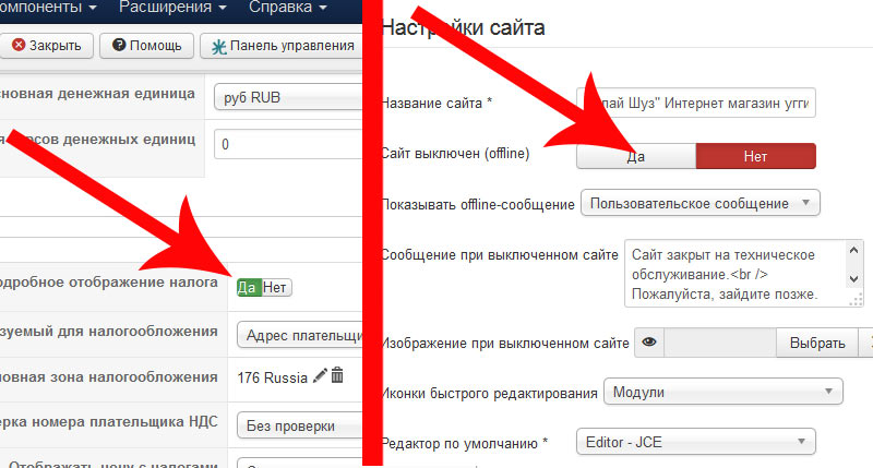

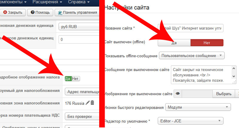

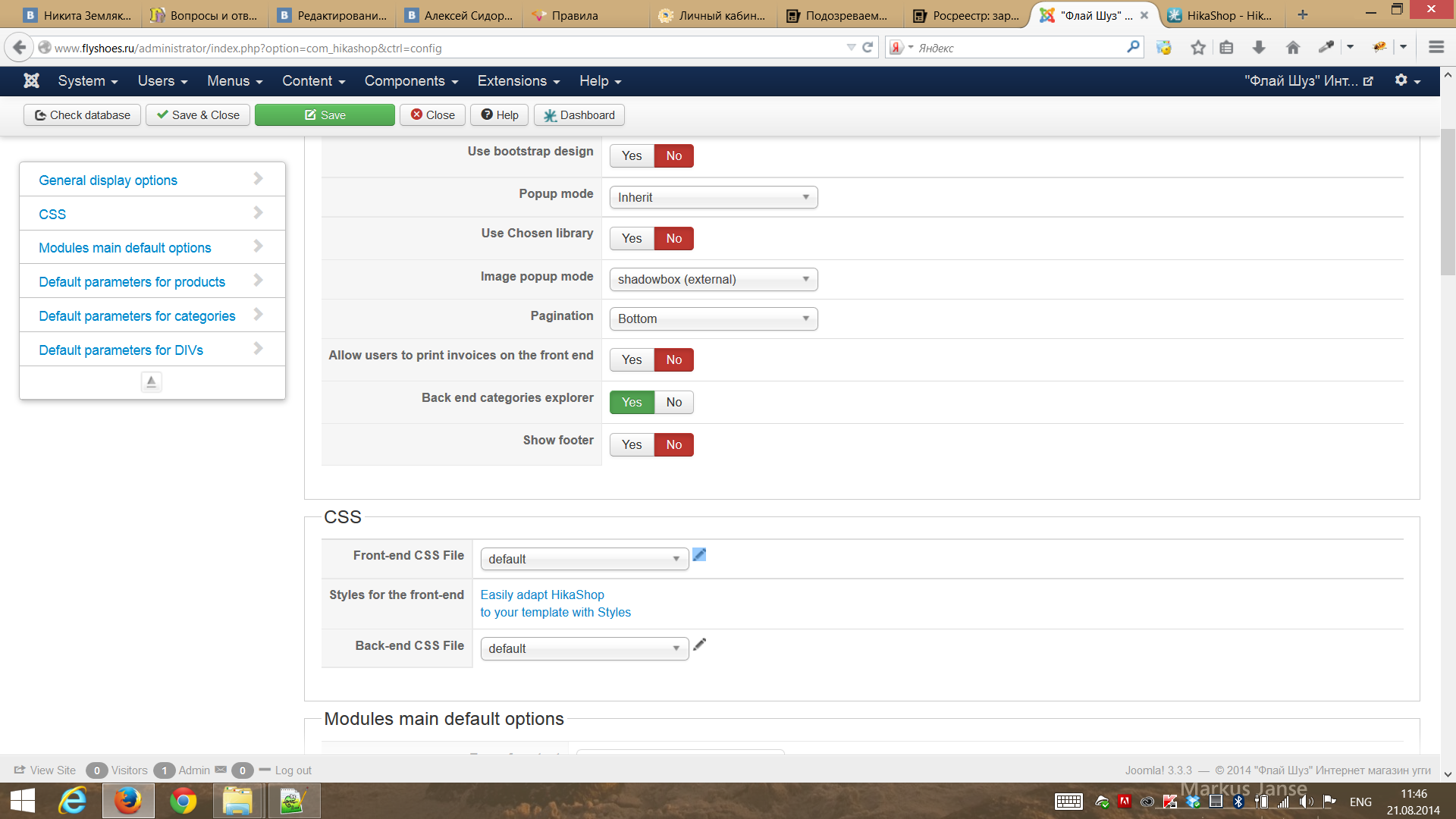

here is you can see that swicthers in the backend is shown wrong. On the right side the standard view of Joomla switchers
this is because of you don't add class "btn-group-yesno" to the
<fieldset id="config_store_offline" class="radio btn-group">
if you add this class they appears normal.
Could you fix this?

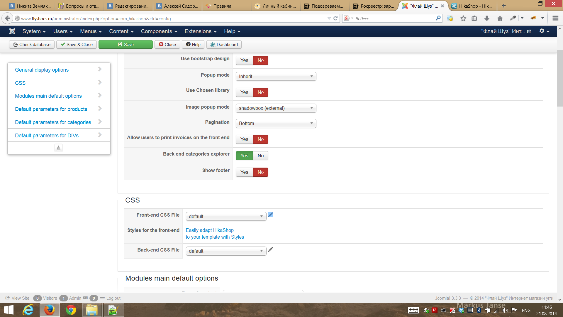

I have repeated this on many sites with clear installation of joomla and hikashop
on every site and every browser I have the same result

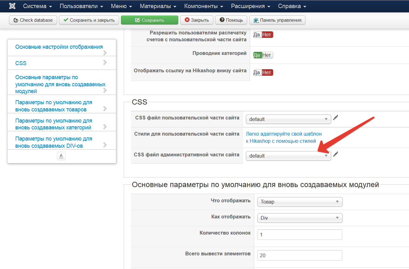

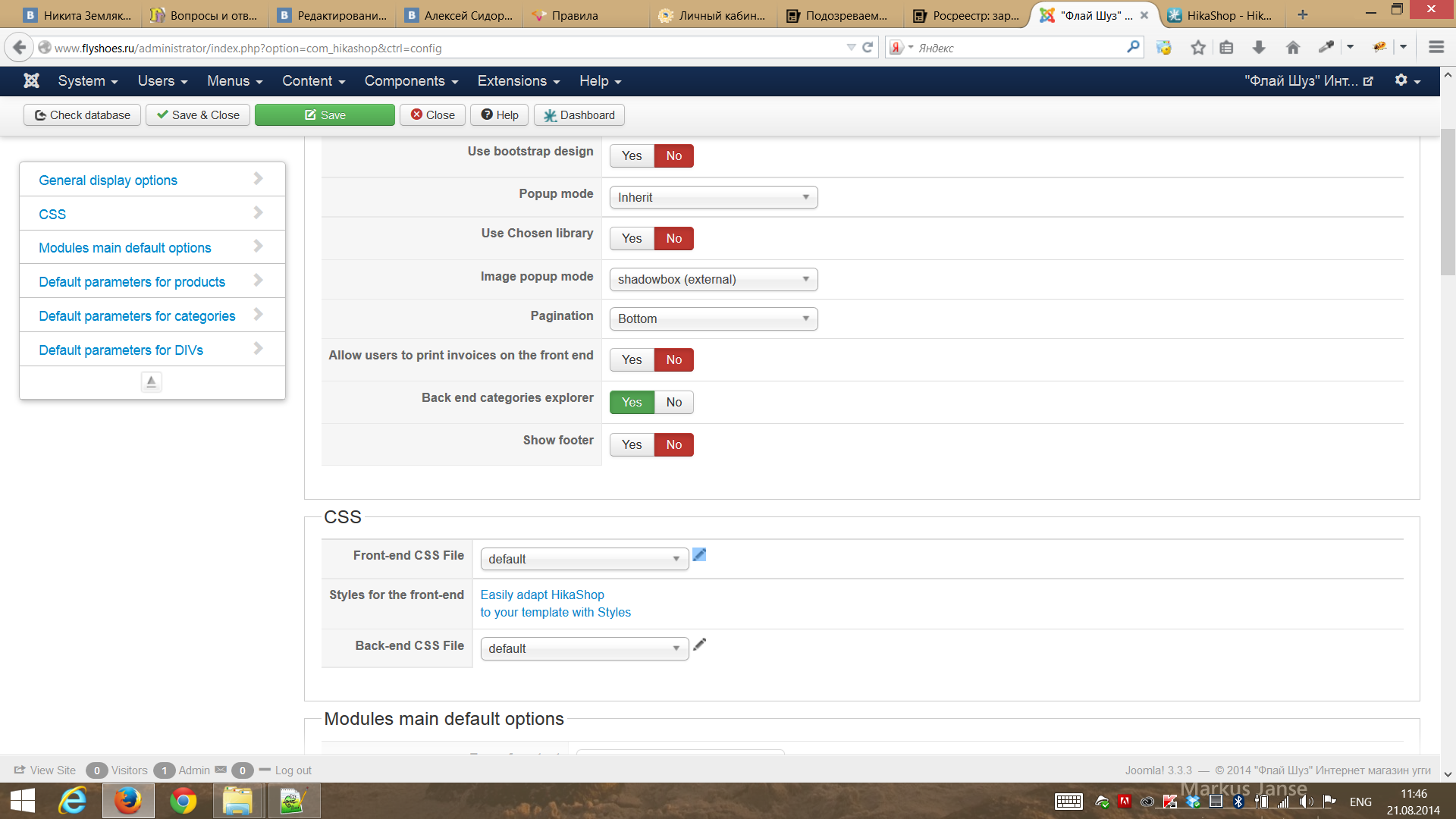

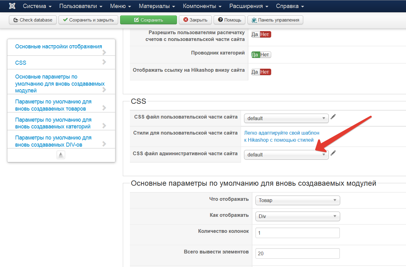

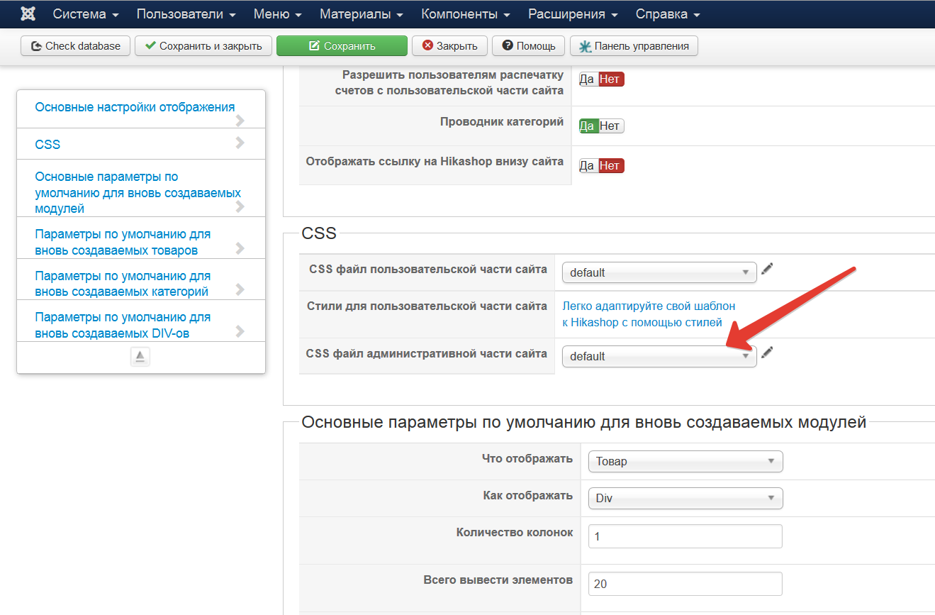

here is my display

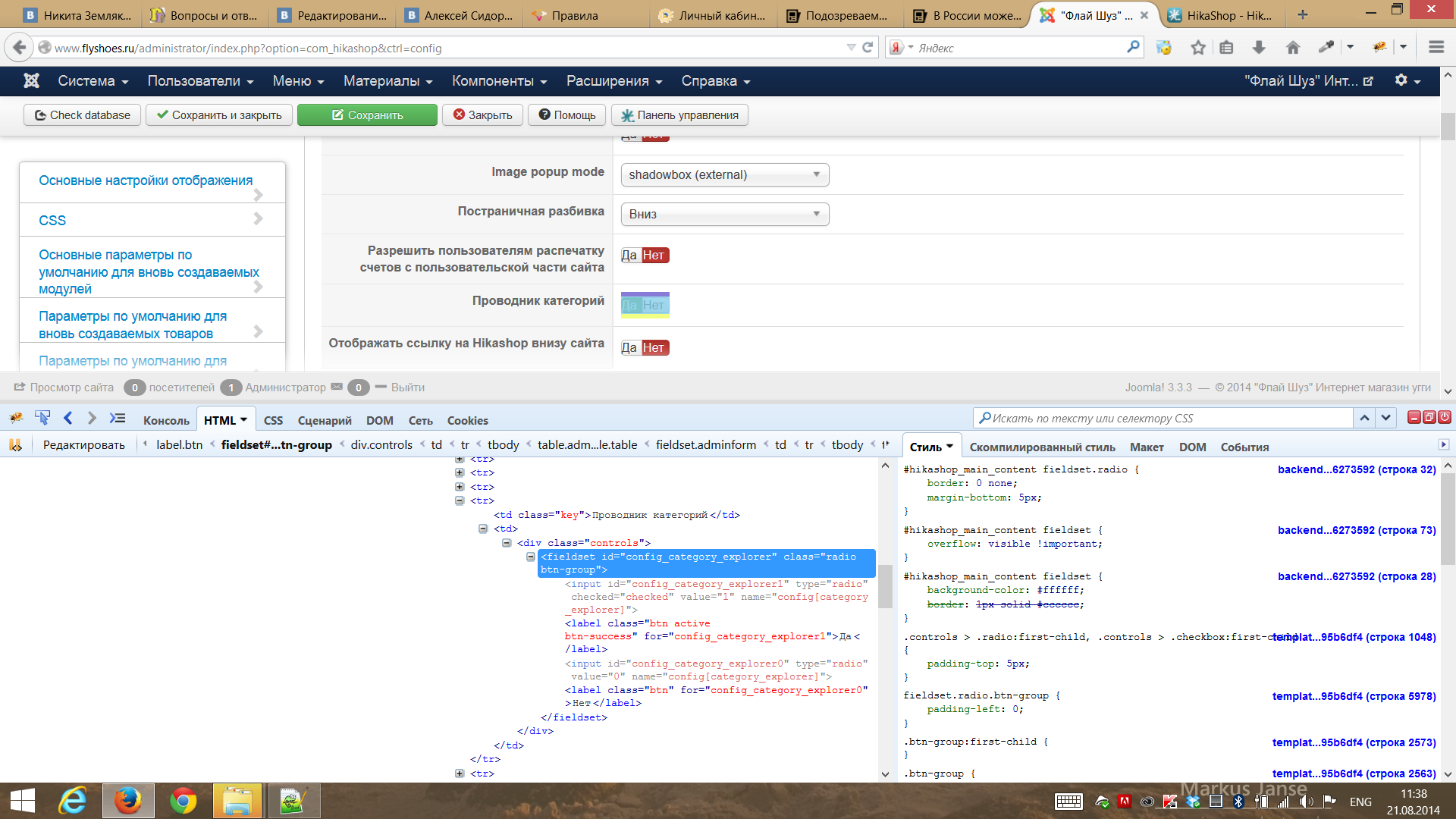

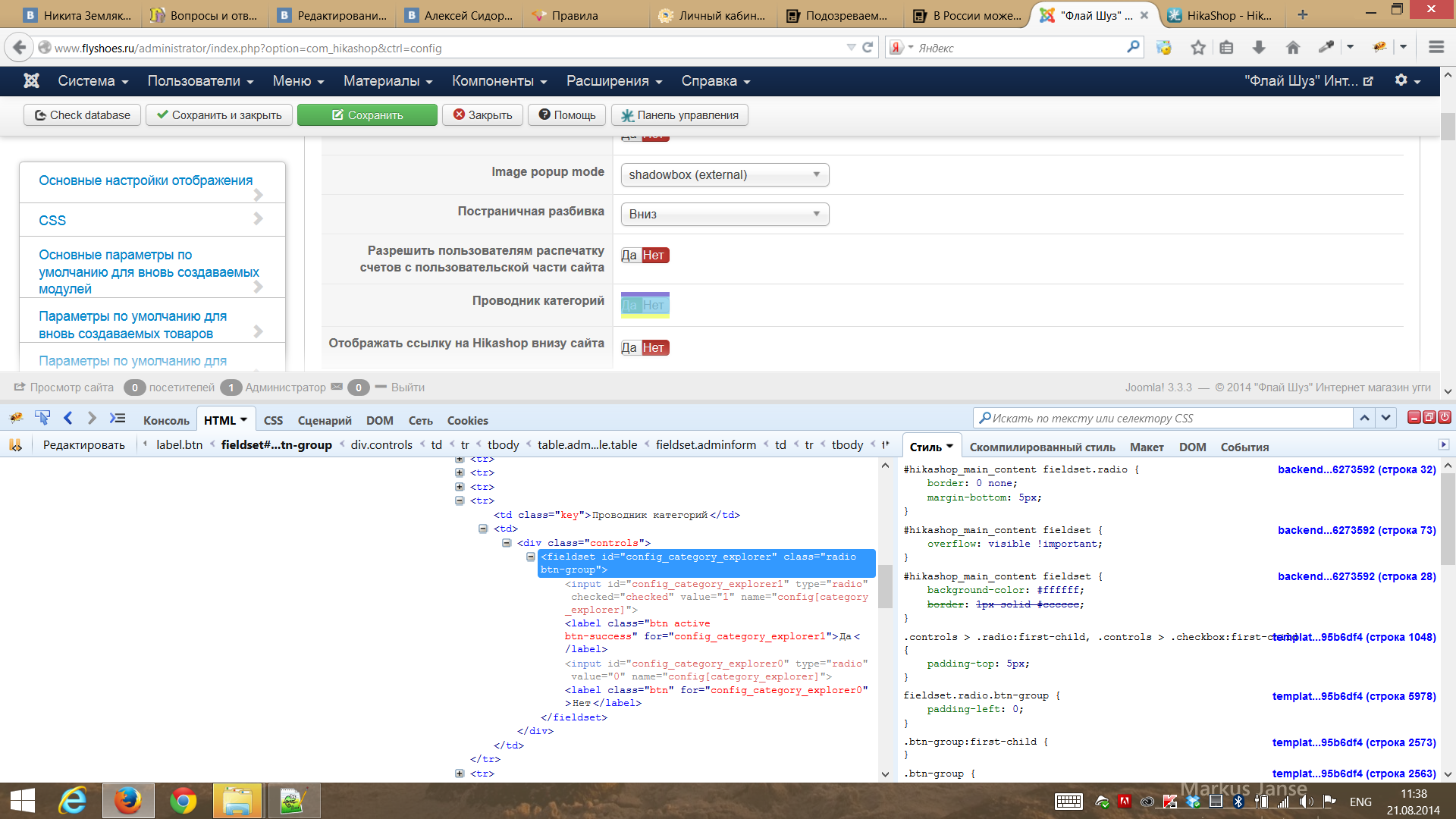

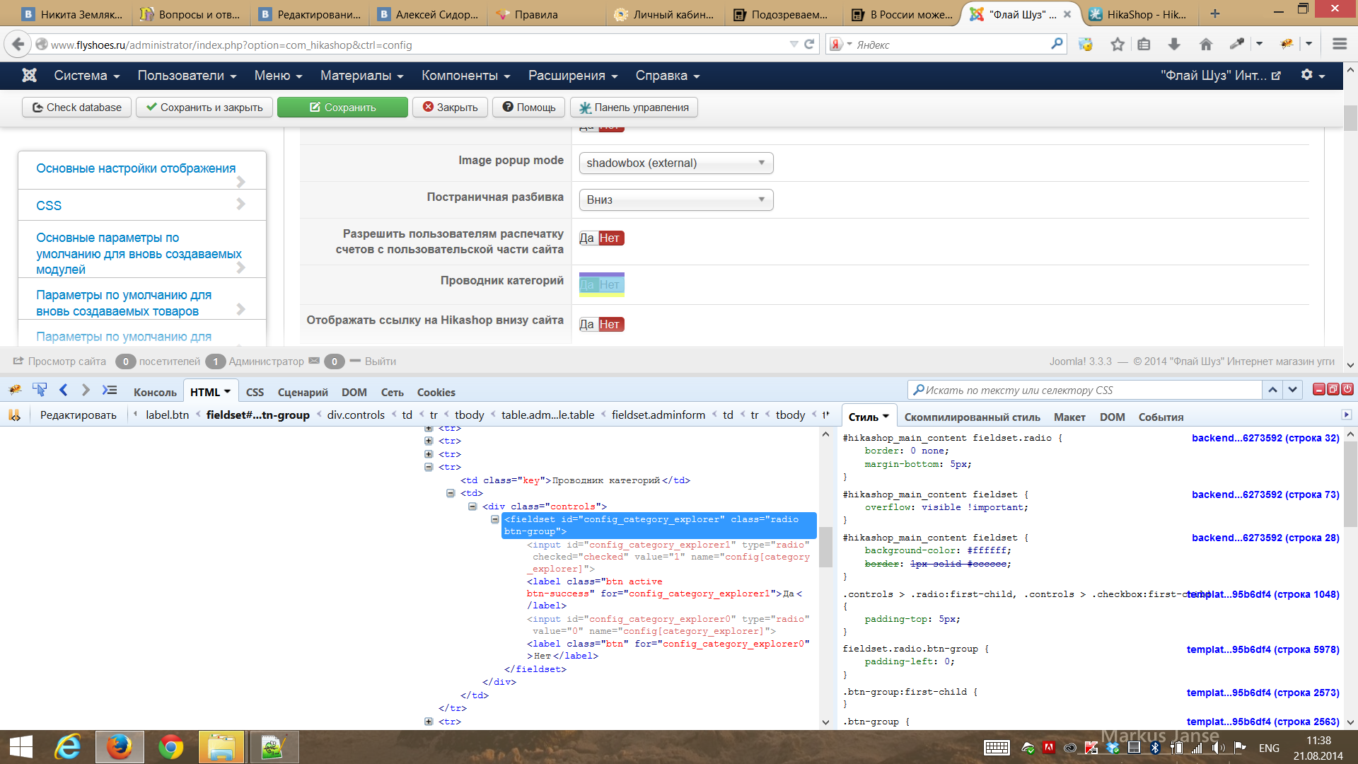

and this is the firebug that can proove that always ok with your backend.css but it doesn't display well this buttons

11 years 10 months ago #168294
the problem is with css file that russian administrator panel turn on
this line will help
fieldset.btn-group label.btn {padding: 4px 12px;}
if I add it to the default.css this fix the problem
