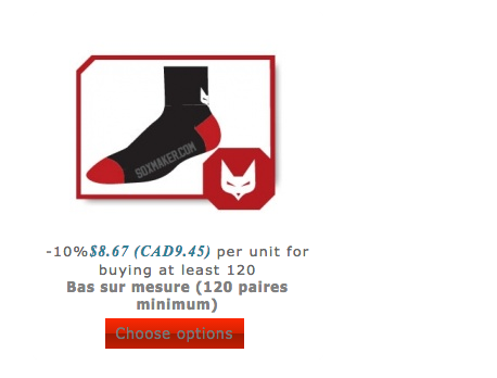

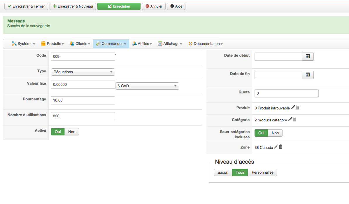

I have a problem with the coupons. It does work properly, if you go on the site and try for example the coupon 009 (20% off in the Canada region) you will see what ot does. Even if you dont enter the coupon number its taking 20% off any item? Before updating Falang, Hikashop and joomla to there last version the coupon system was working just fine, the discount appeared just before the taxes at the bottom of the order page, now the bahavior has changed and its showing (-20%) just beside the price of the product? Nicolas from Hikashop knowns about this as i send him a couple of emails about this, but i'm still waiting for his reply.

i understand your explanation but here is my problem. I created a discount of 10% for users in Canada, so this is suppose to show to a product but only once a user is logged in and Hikashop system can verifiy his address right? But this is not what happens, the discount shows on the products anyway, even if you are not logged in? Is this normal? As for the coupon with a flat rate, i'm able to enter the coupon # and see the amount applied on the order even if i did not register the account yet, is this normal? Don't we have to be logged in for the system to check the address first to apply or not apply the coupon of discount depending of the zone?

In the discount / coupon settings, if you want to restrict it to a zone, as you said, the user must be logged in in order to have his address. So you can set a restriction for the coupon/discount on the user access level too.
Allow this only for the registered customers and in the correct zone. This way you will have the desired behavior.

i dont think you understand, sorry. I know how to set-up a discount, you go in "Composants/Hikashop/réduction and then you configure what you need, you select a zone where the discount is to be valid and so on... The problem l'm facing is that even if i dont register as a user on the public site, i'm able to see the discount on all the products. As soon as a %% discount is activated on the back hand i go back to the public site and when i browse the products l'm able to see (10% discount) on each product? Thats not normal is it? If i use a Coupon with a fix amount and not a % discount then it works fine.

1. When you create a discount via the menu Orders>Discounts you have a "type" option where you can choose between "discount" and "coupon".
A coupon will only apply on the total of the order and the user will have to enter the code of the coupon in the checkout for that and the system will validate the restrictions before.
A discount will apply automatically to the products prices if all the restrictions of the discount are met.
The fact that you see the discount in % applied to your products prices and that you don't see the coupon in fixed $ applied to them is thus normal since it's because they are of a different type. It has nothing to do with whether they use a % or a fixed $.
2. If you restrict a discount/coupon to a zone it doesn't mean that the discount/coupon will only be displayed/usable after the user logs in. The discount/coupon will be displayed/usable as long as the current user zone is the zone of your discount/coupon. When the user is logged in, it is the address country/state which are used for the current zone of the user. When the user is not logged in, it is the main tax zone of your HikaShop configuration which is used.
On your website the main tax zone is Canada, so the discount/coupon will be displayed/usable even for non logged in users because the discount/coupon are restricted to that same zone.
If you want to have the discount/coupon displayed/usable only for logged in user, then, you want to set the "Access level" option of your discount/coupon to the user group "registered".
