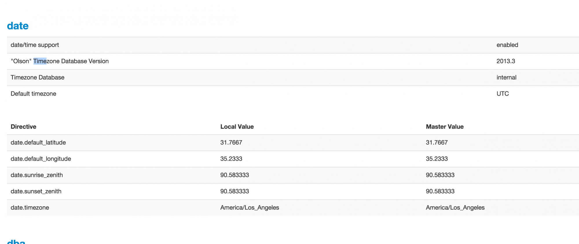

Here is a bit more info from our developer:
I believe that's it is due to timezone used in hikashop ,Please ask hikashop which timezone they are using ?
please go to : www.staging1.wodrocket.com/ajax/cnn.php ,you will notice that the time is not the same because in first it is using default timezone and in the second we are using date_default_timezone_set('America/Los_Angeles');
the time can be different from time of hikashop of 2014 Wodapalooza Winter Classic (Individuals) and that due to the cache .

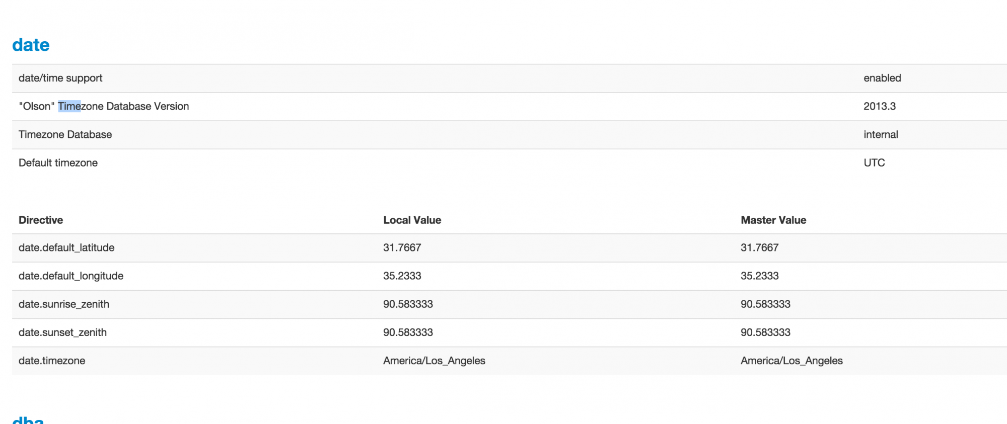

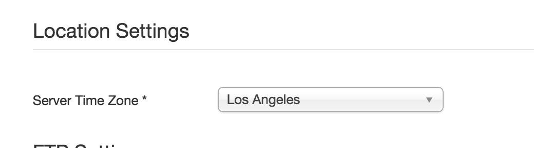

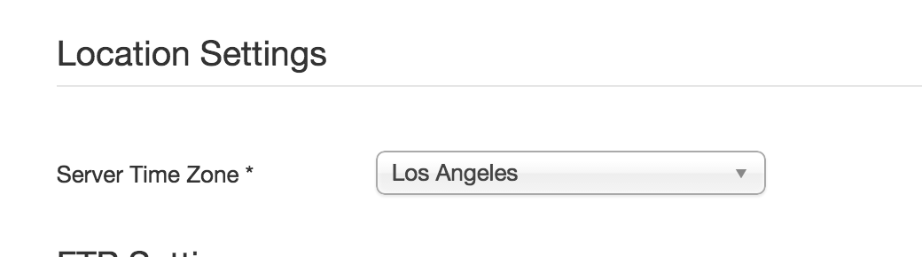

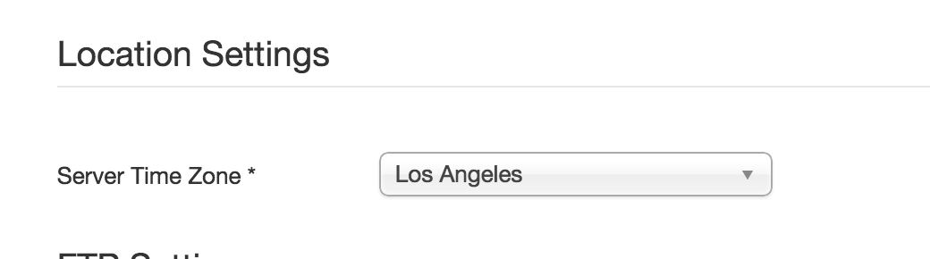

11 years 9 months ago #180580
That is fine except the whole component is acting strange.
Our timezone settings are not extraordinary:
And yet we have crazy hikashop time outcomes as per the above.

11 years 8 months ago #181919
In Joomla 3 ; when we display a date, we directly call the Joomla JHTML date.
So it means that it is Joomla which display the date based on the given timestamp.
For the save, the calendar is the official Joomla calendar and we convert the date into a timestamp.
During this conversion (the function hikashop_getTime), the Joomla configuration is read in order to get the time offset.
So you might have one hour of difference between your Joomla time offset configuration and the PHP time offset (given by " date('Z') " ).
