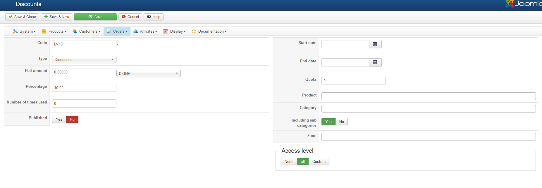

-- url of the page with the problem -- : www.houseoflights.co.uk/index.php/homeware/checkout
-- Joomla version -- : 3.4.0
-- PHP version -- : 5.4
-- Error-message(debug-mod must be tuned on) -- : You have an error in your SQL syntax; check the manual that corresponds to your MySQL server version for the right syntax to use near '28,29,30,)' at line 1 SQL=SELECT category_left,category_right FROM r8zp9_hikashop_category WHERE category_id IN (,28,29,30,)
It seems when I do the discount code on the site that it kicks out an SQL error. I can publish the discount code section in the settings fine, but if i publish this discount (attached) then the SQL error occurs. Also it doesnt look like normal behavior, because i can select the categories which apply to that discount but after i have saved it removes them again.
Kind regards
Alex

Sure, i did this, it said 'OK' next to all of them, i then published the discount however the problem is still there. I have unpublished again because it is a live site.
