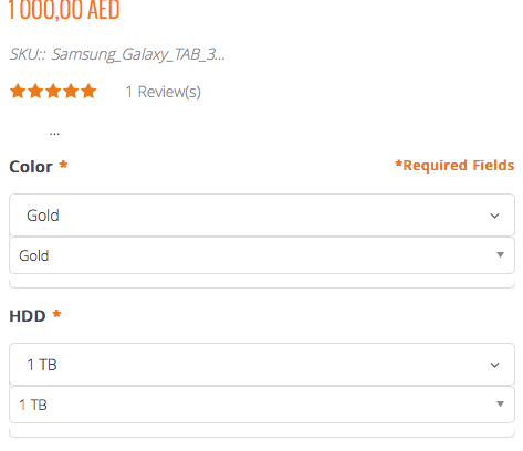

1. For some reason the variants come out duplicated. It gives double options.
Ive attached a screenshot.

1. It's not duplication ; it is a javascript library which replace the display of the dropdowns but it looks like there is a little issue in the hiding of the original dropdown.
2. There is an option in HikaShop to display or hide the "product code".
3. For HikaShop ; we do not have special recommendation.
