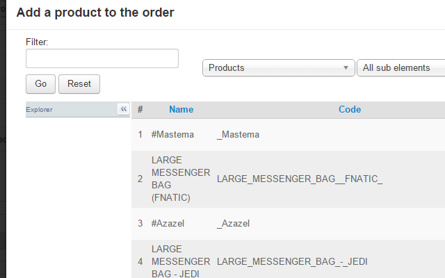

We found that the userpoint plugin is not working for order created directly in backend, frontend point is working perfectly for both AUP and HK
And also backend order category explorer is not showing at all, we have to filter out the product and variants name from filter to enter order in backend

1. I don't see any issue. The points are properly given to the customer when the order is confirmed from the backend, regardless of whether it was first created from the backend or the frontend. And I can confirm that in the code of the user points system that I checked.
So maybe it's something to do with the way you created the order ? For example, if you don't assign a customer to the order, or if you do it after you confirmed the order, or if you add the products after you already confirmed the order. In all these cases, the points won't be added to the customer.
Maybe you could provide a precise step by step of what you do in the backend so that we could try to reproduce the issue?
2. Again the category explorer displays fine in the product selection popup of orders. Did you maybe turned it off in the Display settings of the HikaShop configuration ?

I had check backend configuration of categories explorer and sure it is turn on
however, my case is that the explorer shown, but there are no categories show, even root is missing
attached screen shot for your reference

For the explorer, it looks like an issue with the category tree in the database. Go in the Products>Categories menu and click on the "rebuild" button there and that will reconstruct the category tree, hopefully fixing the problem.

Thanks nicolas, the rebuild fix the problem
