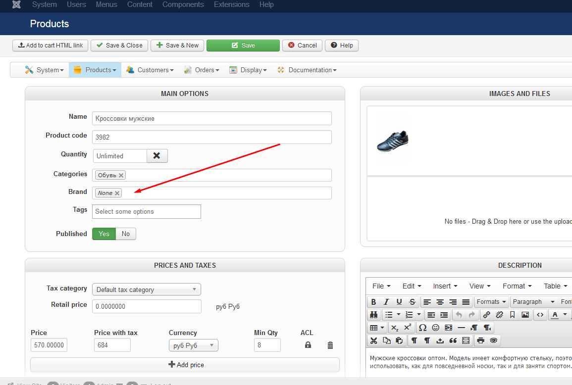

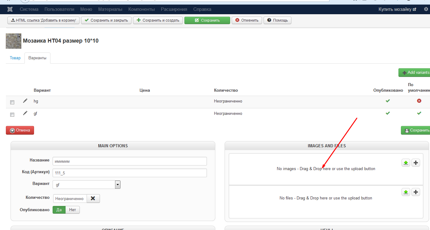

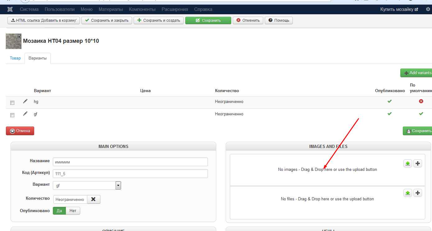

-- Joomla version -- : 3.4.1
Does not save and does not add image in the characteristics
  • Posts: 86216
  • Thank you received: 14222
11 years 3 months ago #204252
Thank you for your feedback. We've added a fix for that on our end. Please download again the install package on our website and install it on yours and that will fix the problem.
  • Posts: 101

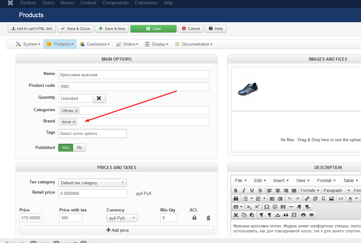

11 years 3 months ago #204309
Does not save brand
Last edit: 11 years 3 months ago by permsk.
11 years 3 months ago #204348
Please edit the file "administrator/components/com_hikashop/classes/product.php" and in the function "backSaveForm()" replace:
if(!hikashop_acl('product/edit/manufacturer')) { unset($product->product_manufacturer_id); }
By:
		if(!hikashop_acl('product/edit/manufacturer')) { unset($product->product_manufacturer_id); }else{
			if(!is_numeric($product->product_manufacturer_id)){
				$this->db->setQuery('SELECT category_id FROM '.hikashop_table('category').' WHERE category_name = '.$this->db->quote($product->product_manufacturer_id));
				$result = $this->db->loadResult();
				$product->product_manufacturer_id = $result;
The following user(s) said Thank You: permsk
