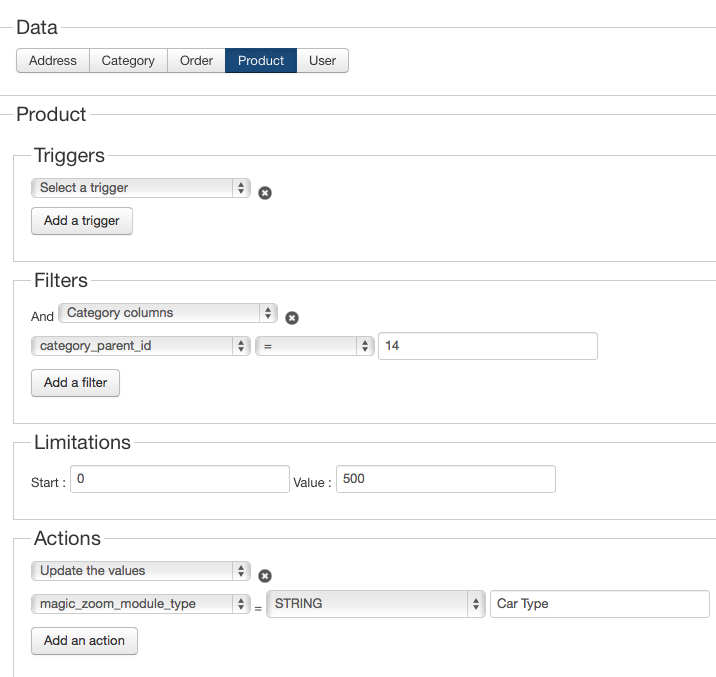

I get this error in mass action:
An error has occurred.
1064 You have an error in your SQL syntax; check the manual that corresponds to your MySQL server version for the right syntax to use near ') OR product_parent_id IN ()) LIMIT 0, 500' at line 1 SQL=SELECT hk_product.* FROM tpjtx_hikashop_product as hk_product WHERE (product_id IN () OR product_parent_id IN ()) LIMIT 0, 500
This is when I filter products with category_parent_id = 14. If the value is 13 there is no problem.
I checked both categories exist and products for both categories have the Target field for which I am changing the value in action section.

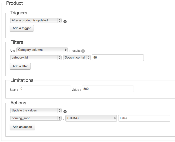

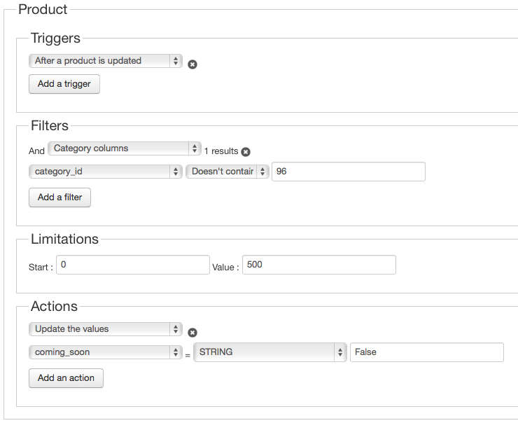

after the update I'm afraid the system works still unpredictable (to me).
Now no matter what category I put it always counts None or 1 results even I product has tenths of them. Also tried with other operators like "Doesn't contain"...
I simply uploaded your attached package and the installation process was successful.

10 years 10 months ago #216171

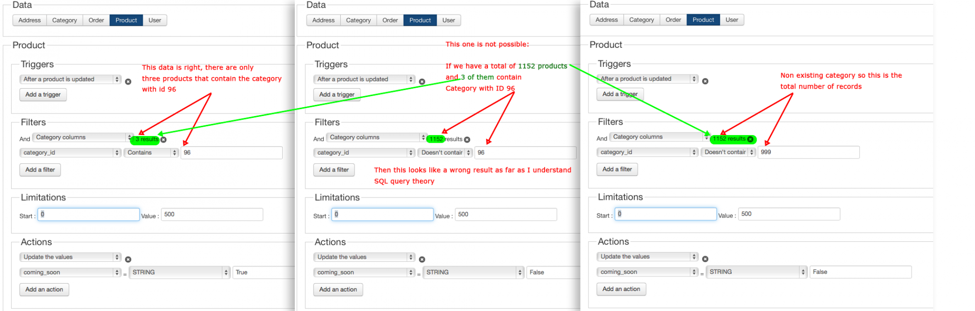

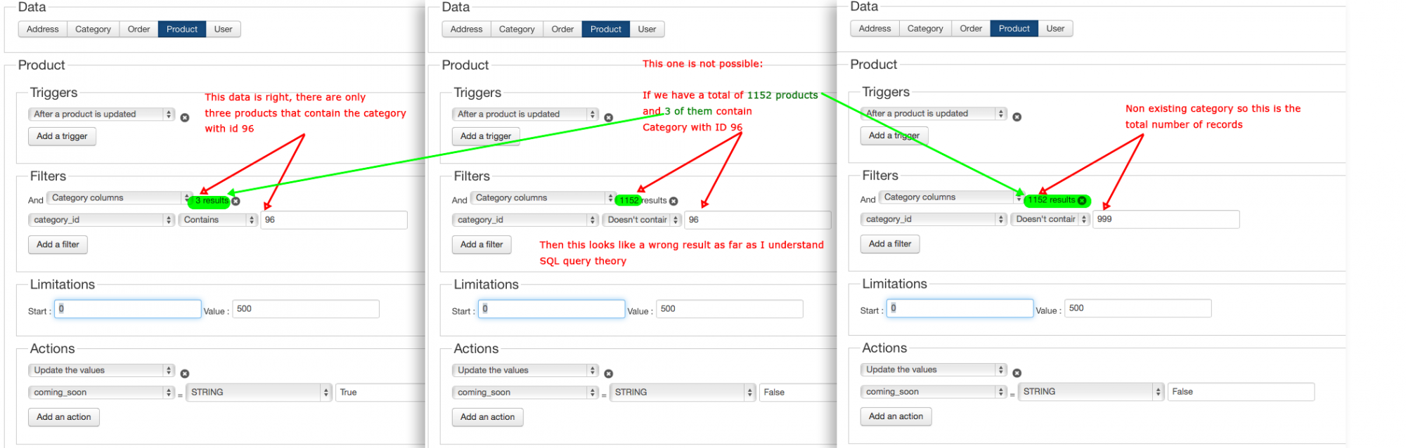

I have some extra data that might be of use for you to determine the problem in mass actions (as long as I think it is a malfunction and not a wrong understanding in my side)
If you want an online version to check please request it and I'll put in a matter of minutes or hours.
