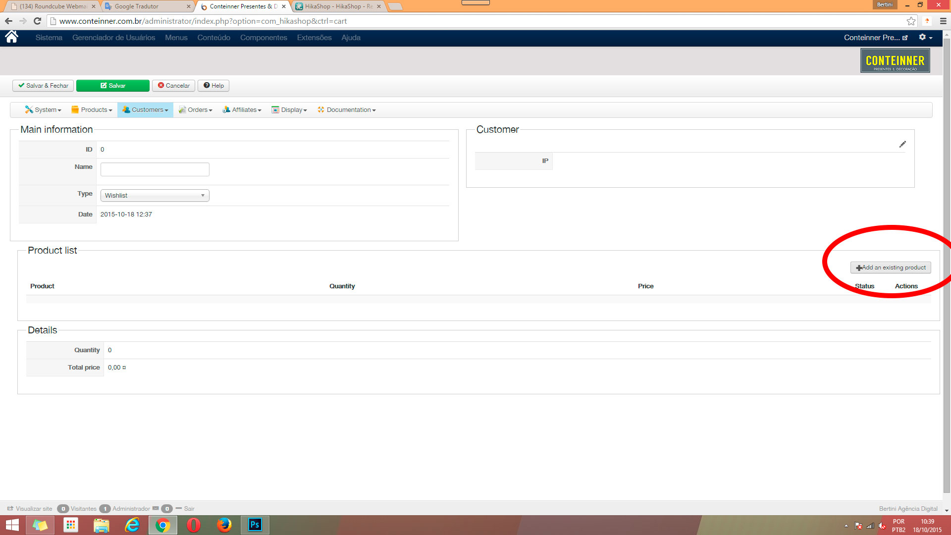

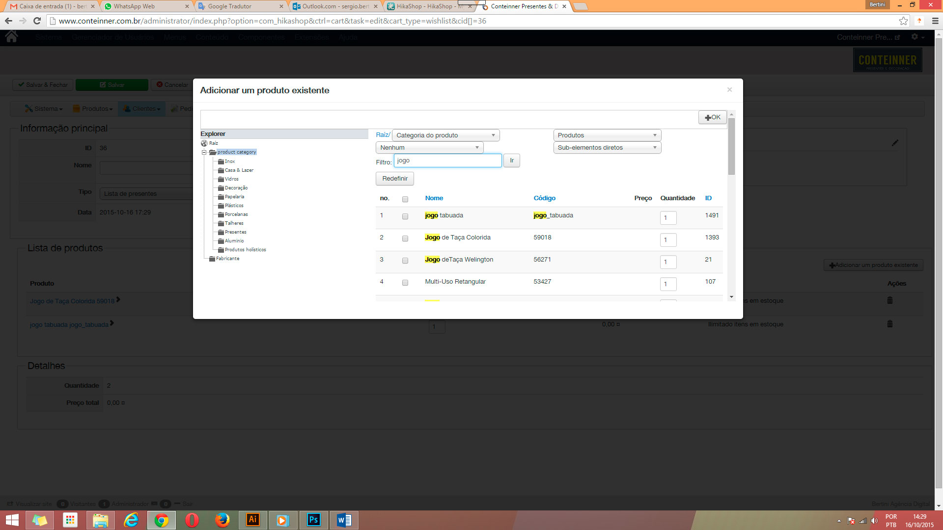

I have a critical problem in the administration of the wishlist.

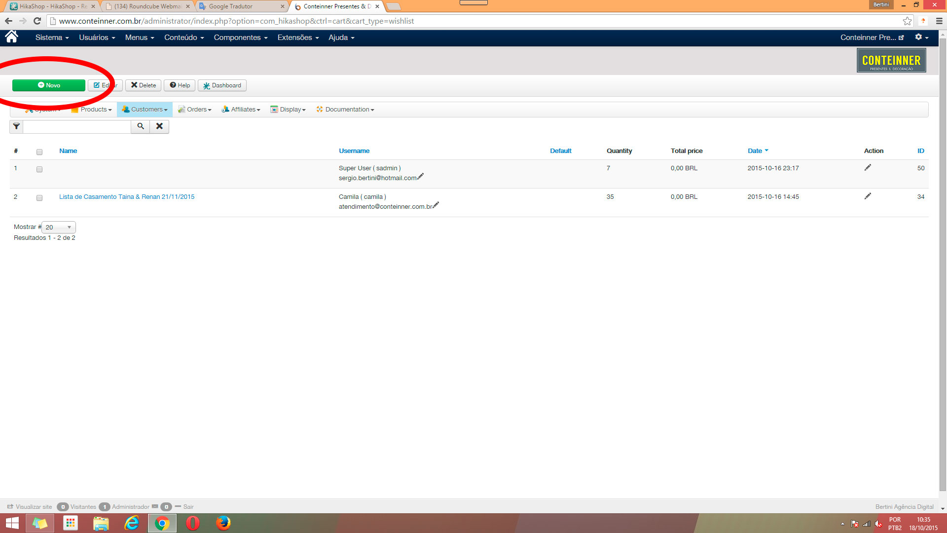

I Access Components> Hikashop. On the next screen, I go: Clients> Wishlist.
Well, on registration of a new wishlist is where the problem occurs.
Eu clico em: "Adicionar um produto existente". Search the product, select and insert. By repeating the process to insert another product from the list, it automatically deletes the first product that I inserted!
The system is excluding registered products before, every new search for product!
That's wrong!
It is wise to search I insert a product, do the search again and he added the new product!
Please help me!!!

You screenshot shows the popup of the wishlist edition in the HikaShop backend ; but I don't understand the process you're doing, so I don't understand your issue.
  • Posts: 128
10 years 11 months ago #217630
OK!
I will do step by step:
1) The administration> hikashop> Customer> wishlist. I click in new.
2) Then I click on "+ Add on existing product"

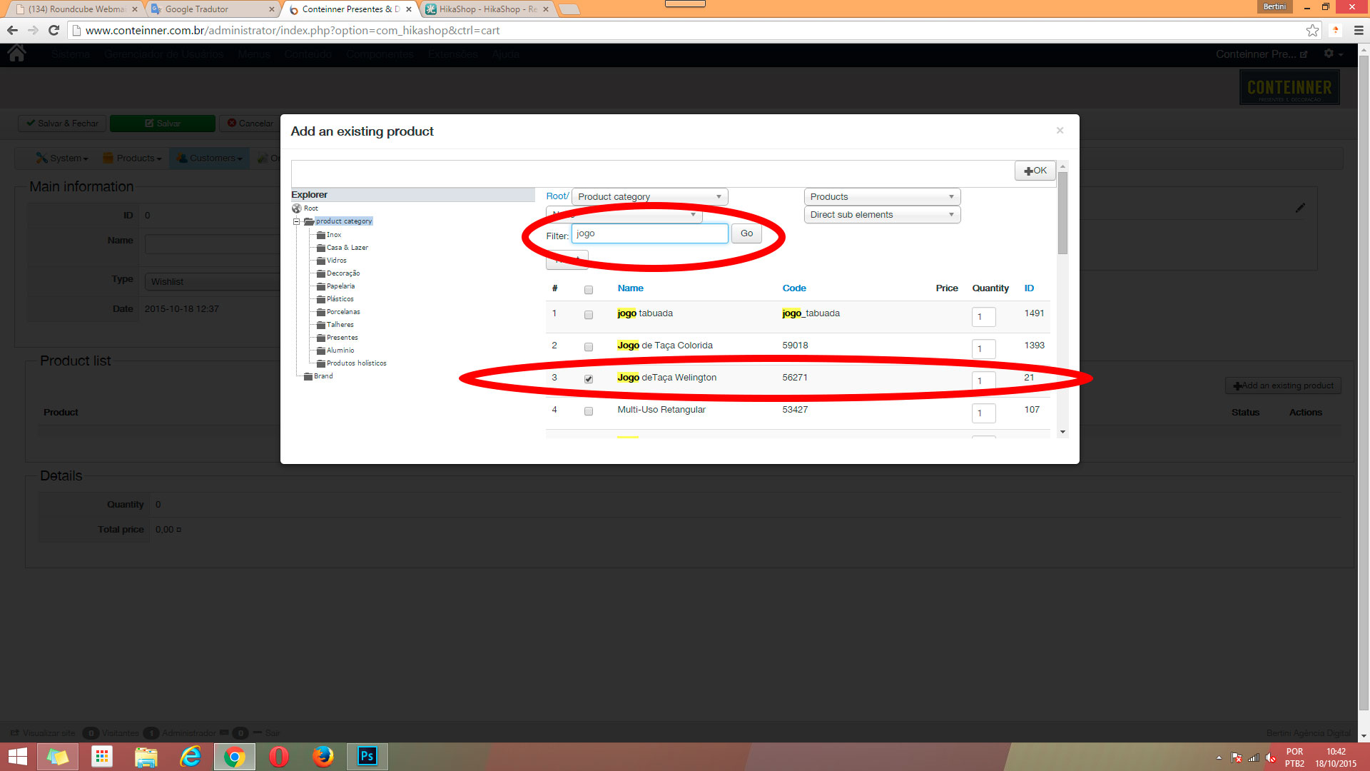

3) In the pop up that opens, first I do the search for a product.To find the product, I select the product and then click on the button "+ OK".
The selected product is inserted in my wishlist successfully!

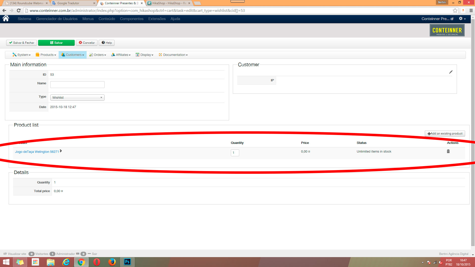

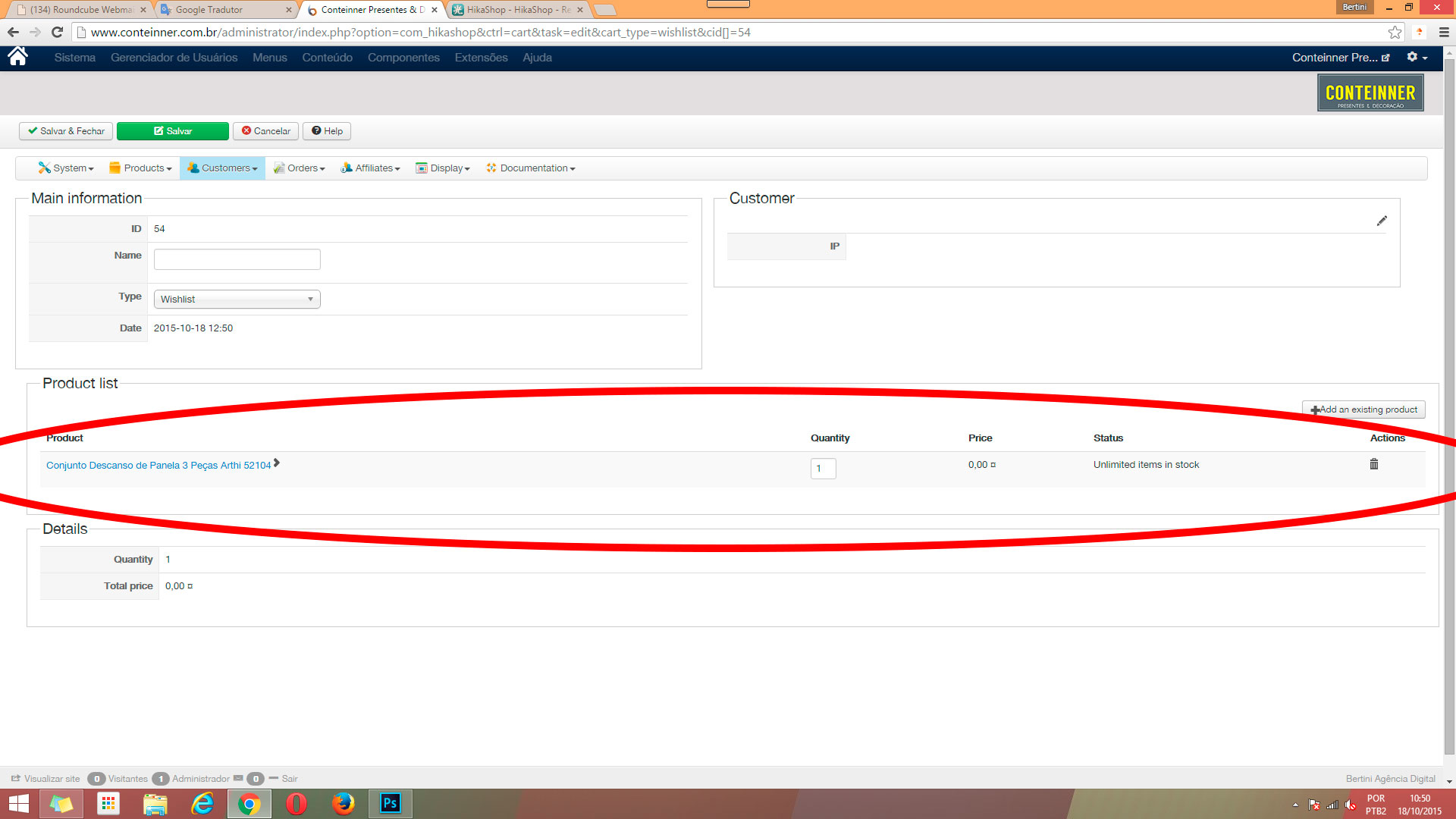

4) Now is the time where the problem happens!
When I will repeat exactly the same process, the hikashop deletes the item previously added.
The hikashop should include the new product without deleting the previous!
THAT WOULD BE THE RIGHT, BUT NOT WHAT HAPPENS!
REMINDER:
This only happens when using the search!
Please! help me urgent!!!

10 years 11 months ago #217851
Please edit the view "order / product_select" in the backend template and replace all the content by this code:

And edit the file "administrator/components/com_hikashop/controllers/order.php" (via ftp) and replace the function "product_select()" by:
	function product_select(){
		JRequest::setVar( 'layout', 'product_select'  );
		$cart_type = JRequest::getString('cart_type','cart');
		$cart_id = JRequest::getInt($cart_type.'_id','0');
		if($cart_id == '0')
			$cart_id = JRequest::getInt('cart_id','0');
		JRequest::setVar('cart_type',$cart_type);
		JRequest::setVar($cart_type.'_id',$cart_id);
		return parent::display();

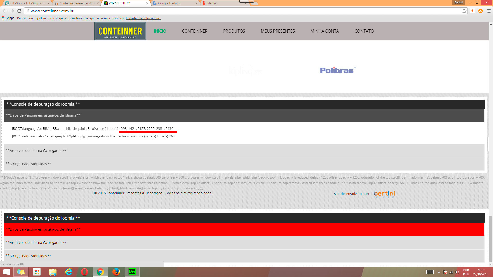

10 years 10 months ago #218584
Please enable the language debug in the Joomla settings, this will give more details on this issue.
If there is broken strings or other things like that, this will be shown directly.

10 years 10 months ago #218607
Joomla > System > Global configuration > System > Debug Language

I corrected the lines mentioned in the debug joomla. But the error remains!
  • Posts: 86217
  • Thank you received: 14222
10 years 10 months ago #218661
If the Joomla debug says that you still have the errors in that file, it means that you still have the errors in that file.
Maybe you didn't upload it back properly or something after editing it ?
Now not knowing what you have in your translation file, I can only recommend to revert to the default version of the file available on our end www.hikashop.com/download/languages.html or to provide your modified translation file so that we can check it.

We've checked the pt-BR language file on our end on these lines but we couldn't find any problem.

10 years 10 months ago #219064
Are you sure that you using the file from our website and you did not modify it ?
Because I just download the file and for the line "1098", the content is
;since version 1.4.5
and line "1421" is
SELECT_DATE_IN_FUTURE="Favor selecionar uma data no futuro"
So I don't think that you're using the file that we propose in our website. Or you have modified it during some kind of process.
But our language file, the one which can be download from our website is working good ; like Nicolas explained you in the previous message.

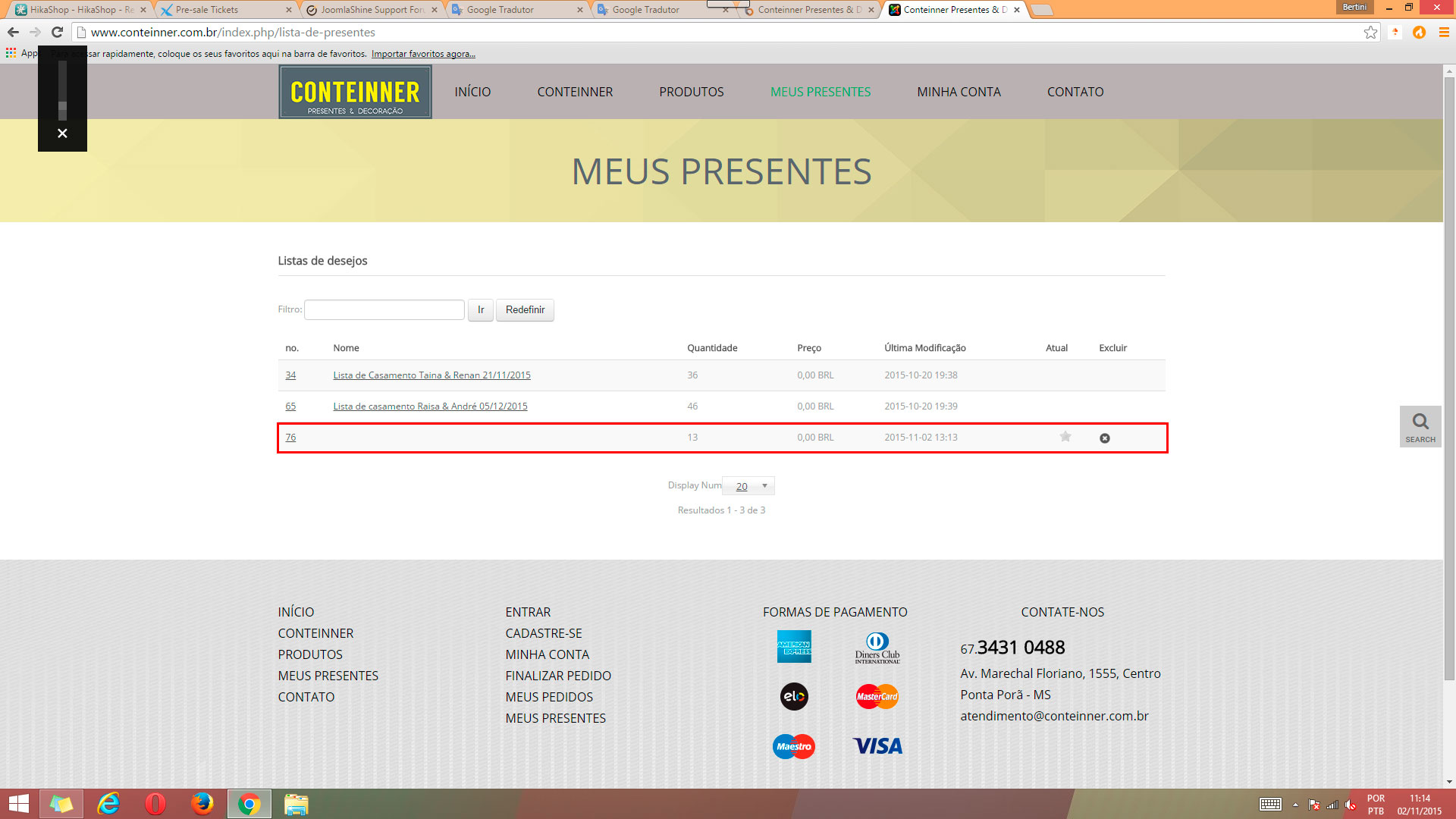

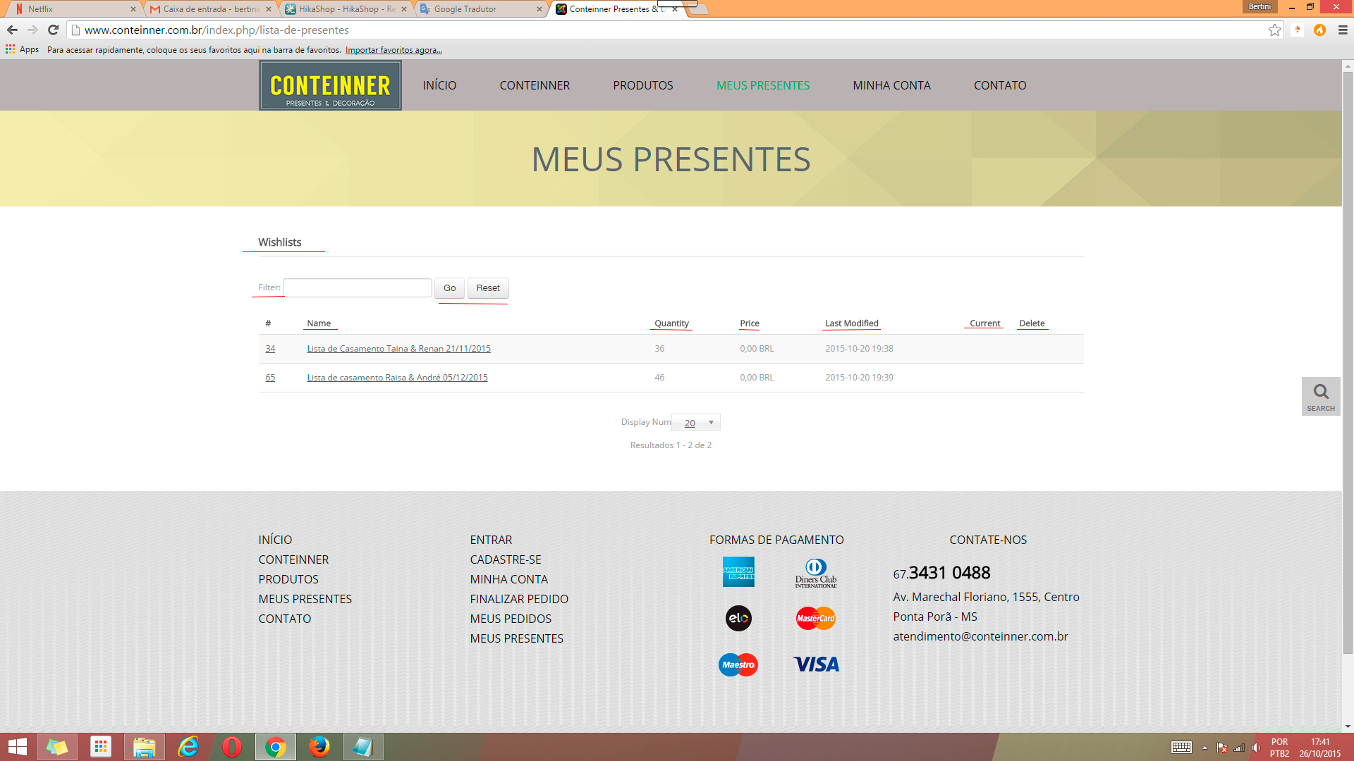

Another problem appears:
In wishlist, when we enter the name and then save. The name is deleted!
All the lists that we created in the administration and in website, insert the name, but when we save the hikashop not saved the name.
Help me!
Last edit: 10 years 10 months ago by sergiobertini.
  • Posts: 86217
10 years 10 months ago #219181
1. Some elements are new and no one translated them yet. You can do that in the language file and then click on the "share" button of the translation file edition popup in order to send over your translations so that we can add them on our end.
2. When is this issue happening ? When saving the name on frontend, in backend or both ?
Do you have a view override on the view "cart / showcart" ? If it is, please backup it and delete the override.
Are you trying to set a name when logged in or logged out ?
Last edit: 10 years 10 months ago by Xavier.
