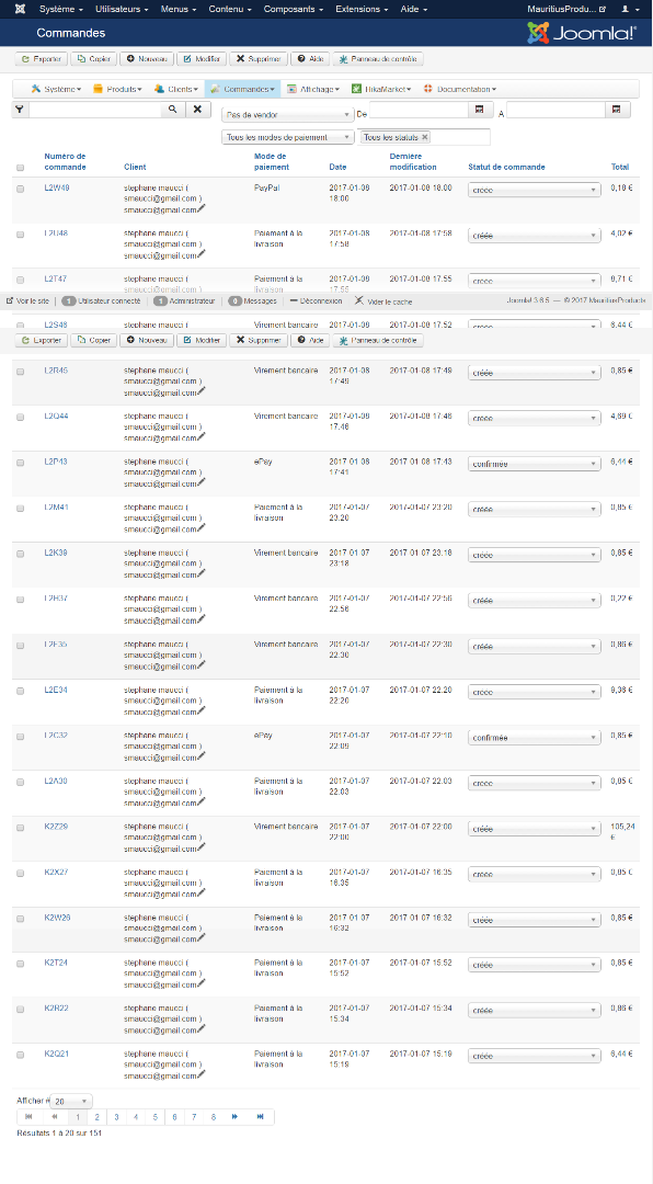

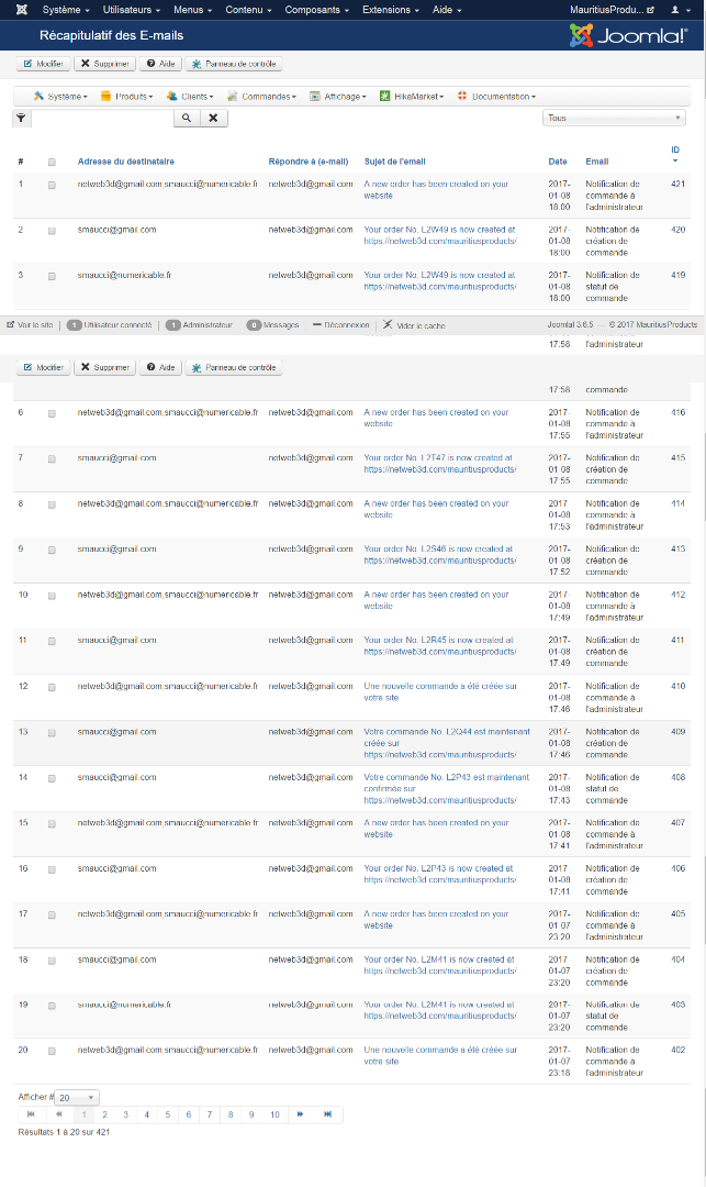

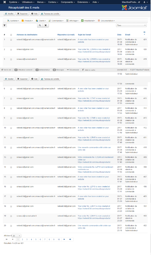

9 years 7 months ago #259095

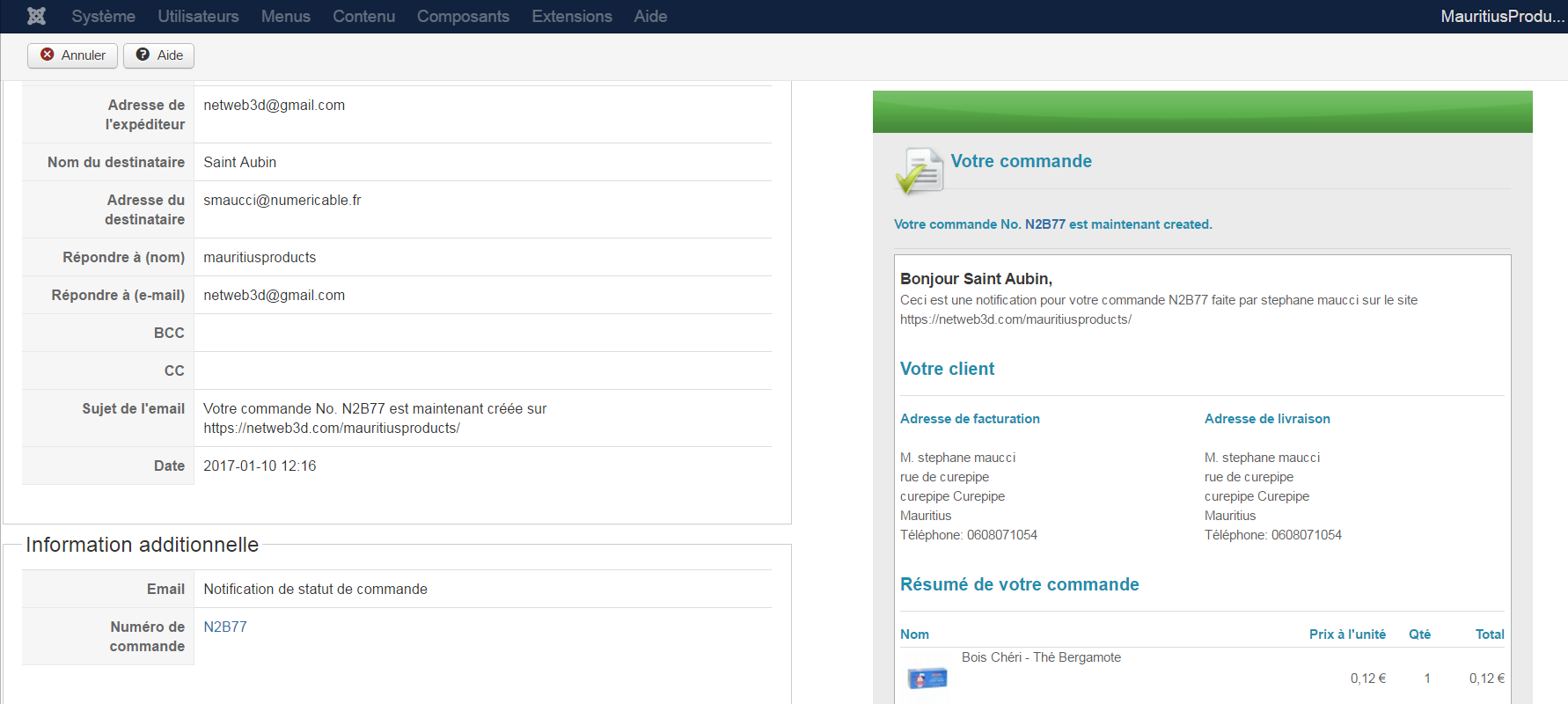

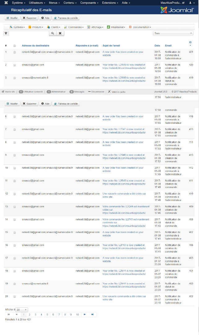

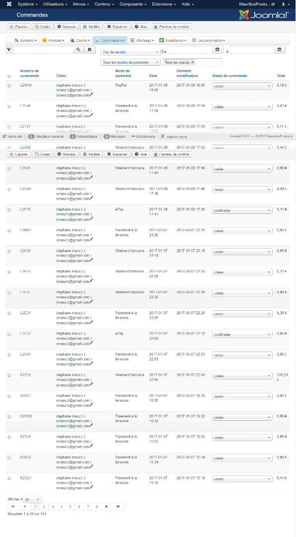

I have a similar problem but with a multi language site.
The issue is that I receive all emails perfectly in french but not in english.
I tested with some payment methods in english, like paypal, epay, bank transfert, collect on delivery, and sometimes I get the "could not instantiate mail fonction" warning.
The commands and the emails are well created in HIkASHOP (see attached files).
What is the problem ?
Here is the site link : netweb3d.com/mauritiusproducts/en/catego...ory/25-tea-mauritius
Best regards.
  • Posts: 86081
  • Thank you received: 14189
9 years 7 months ago #259112
Hard to say. On HikaShop's end, it only transmit the email to the email server and displays the error sent back by the email server if any. The "Could not instantiate mail function" message is a generic error message which only tells that there was a problem but not what was the problem. So it could be anything.
You should check the error log of your email server. There, you should see more information on why the emails cannot be sent.
You might need to ask about that to your hosting company if you're using their email server.

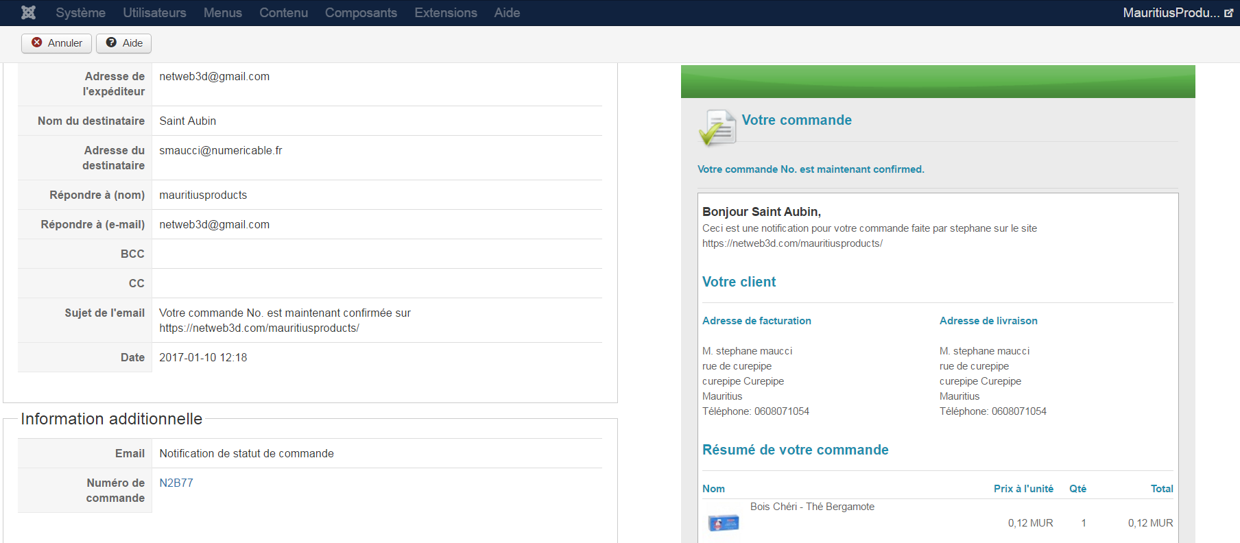

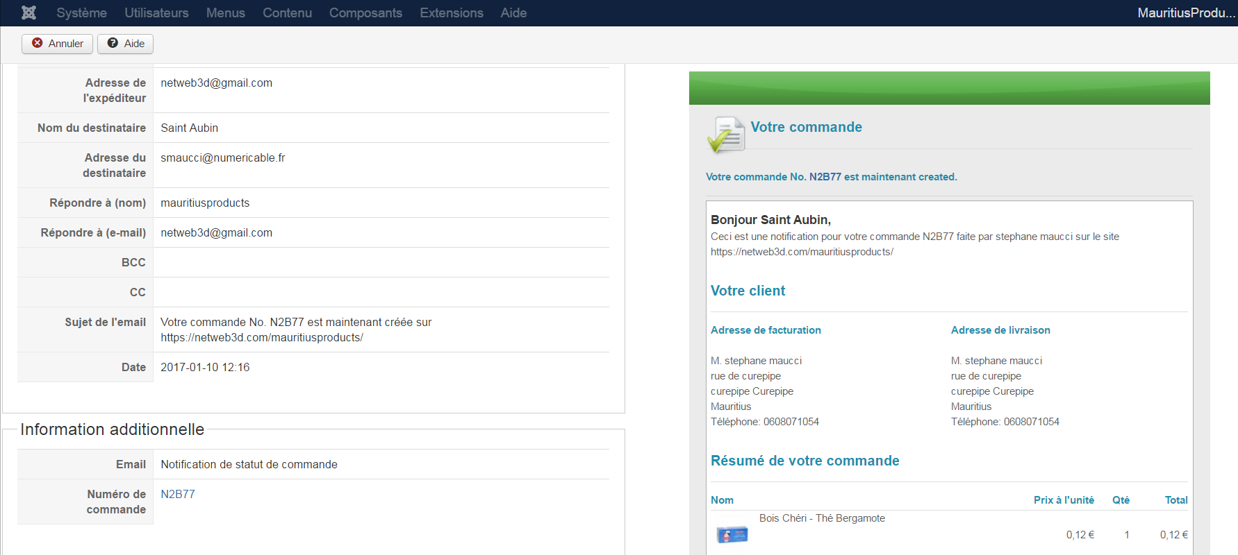

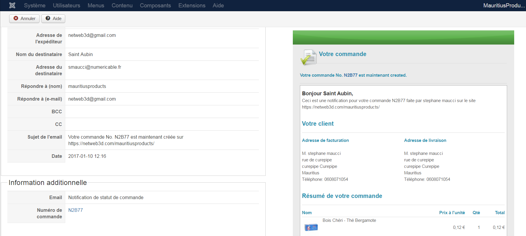

  • Posts: 96
9 years 7 months ago #259367

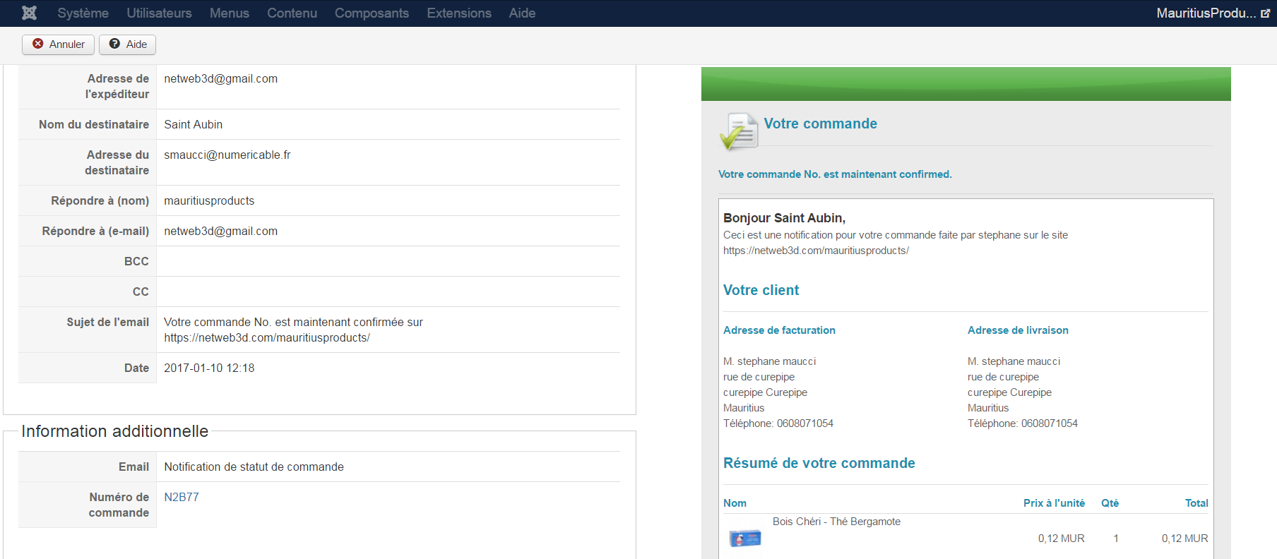

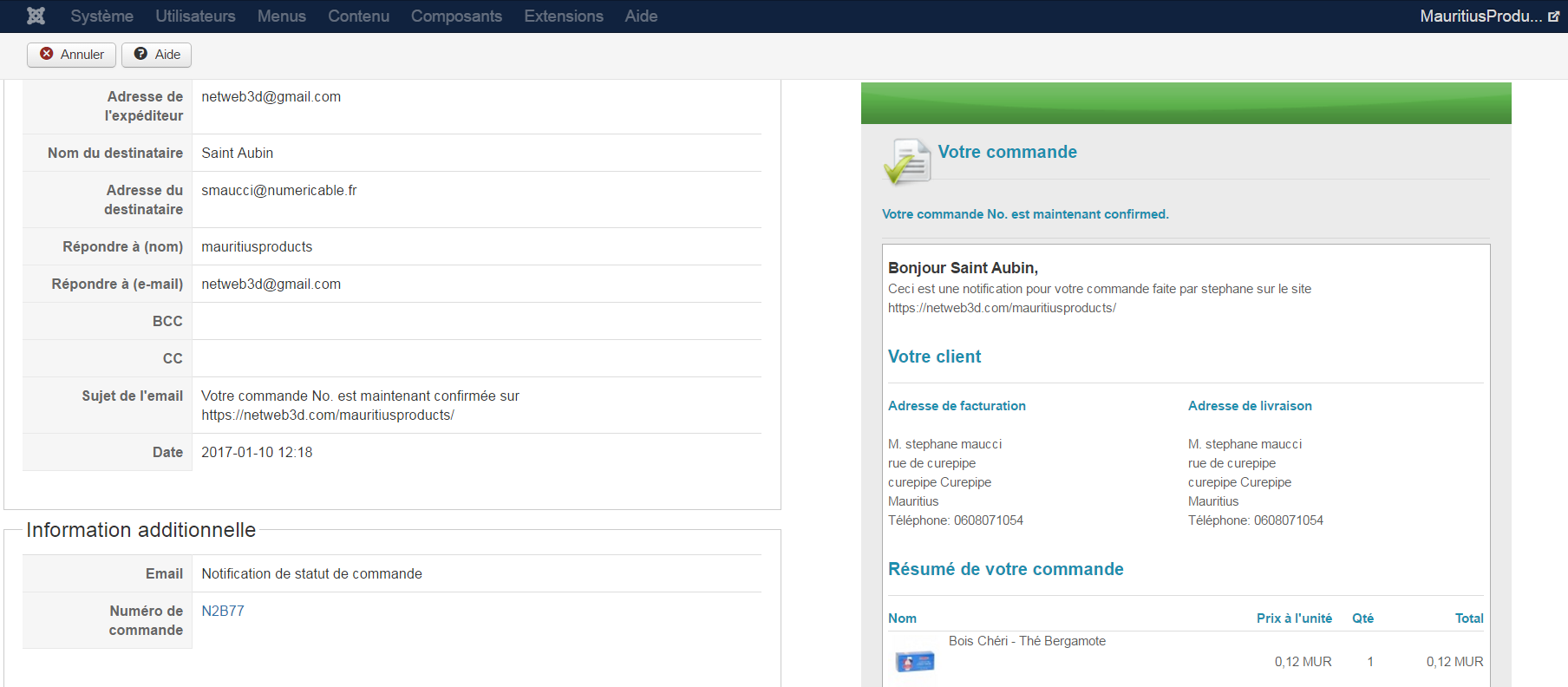

I asked to my hosting company and it was a problem about DKIM key.
And about the notification emails, I have a strange issue with the emails send towards vendor : a mix of french and english words, and order number not displayed (see attached files).
How can it be fixed ?
Thank's
