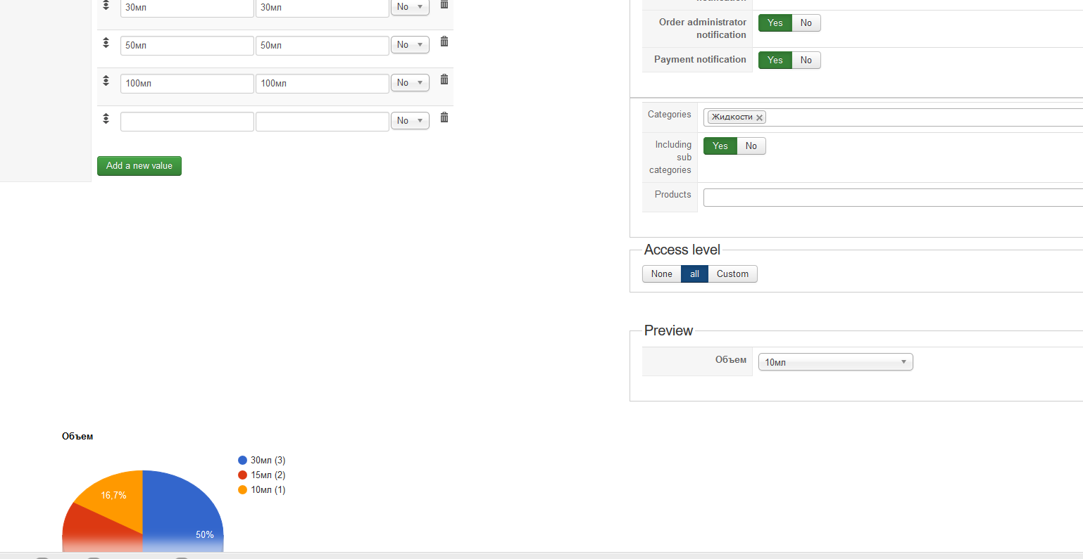

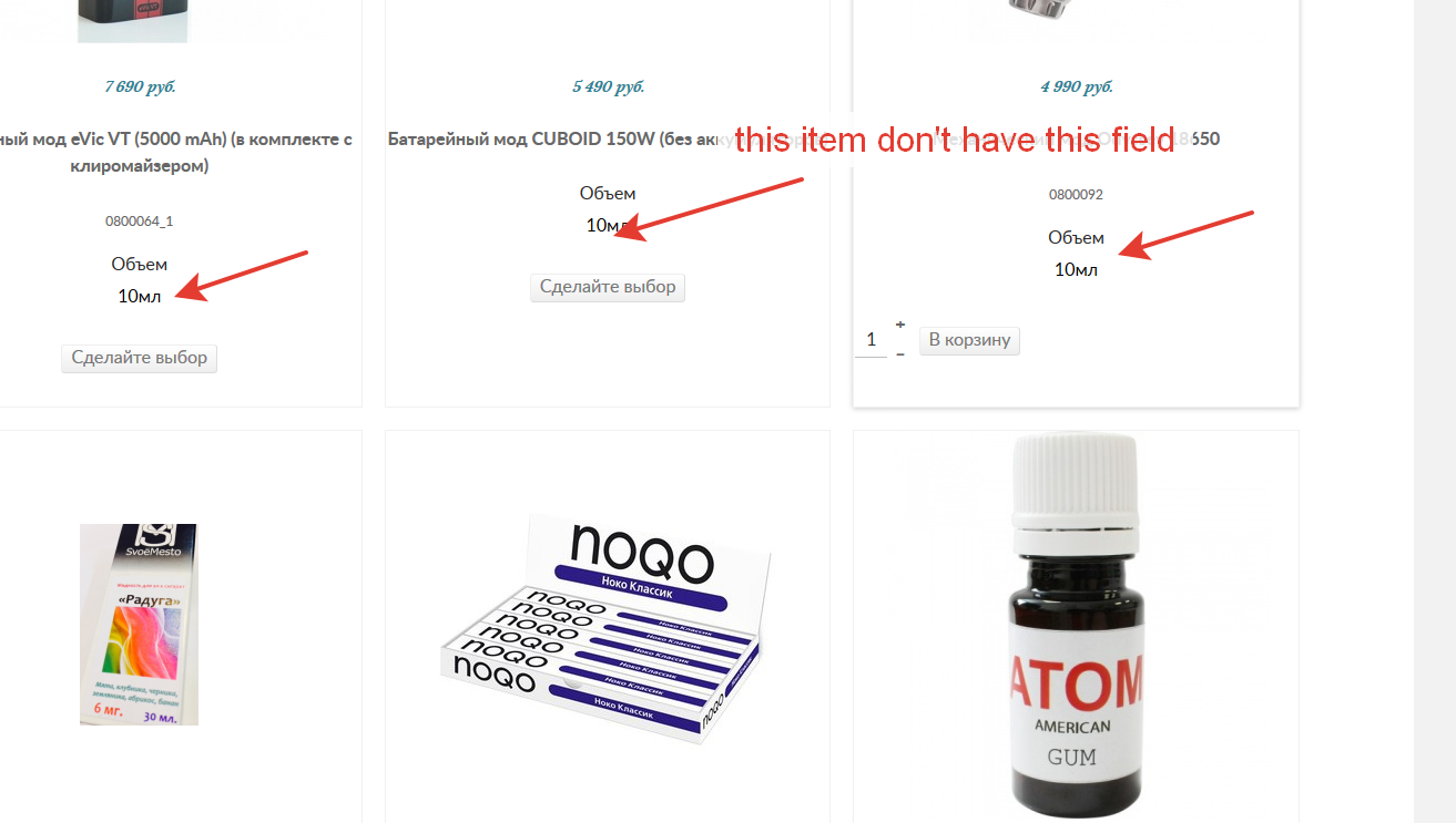

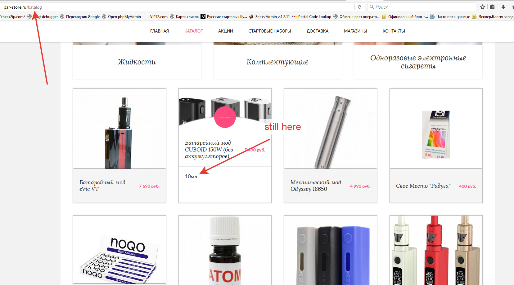

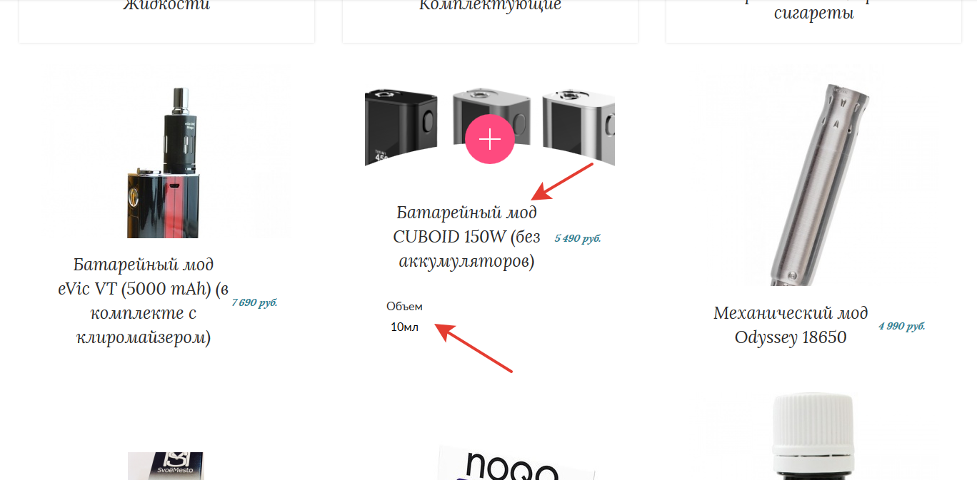

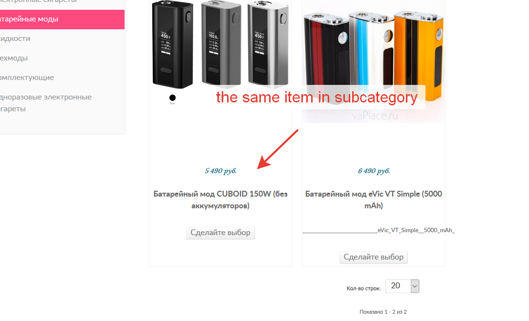

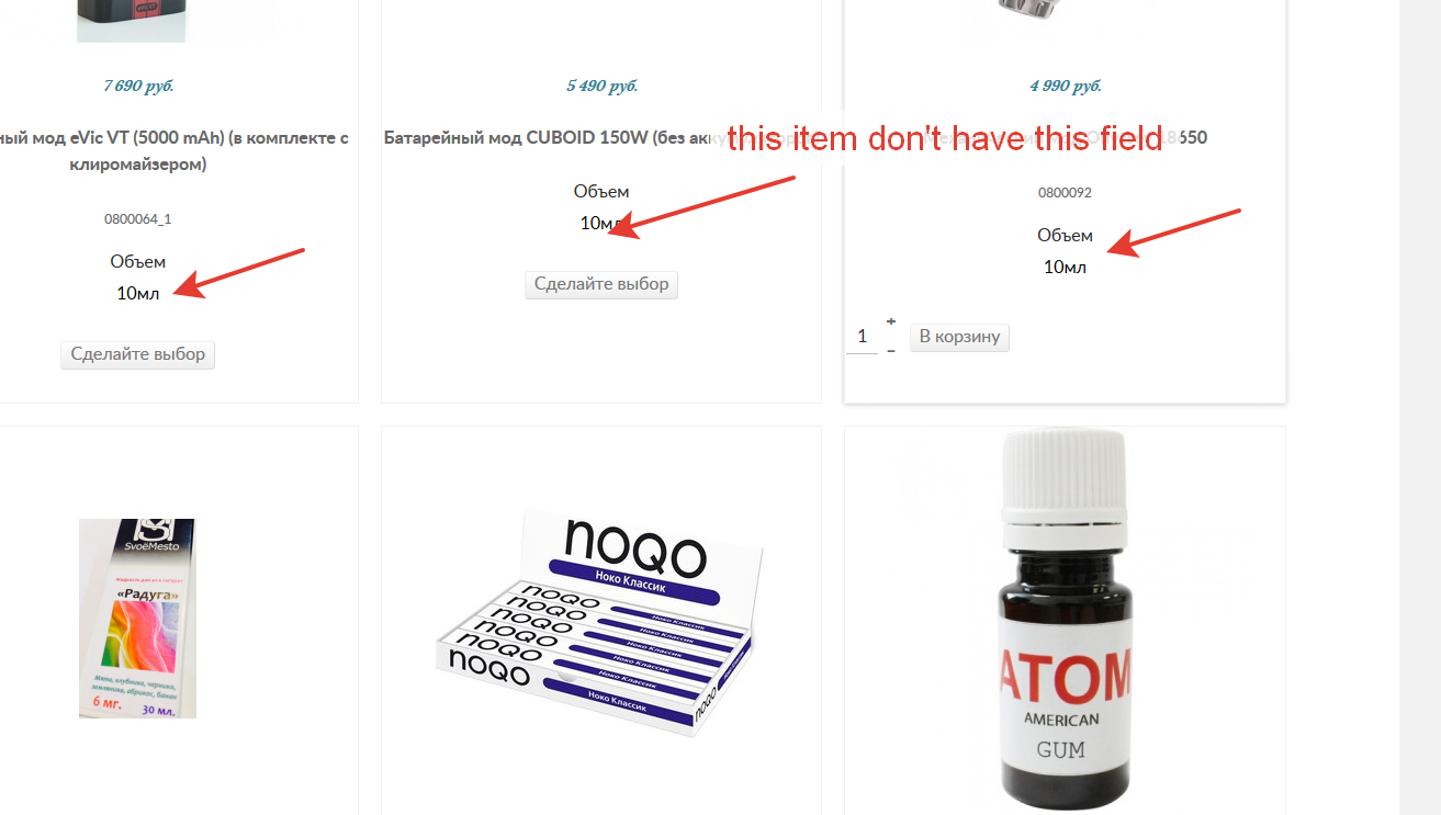

If I have custom field with dropdown values, this custom field appears on every item in the category "product category" listing.
If I go to the subcategory - this custom field disappeared (works ok) and appeared only for items that have it.
I have restrictions for that custom field - it must appears only in certain categories...

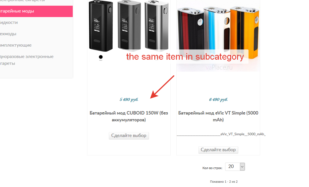

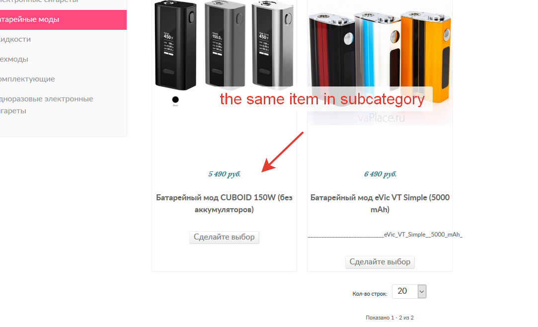

And here is the same item in subcategory:

9 years 11 months ago #245199

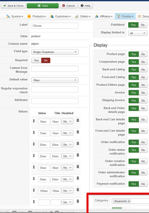

hello,
Can you provide your screenshot back-end custom field configuration ?
Awaiting news from you
Last edit: 9 years 11 months ago by Philip.

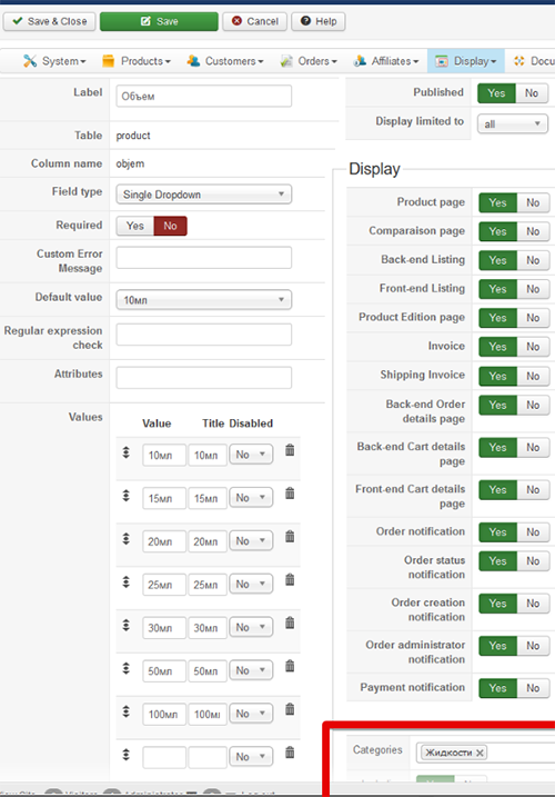

  • Posts: 2293
  • Thank you received: 315

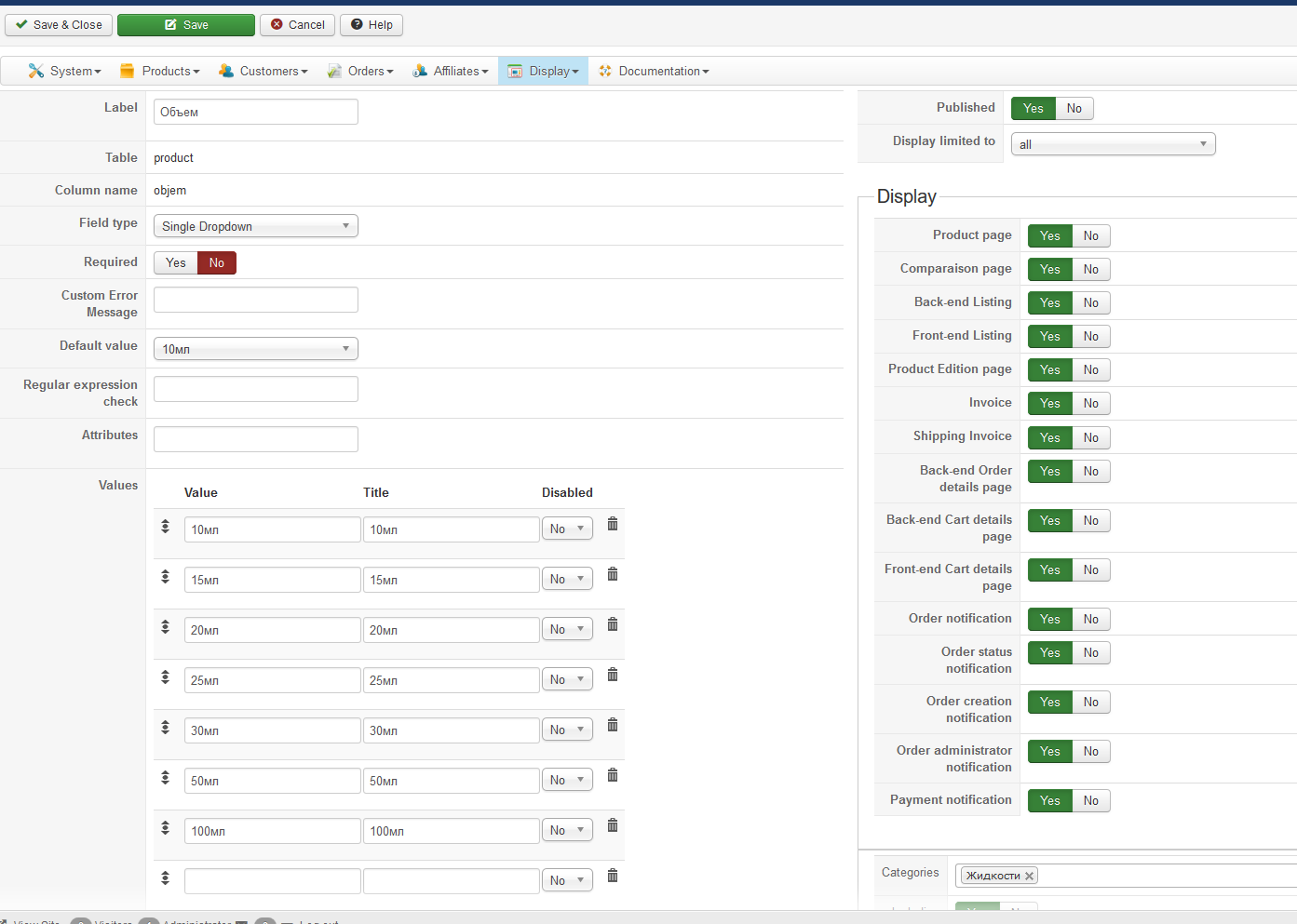

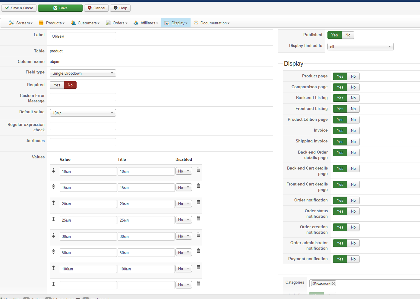

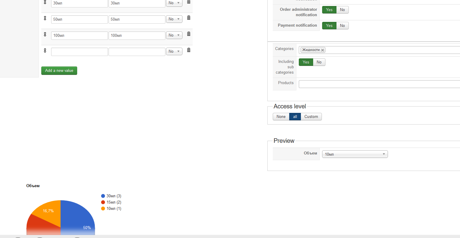

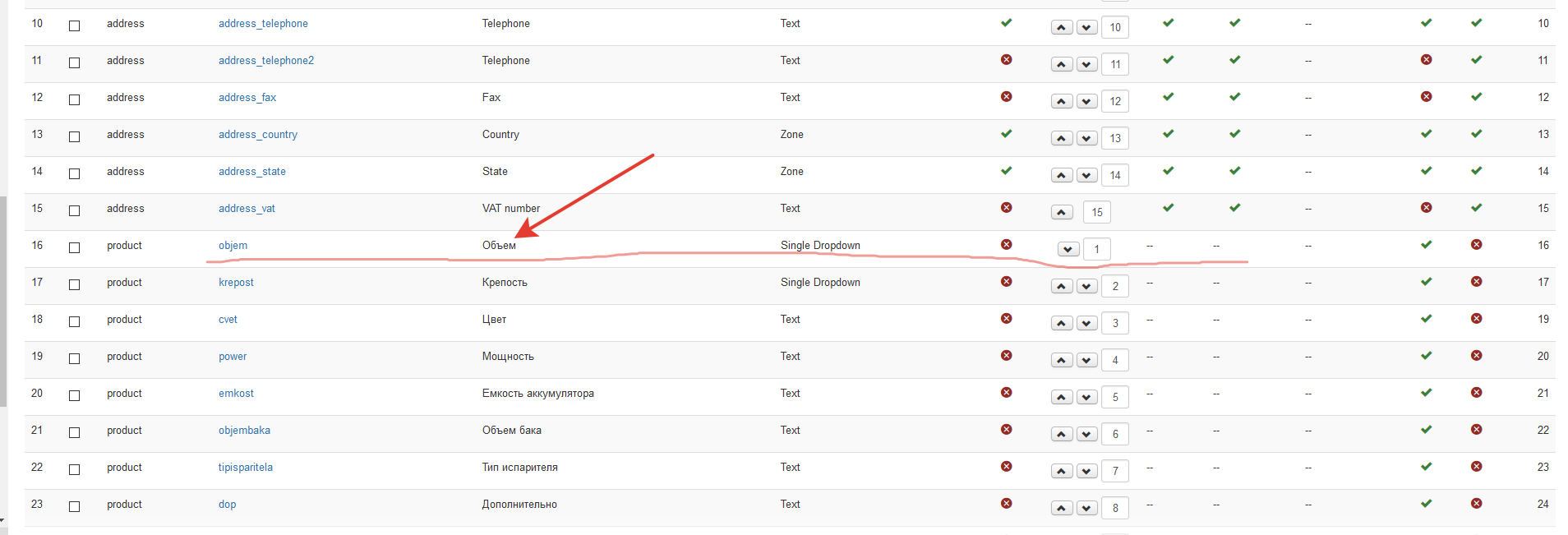

9 years 11 months ago #245263
here is it
Я здесь добровольно!
Last edit: 9 years 11 months ago by progreccor.

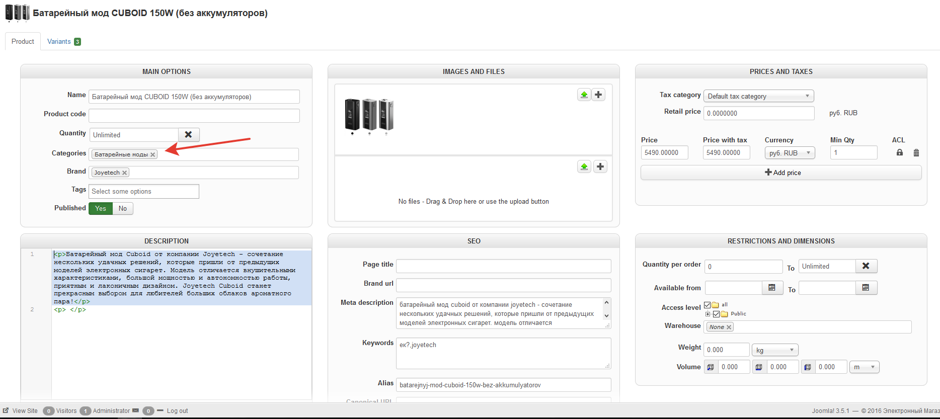

9 years 11 months ago #245310
Unfortunately your custom field configuration screenshot don't show all parameters, I need to see everything and especially this part in red.
But I can already ask you one thing, does your products are really in another category than this one ?
Check in your product configuration page the category of your products with this front end issue please.

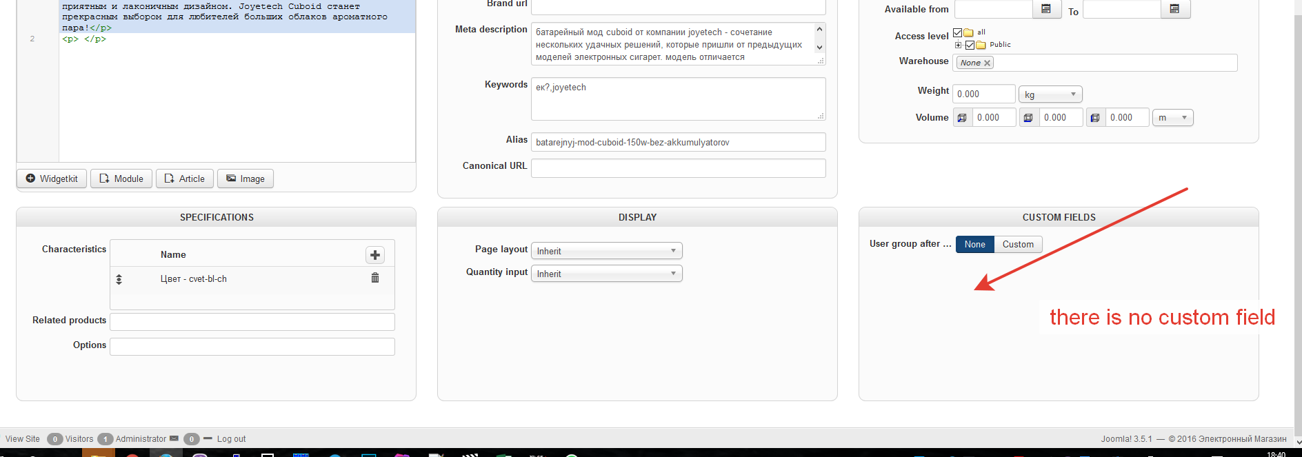

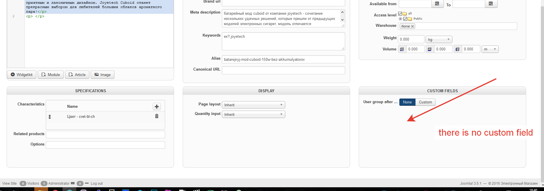

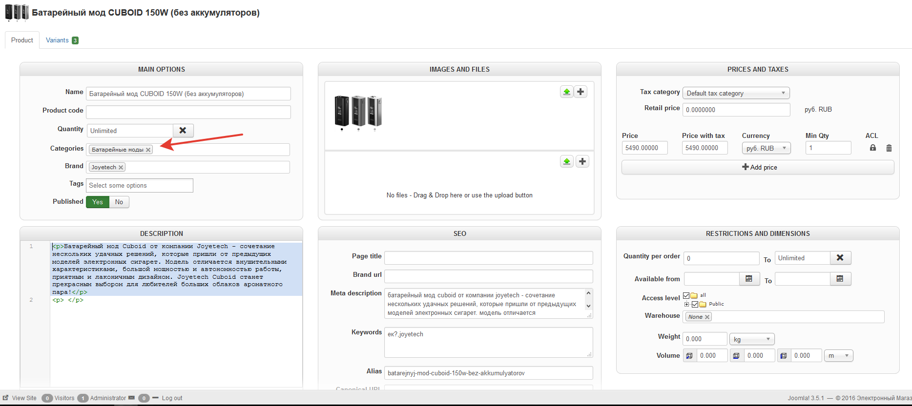

9 years 11 months ago #245323
this is product
and this is the field in the category with this product:

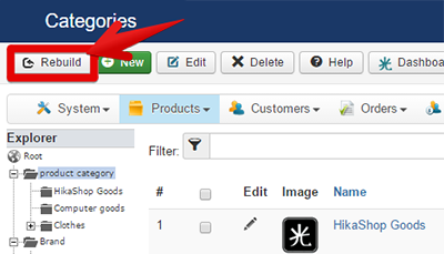

9 years 11 months ago #245531

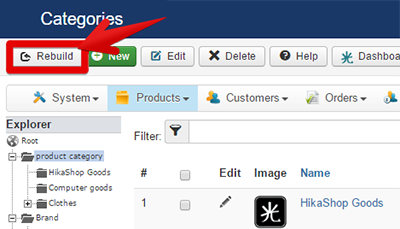

It's not a bug, can you try to rebuild your categories structure by doing this :
- Go to Components => HikaShop => Categories
- Use the HikaShop Rebuild categories function.
Can you check if the issue remains after this, please ?

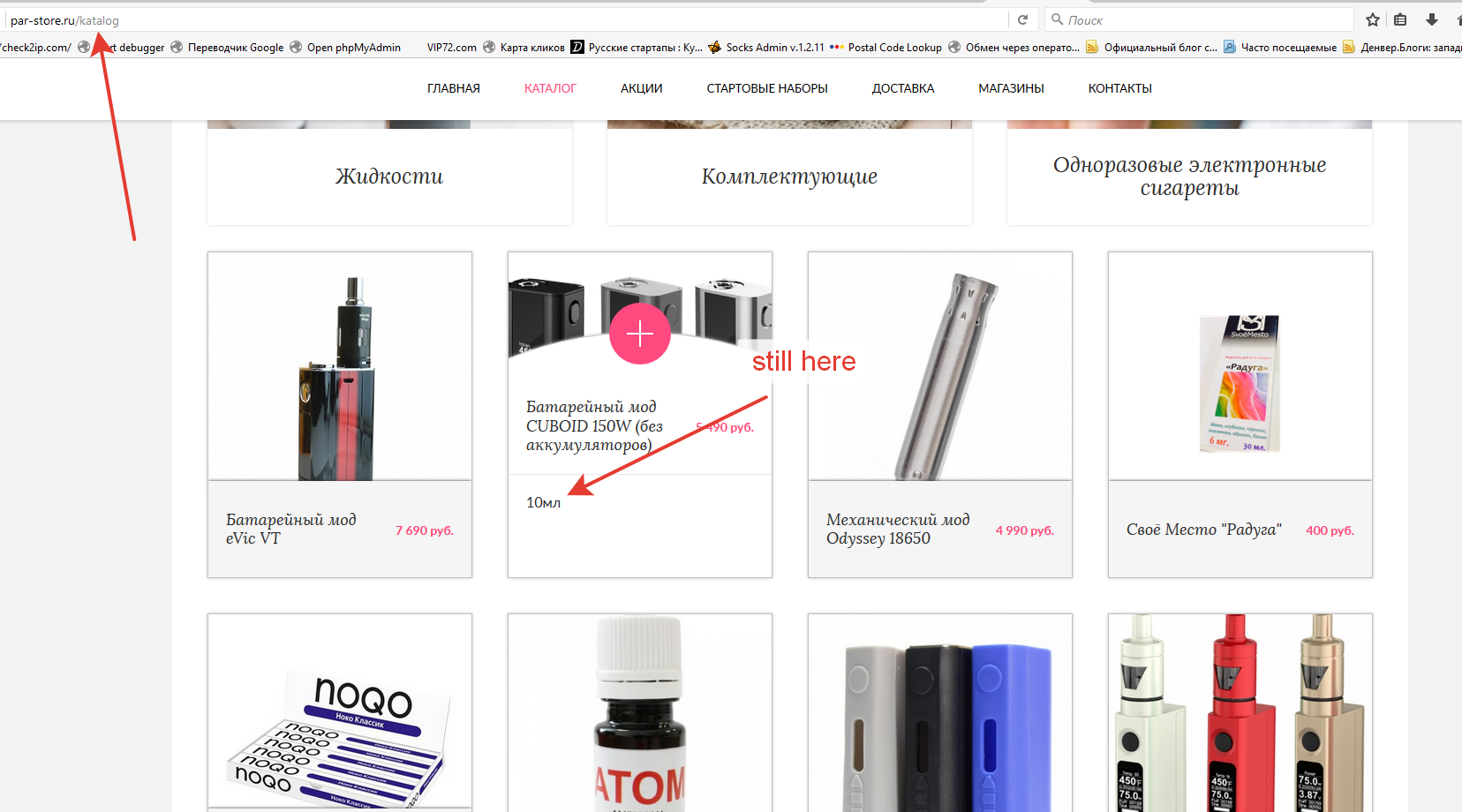

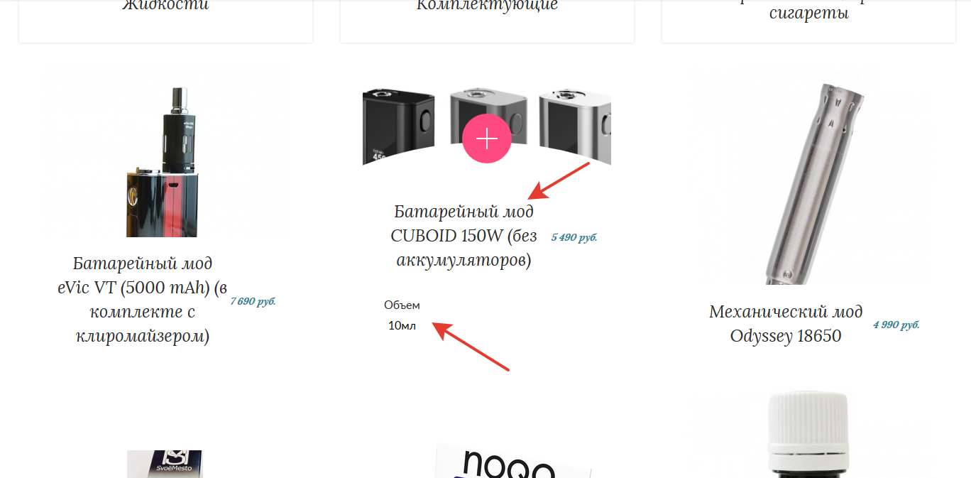

I have updated hika to the latest version
But there is no luck. Fake custom field still here:

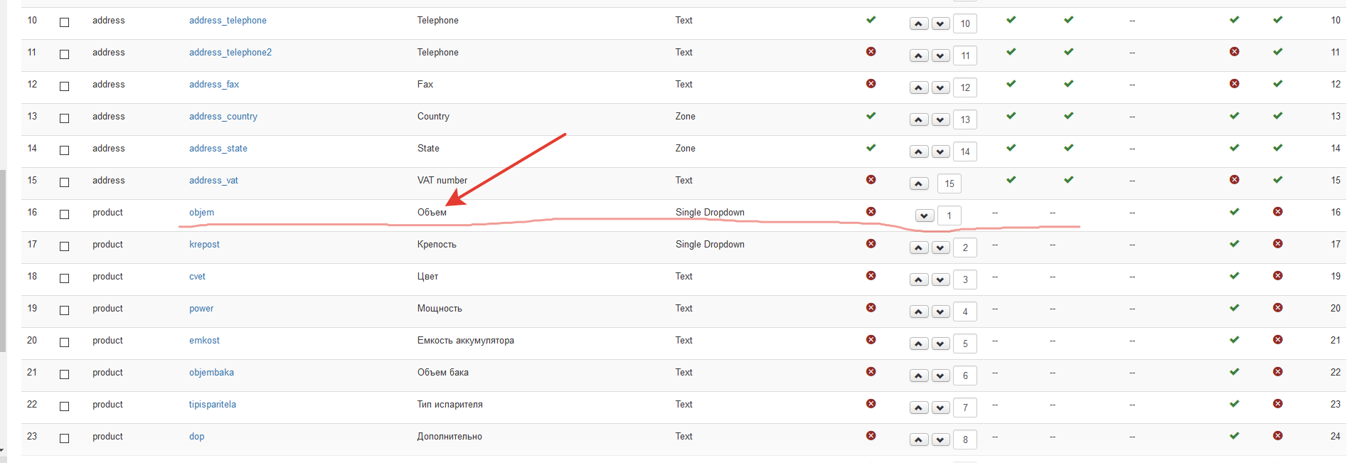

9 years 11 months ago #245716
I had a first look and it's really strange. In the view file listing_img_title, if I do a vardump of $this->row I see something in the variable $this->row->objem for all the products on that listing, but that variable should be empty. When I do a mass action to see if the products have something in that objem column in the database, it is empty. So it's as if something was filling in that variable after the loading of the products on your website.
Do you have some custom plugin which could do that ? Or some modification of the core files which could result in that ?

9 years 11 months ago #245874
After further debugging, I've found the problem and fixed it. It was coming from a combination of changes between the new custom field display options and an improper code modification.
Replacing the line:
if(!empty($d->$namekey) || !empty($data->$id))
with:
if(!empty($d->$namekey) || !empty($d->$id))
in the file administrator/components/com_hikashop/classes/field.php fixed the problem.
