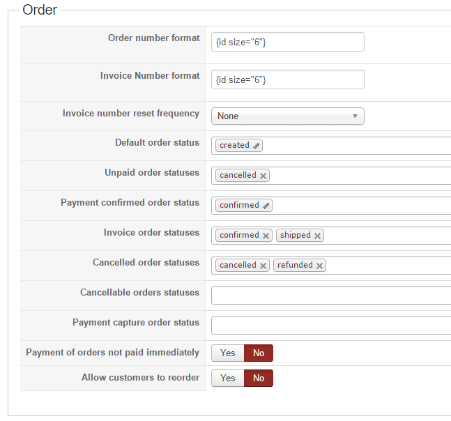

For some reason, the invoice number, starts all over again!
These are my current settings:
Normally the order numbers and invoice numbers were the same, but since a few days it starts all over again from 000001.
And for some reason this is only with the payment method: iDeal , if I use the payment method: Bank Transfer everything works perfectly.
How or where can i change this?

  • Posts: 85860
  • Thank you received: 14101
9 years 11 months ago #245599
I had a look at the plugin's code and it looks fine.
They use the modifyOrder function call to change the status of the order during the payment notification, and at that point, the invoice id/number should be generated.
And it would reset only if:
- you had set a reset frequency for the invoice number (but that doesn't look like it's the case in your screenshot)
- or HikaShop cannot find any previous order with the order_type equal to "sale"
So I don't know what you did 2 weeks ago, but one possibility could be that you changed the order_type of all the previous orders to something else, with a mass action for example.
But in that case, the order number should also be reset for the other payment methods.
So there is something impossible here.
I'm suspecting you're not telling us everything.
