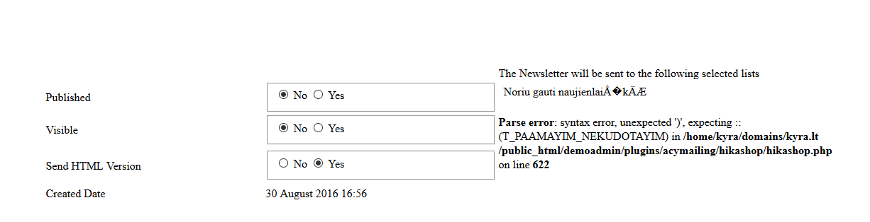

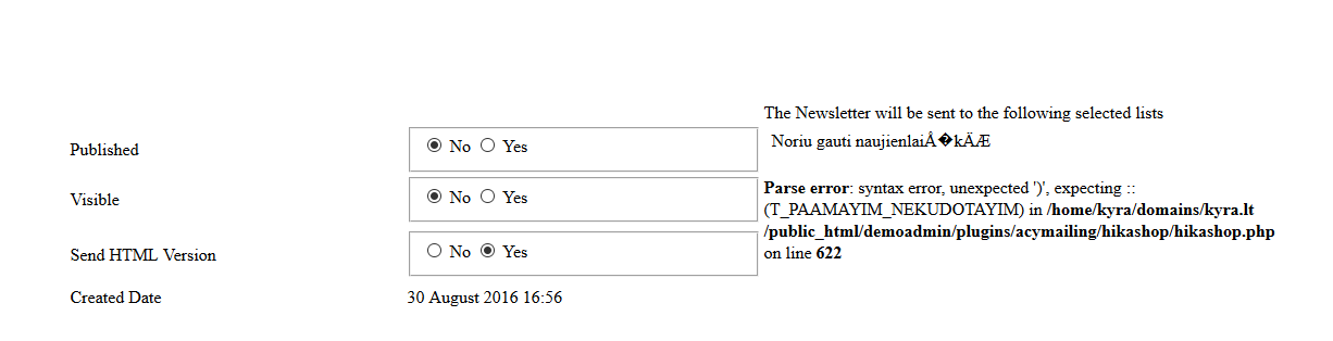

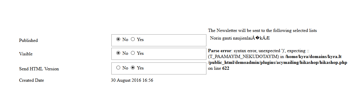

I just updated to latest 2.6.4 version and found error when trying to edit newsletter in acymailing with the following error and blank page:
Parse error: syntax error, unexpected ')', expecting :: (T_PAAMAYIM_NEKUDOTAYIM) in ......................../plugins/acymailing/hikashop/hikashop.php on line 622
However opening file via php tool shows error on line 1243
  • Posts: 86081
  • Thank you received: 14189
9 years 11 months ago #249041
Download again the install package from our website and install it again on your website and that should fix the problem.
  • Posts: 1119
  • Thank you received: 114
9 years 11 months ago #249050

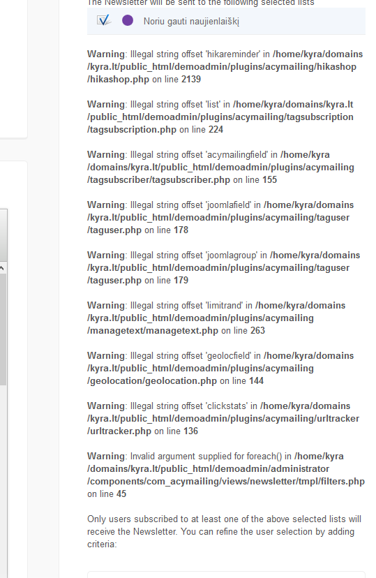

1. Unfortunately it didnt fix the problem. There is still same error. Screenshot attached.

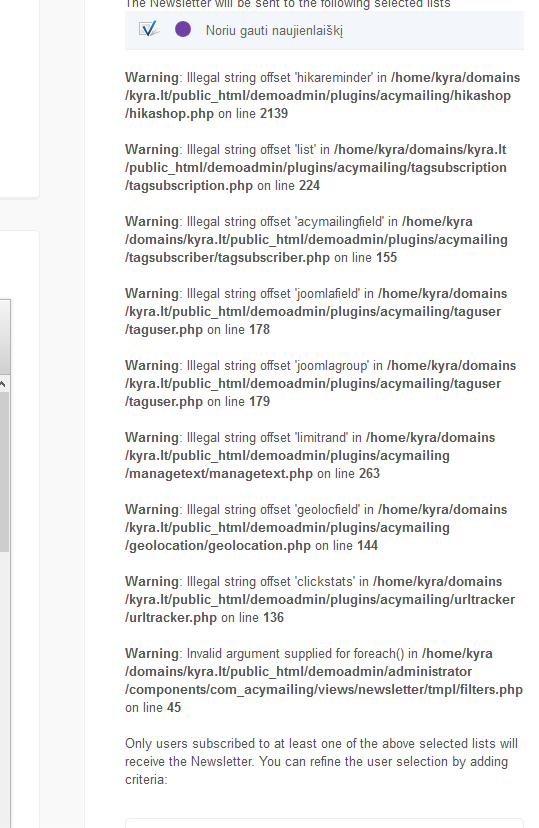

2. I also have another problem. Before update all products were accessible from category view....Now one of products gives error below:
Fatal error: Call to undefined function first() in ..................../components/com_hikashop/views/product/view.html.php on line 1597
Replacing with old view.html.php file gives same error as per acymailing:
Parse error: syntax error, unexpected ')', expecting :: (T_PAAMAYIM_NEKUDOTAYIM) in ..................../plugins/acymailing/hikashop/hikashop.php on line 622
So i have replaced this file with the old one too and product has started to work but with the following errors in acymailing newsletter edition page. Please look at screenshot acyerrors2
I may be wrong but it looks like these 2 are related.
p.s. thx god i did install it on my test site....
Many thanks

Thanks for the additional feedback. Please try again. This time it should be fine for both.
  • Posts: 1119
9 years 11 months ago #249065
2. Resolved
1. Still gives those errors as per acyerrors2 screenshot I attached. Filter doesn't work either...
Nicolas, would it be possible to add possibility to download last build of previous hikashop version in my subscriptions section?
So if something goes wrong people could download version which was working for them. I think not all people install it on test site first and wait for the month until all works fine...Like I do.
  • Posts: 86081
9 years 11 months ago #249071
The warnings on the screenshot www.hikashop.com/media/kunena/attachments/38342/acyerrors2.png comme from AcyMailing plugins. They are not related to HikaShop. So I can't help with that. You'll have to check with AcyMailing's support regarding them as I don't think they are linked to your update of HikaShop.
We purposely give only the latest build because when we were doing betas, no one was testing them, resulting in the same outcome with finally releasing the stable version. Instead, we activate the stable release flag only once we're confident that everything is fine so that only people installing a new website, or people interested in beta-testing can get them.
The changes in minor releases are normally really easy to fix (like the ones you pointed out) so we can directly hotfix them.
If you need the package of an old version, you can always ask us via our contact form and we'll provide it.

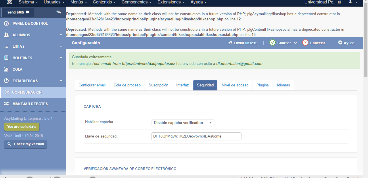

9 years 6 months ago #263037
I am getting the following errors when using acymailing. How can I solve it?
Thank you!!!:
Deprecated: Methods with the same name as their class will not be constructors in a future version of PHP; plgAcymailingHikashop has a deprecated constructor in /homepages/23/d628164423/htdocs/principal/plugins/acymailing/hikashop/hikashop.php on line 12
Deprecated: Methods with the same name as their class will not be constructors in a future version of PHP; plgContentHikashopsocial has a deprecated constructor in /homepages/23/d628164423/htdocs/principal/plugins/content/hikashopsocial/hikashopsocial.php on line 13

I'm afraid that you're not up-to-date.

You were right. I have updated and now I only get the following message:
Deprecated: Methods with the same name as their class will not be constructors in a future version of PHP; PlgContentHikashopsocial has a deprecated constructor in /homepages/23/d628164423/htdocs/principal/plugins/content/hikashopsocial/hikashopsocial.php on line 13.
Thank you !!!
