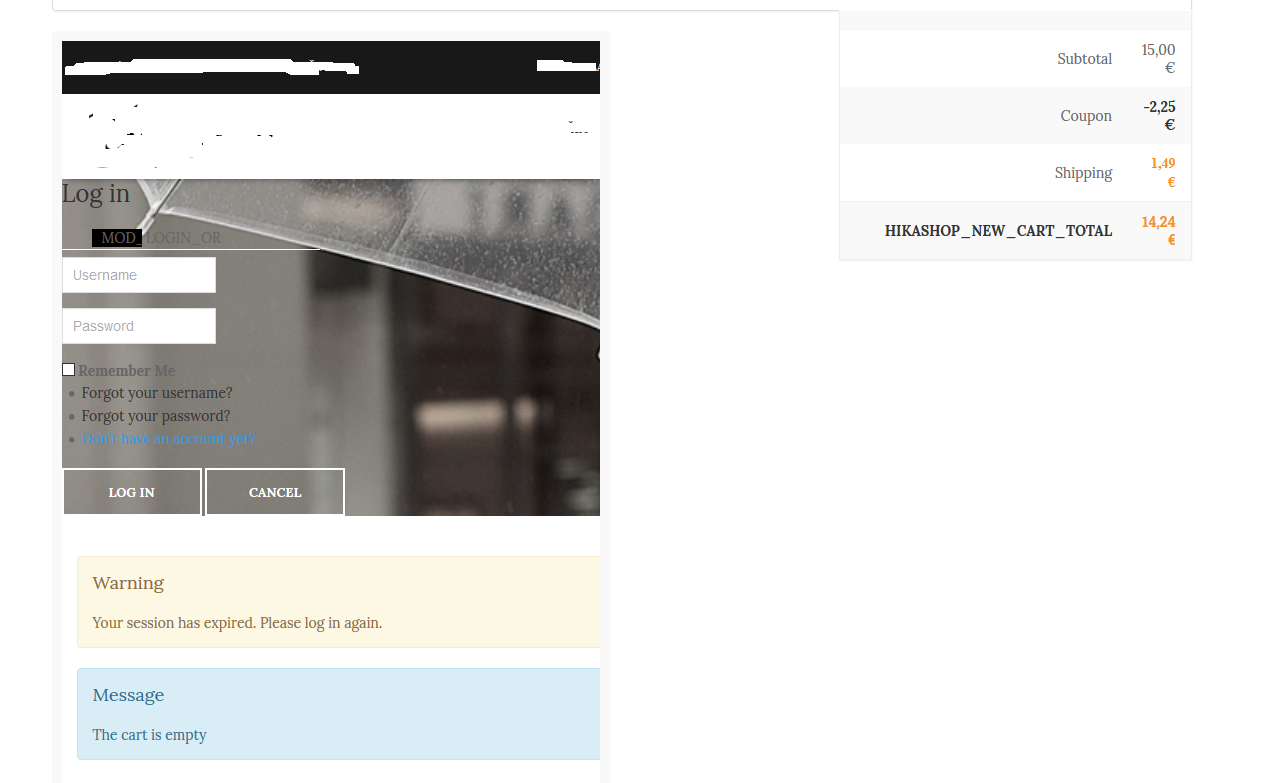

I have noticed long time ago this and thought maybe later it will get fixed but as for now it seems not.
You need to be logged in. If you are in new checkout and wait until session expires. Pressing on any button with ajax it will load home screen inside that div with following error messages. "You session has expired", "The cart is empty".
Or if you try to proceed to next step it will give invalid token on the left top screen with blank page.
I have attached image where i used to enter coupon after session has expired.

Thank you for your feedback.
I've added a patch which should fix at least the token issue and maybe the session expired one too.
Make also sure that you didn't restrict your checkout menu item and/or the menu item of the "URL where to redirect when the cart is empty" to a registered user access in your Joomla menu manager.
