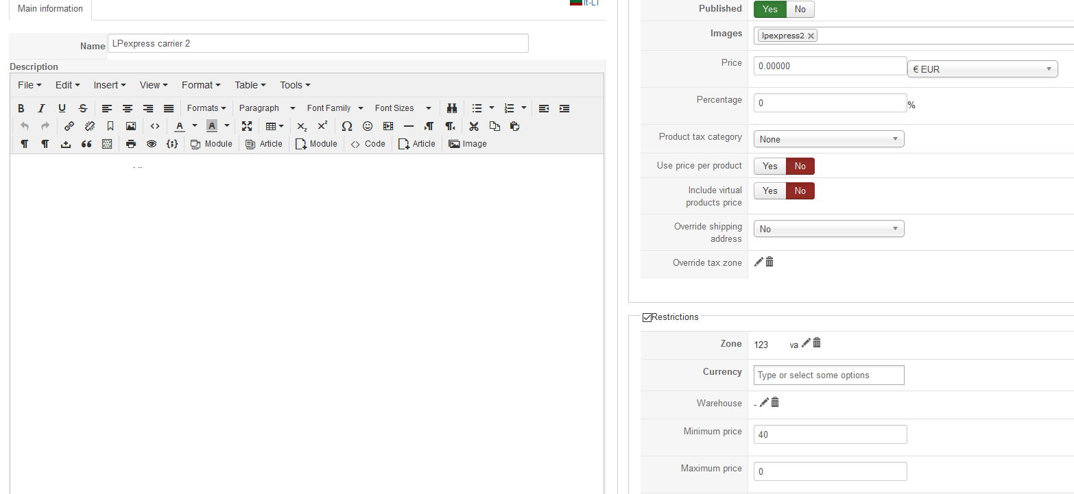

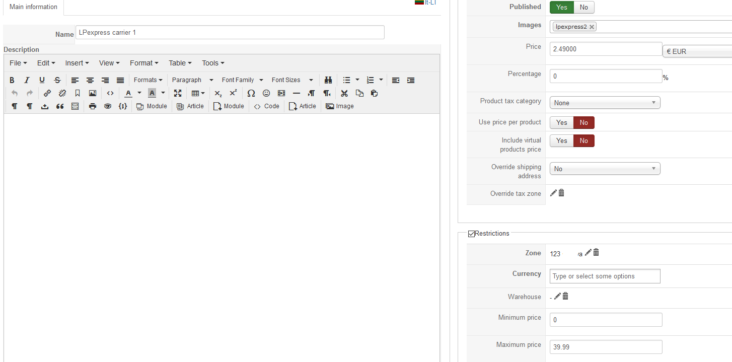

1. Create shipping method and set Maximum price "39.99" - shipping cost 1.99.
2. Create second shipping method and set Minimum price "40.00" - free shipping.

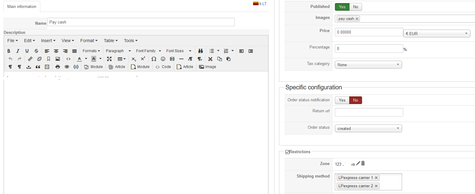

3. Create payment method and restrict it to these above shipping methods.
4. In checkout workflow make sure you have 2 or more shipping methods.

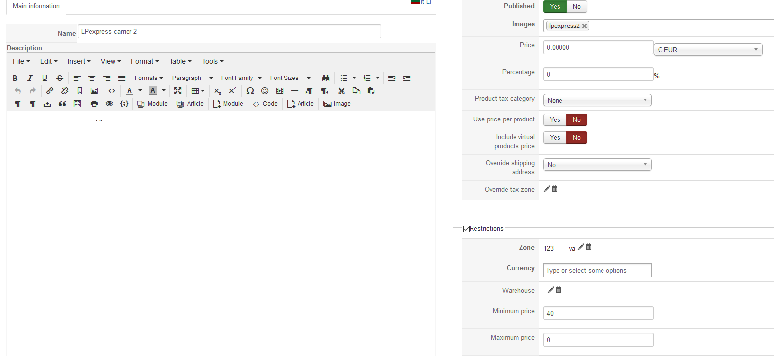

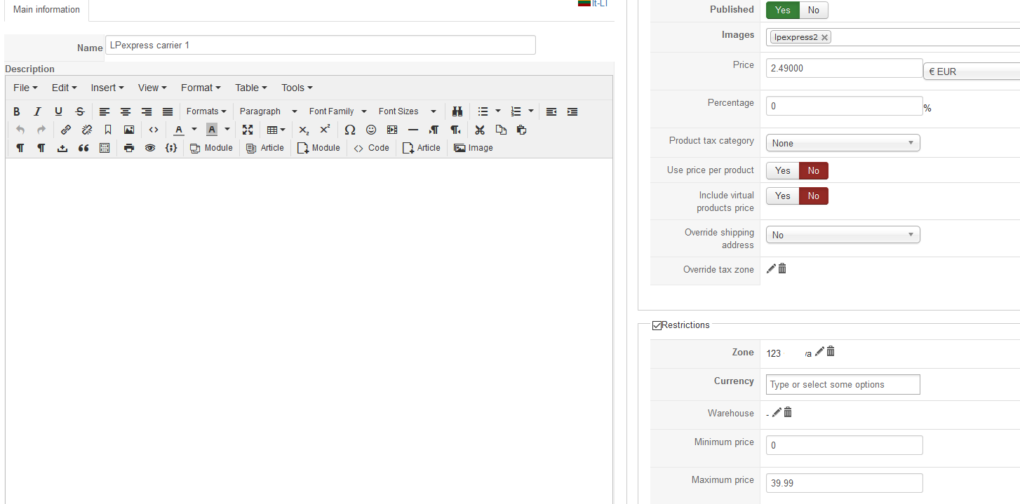

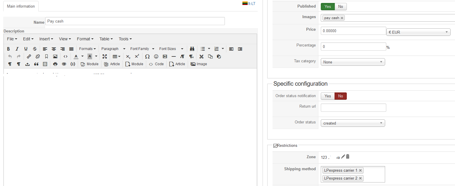

Added some screenshots.

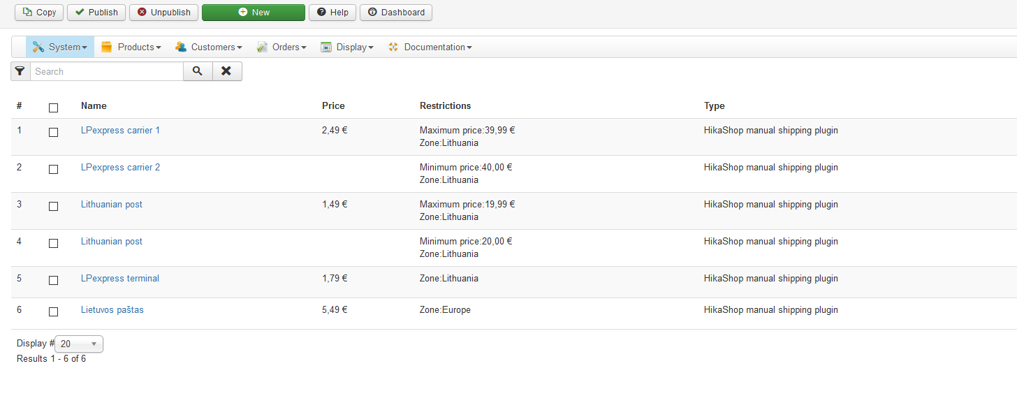

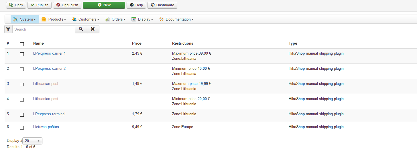

I would like to update it: To have issue you also must have more shipping methods with restriction. I have added screenshot of all shipping methods and how they are configured. It looks like payment methods wont refresh if you have few shipping methods with price restrictions.
