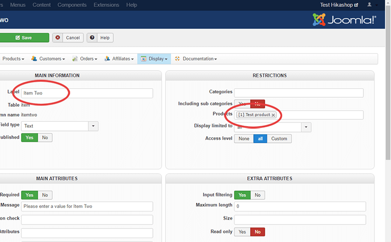

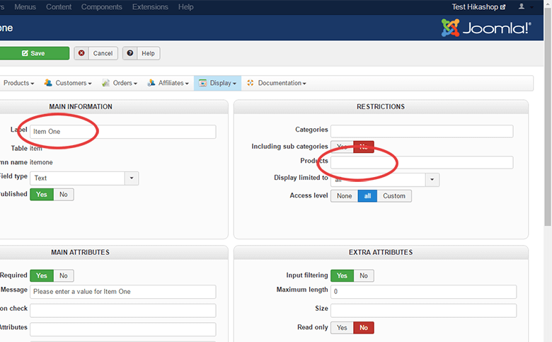

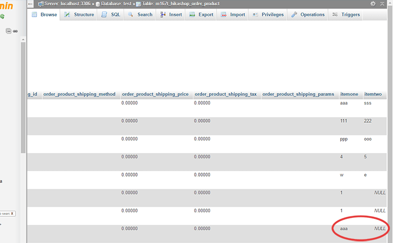

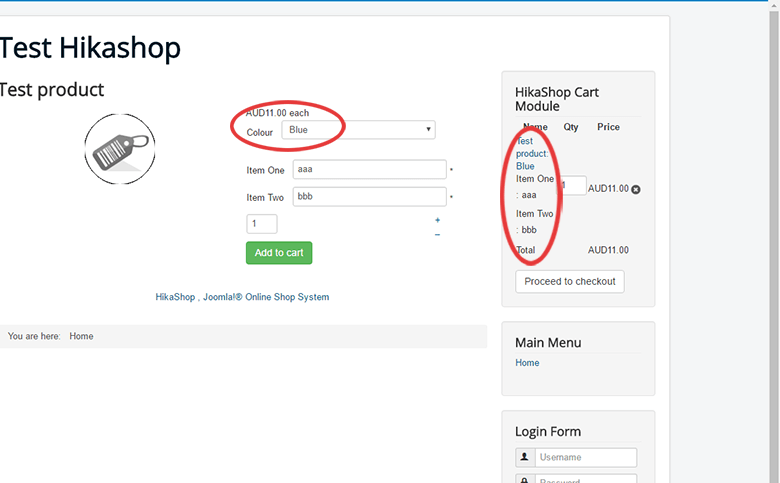

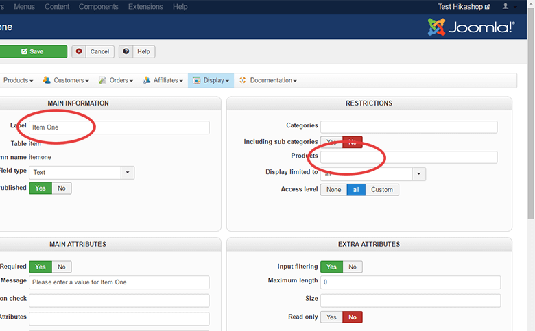

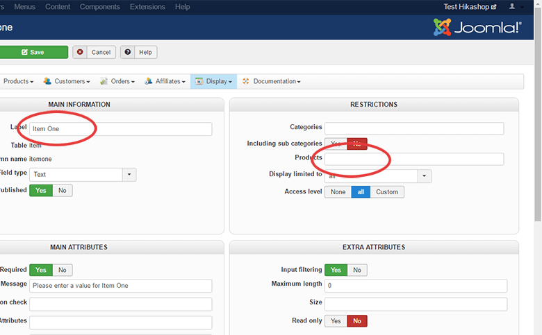

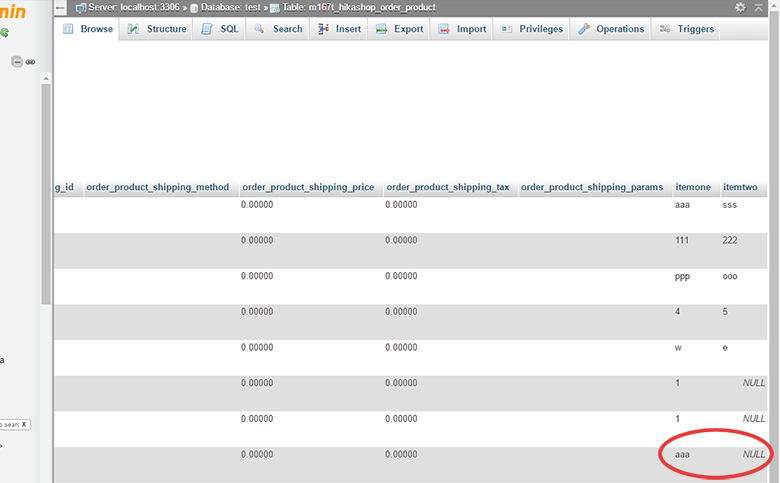

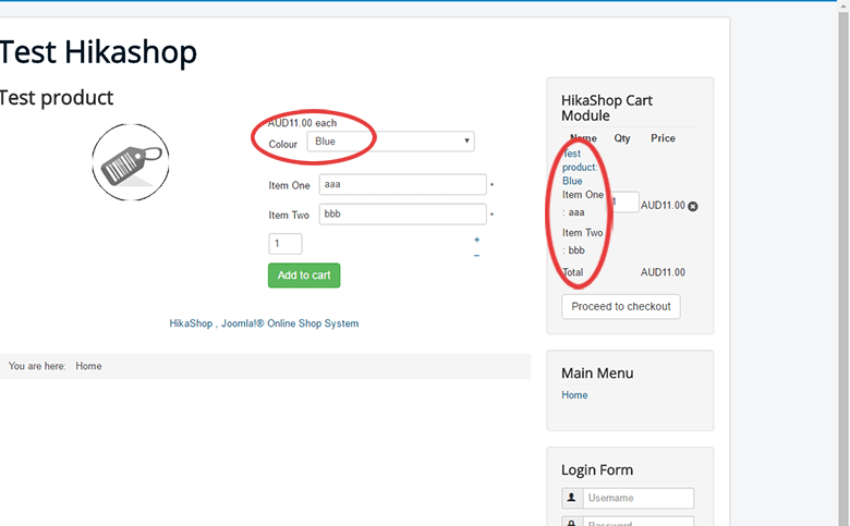

Thanks for your time looking into this. I've downloaded and installed the latest version again and still see the problem on 2 different sites so I decided to set up a bare Joomla set up and was able to recreate the steps to highlight the issue. The problem seems to only occur with a product that has variants - so I think it's only an issue for a very specific set up.
To see the problem set up a product with one variant and add 2 Item custom fields. Item One has no restrictions and shows on all products. Item Two is restricted to only show on the one product I set up.

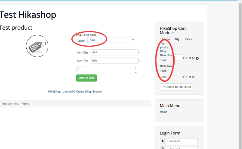

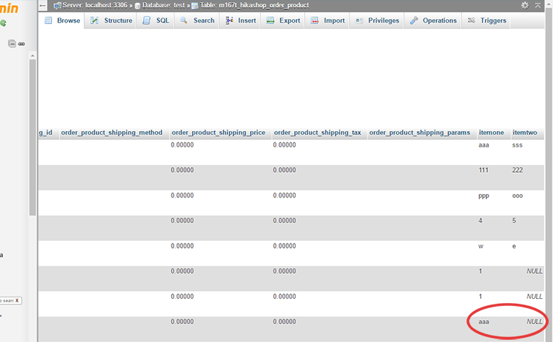

On the front-end after filling in the custom fields, adding the item to the cart and going through the checkout process, you can see in the __hikashop_order_product table that the value for Item Two isn't saved (NULL.)
