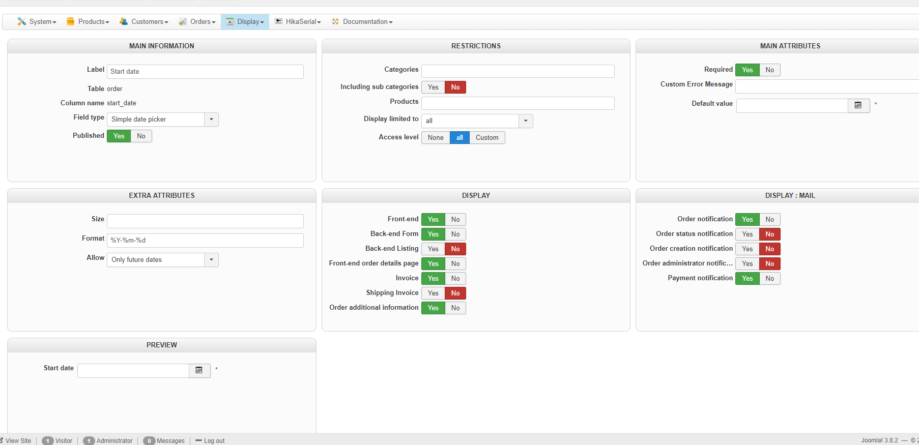

-- HikaShop version -- : HikaShop Business: 3.2.1
-- Joomla version -- : Joomla 3.8.
-- PHP version -- : 7.0.10
After creating a Custom field type Simple date picket, for the order process, using extra attribute (Only future dates), the condition doesn´t work. It doesn-t work the Only past dates condition either. So it doesn´t control the date picked according to the criteria.
Last edit: 8 years 8 months ago by Jerome. Reason: remove duplicate message
  • Posts: 86081
  • Thank you received: 14189
8 years 8 months ago #283957
The simple date picker uses the Joomla calendar system and depending on the version of Joomla, the trick we used to control the past/futur dates doesn't work.
Please switch to the "advanced date picker" type which uses our own date picker library, which works regardless of the version of Joomla you're using.
  • Posts: 4
8 years 8 months ago #284011
I didn´t have that pluging enabled.
The advanced date picker works perfectly.
Thanks so much.
