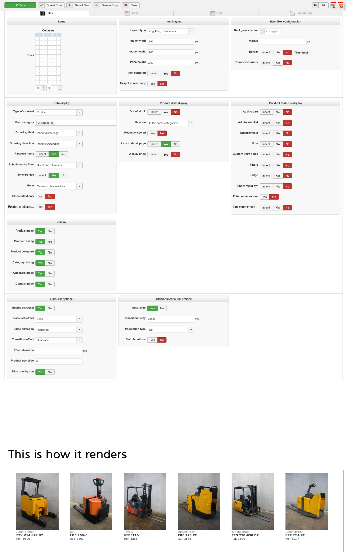

It indeed looks like a bug in the owl carousel system we're using.
Could you provide a screenshot of the settings under the "hikashop options" tab of your module ?

8 years 6 months ago #287136
Here it is
