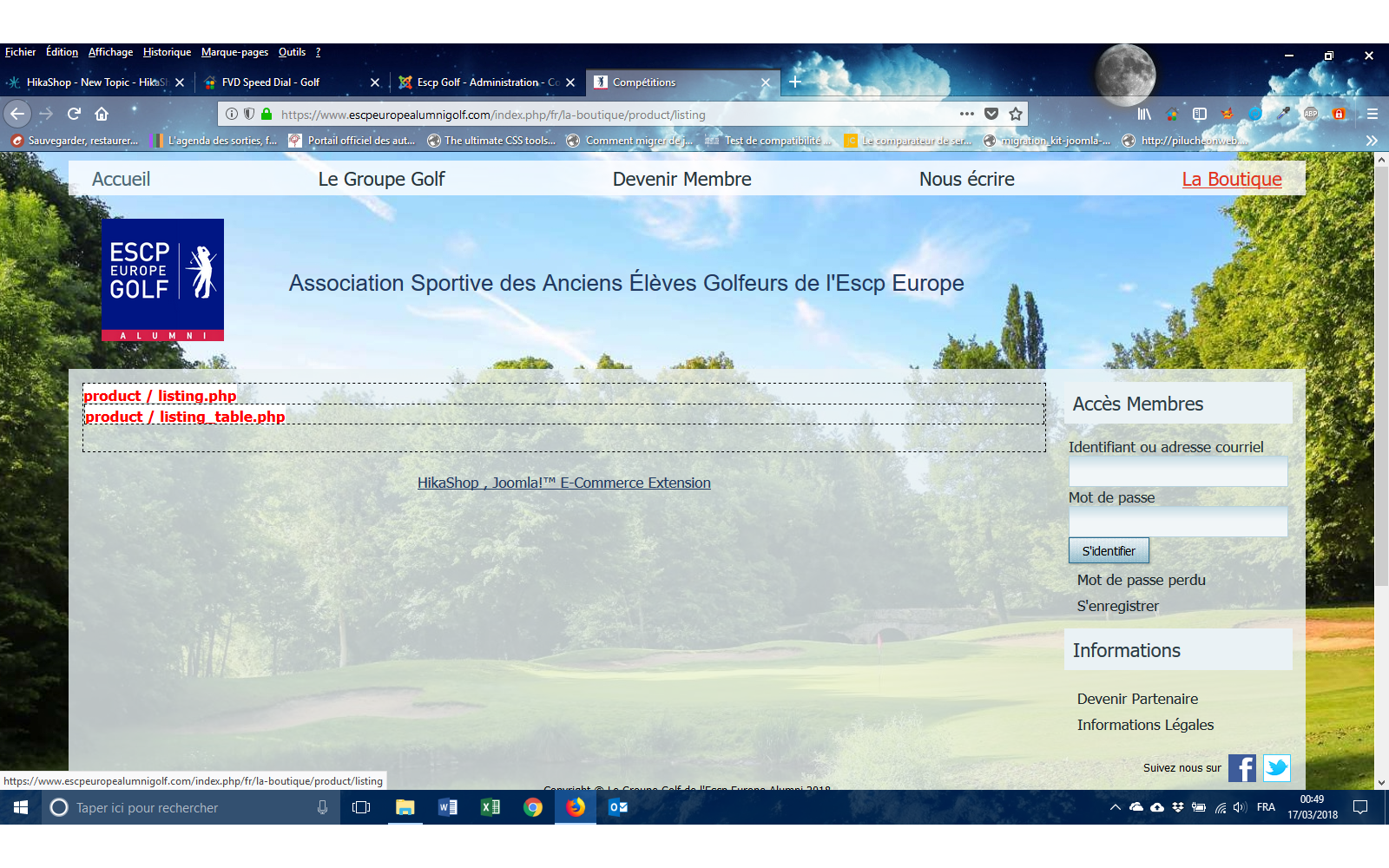

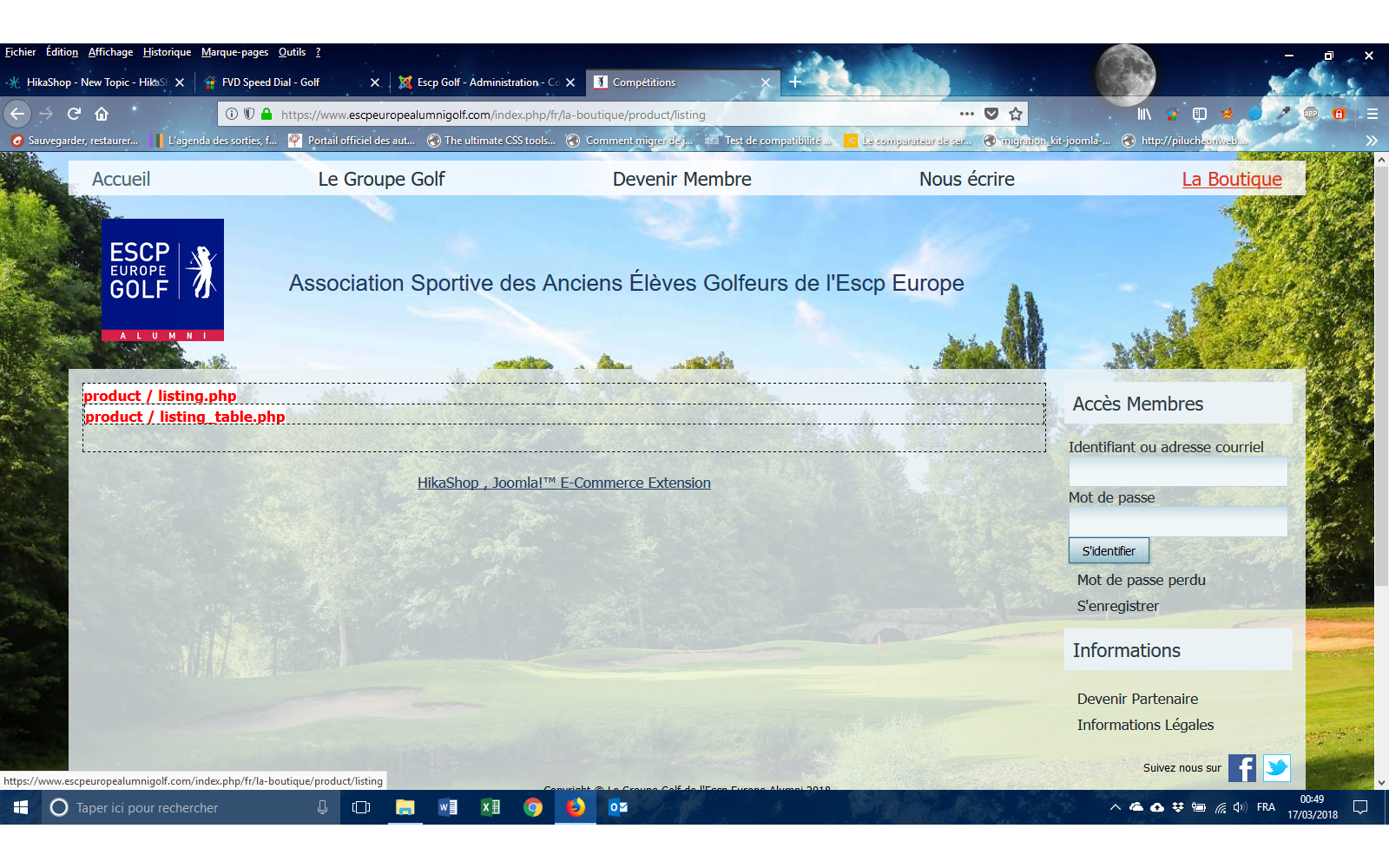

Got RED error messages on every page refring to .php like for example
product / listing_table.php
etc..
No product, nocart nothing is shown

Just go to hikashop configuration>advanced tab and set "Display view files" to NO. This will fix your issue.

  • Posts: 10
8 years 5 months ago #289834
Hi Kiratn
I did, but now ALL my products settings are almoste gone !
No more images,related, no listing shown
Cant understand..

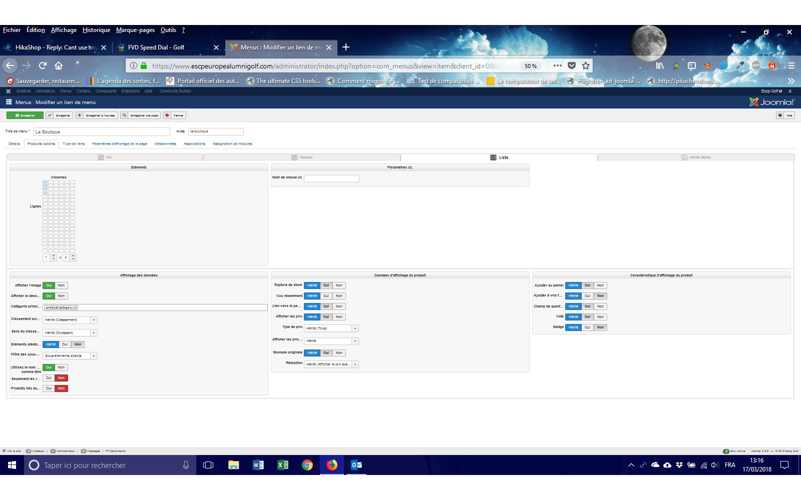

Also, the fact that you don't see the listing of products there is also not linked to a bug of the upgrade. This is because of a problem with the settings of your menu item.
We would need a screenshot of the settings of your menu item to be able to help.

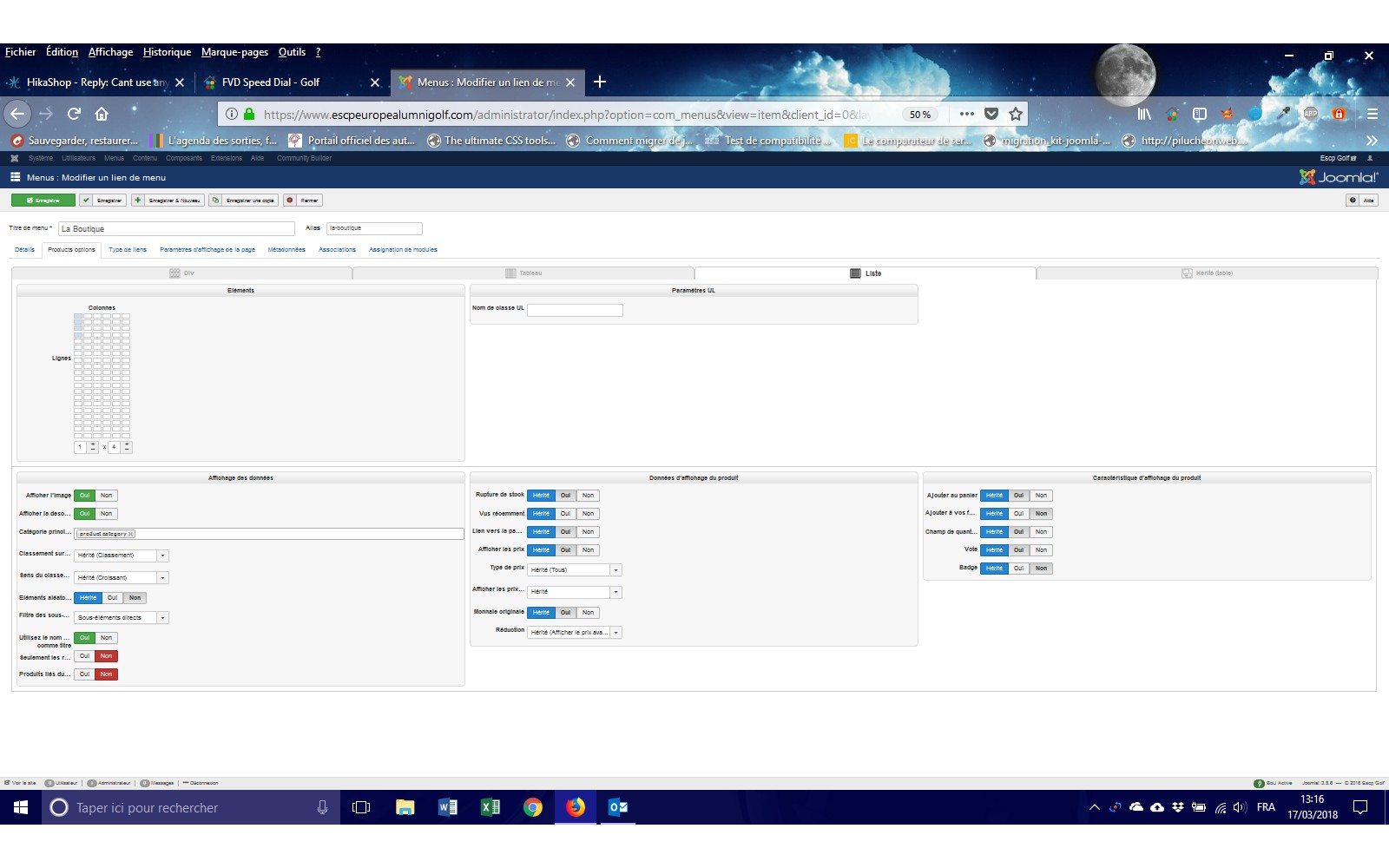

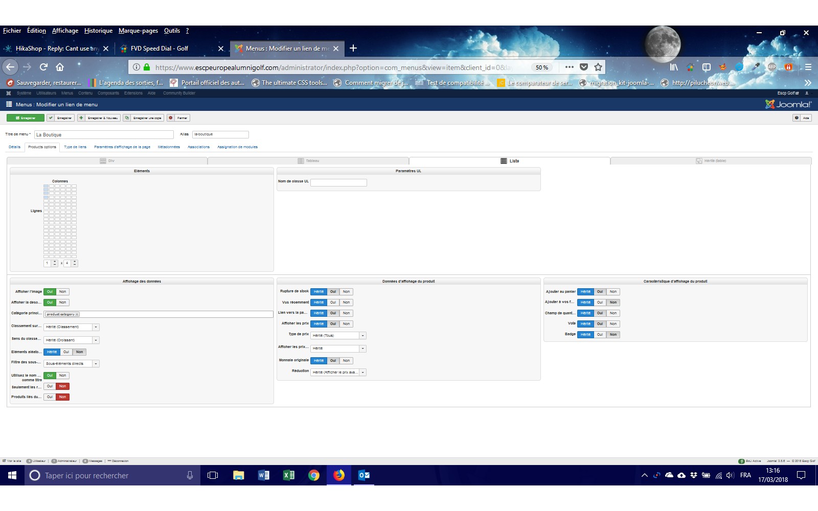

  • Posts: 10
8 years 5 months ago #289843
My "view files" problem is solved, thanks
I dint ment that there is a bug in Hikashop
I just noticed that i have to check all the previous settings
For example, i have to set all the products and categories images back
And this is the screenshot of my menu item
Thanks for help, anyway

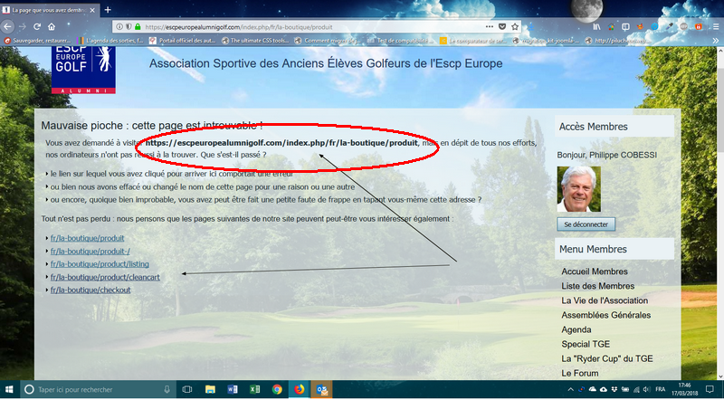

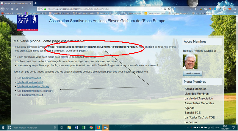

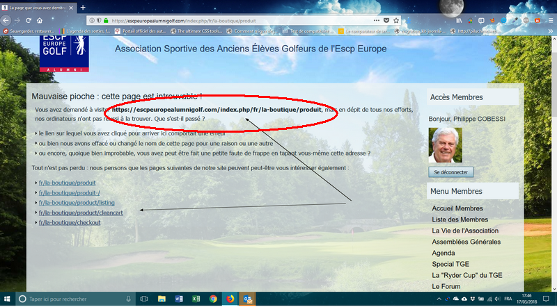

Je passe en version française..
Il me semble qu'il y a aussi un problème de langue
Voir le 2ème screenshot
Merci de m'éclairer pour sortir de là
Reconnaissant !

  • Posts: 10
8 years 5 months ago #289851
Bonsoir Nicolas,
Au cas où, j'ai essayé de créer de nouveaux liens de menu pour aller sur les pages produits de Hikashop
ET ÇA MARCHE !
Les anciens liens de menu ne fonctionnaient donc pas et n'était plus reconnus
Je crois que je vais pouvoir poursuivre
Oubliez ma demande d'aide.:) :)
