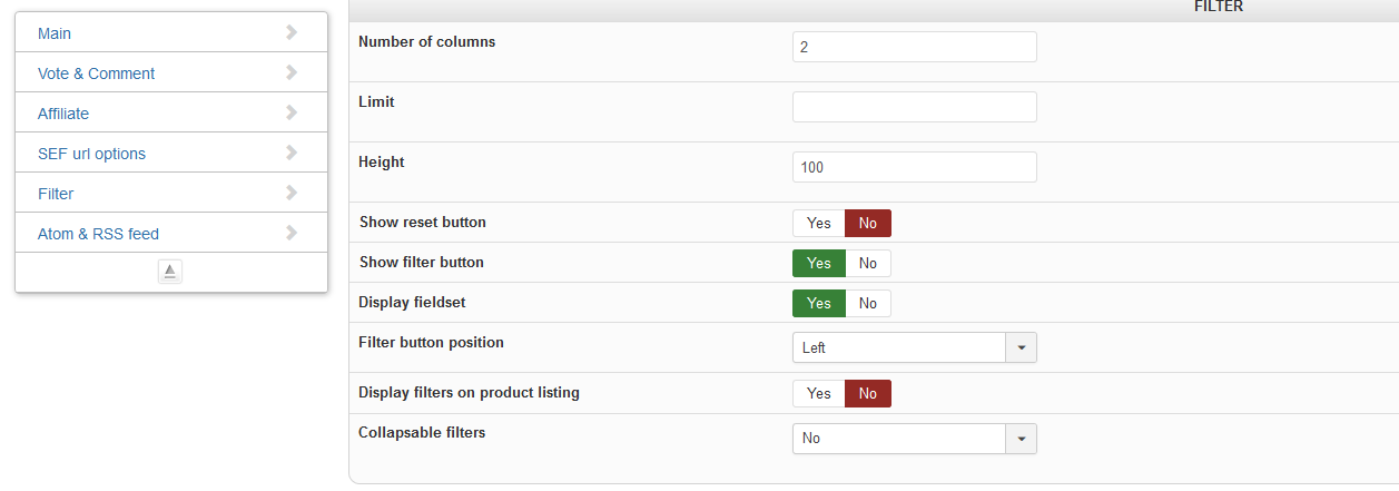

-- HikaShop version -- : 1804061838
1. I have set Collapsable filters to "NO" but filter still get collapsed on lower screen >640px

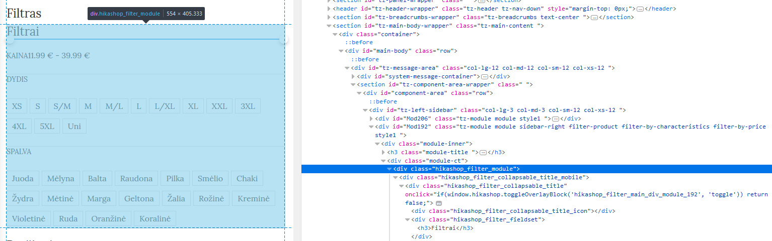

1. Unfortunately i can't because its on local host. We are migrating to new framework and do template from scratch....
I have looked into view filter file and it looks like "if($this->collapsable)" doesnt work at all for us. Whatever changes we make in features->filter->collapsable filter, html always has mobile class. I have attached some screenshots.

Without looking at the page, and analyze the situation it will be hard to say anything useful I'm afraid.
