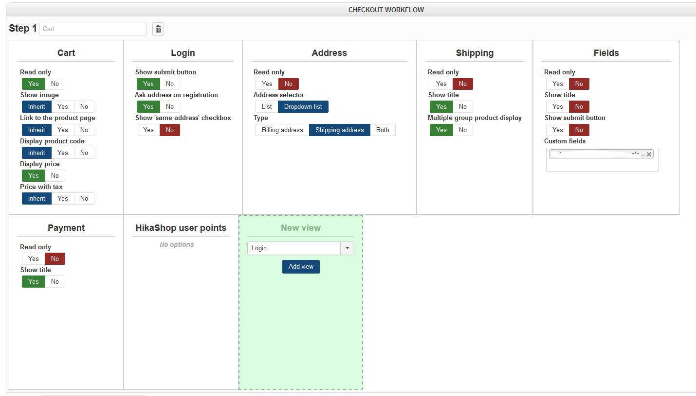

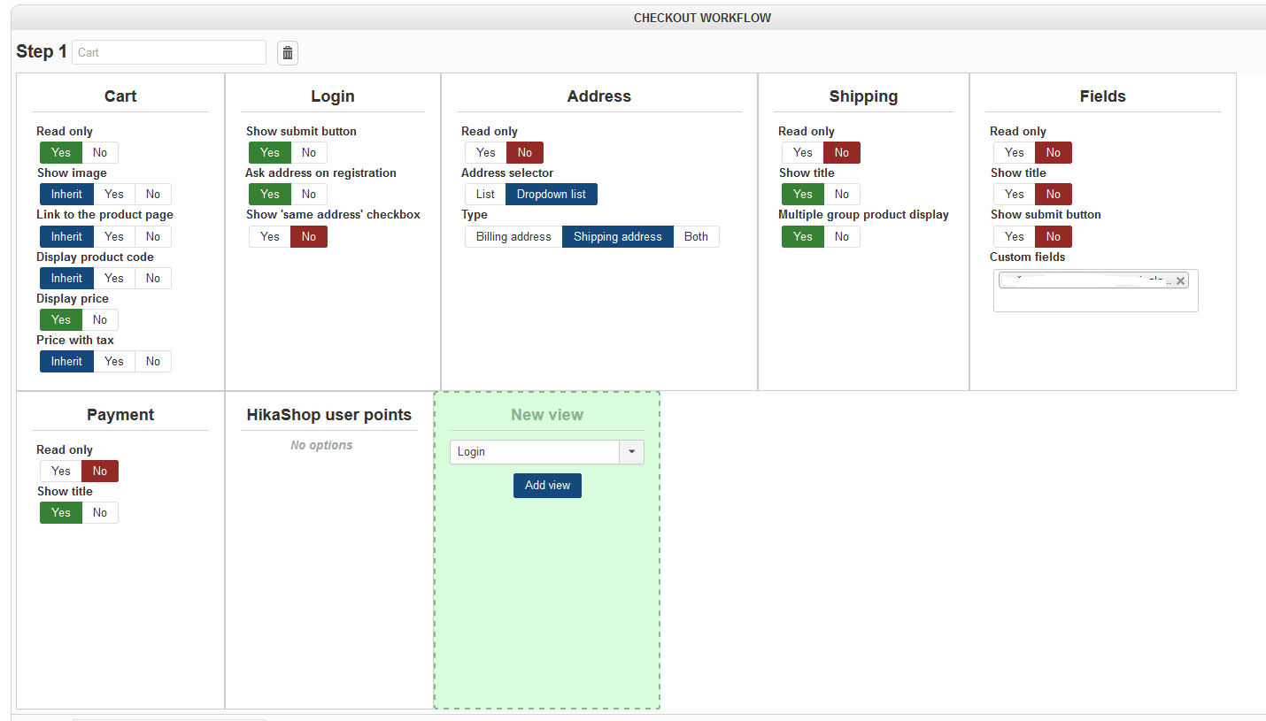

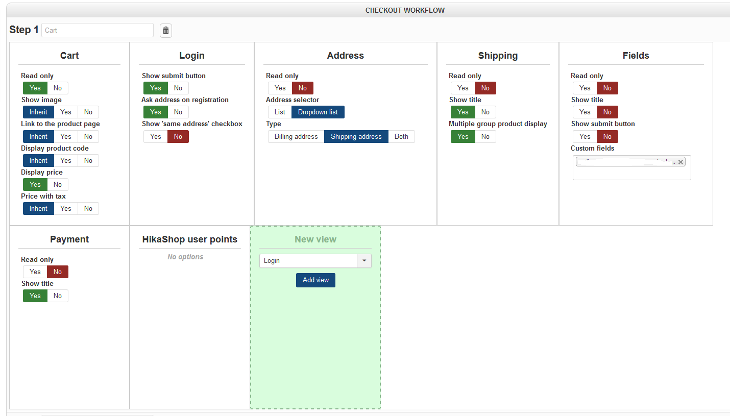

Checkout config:

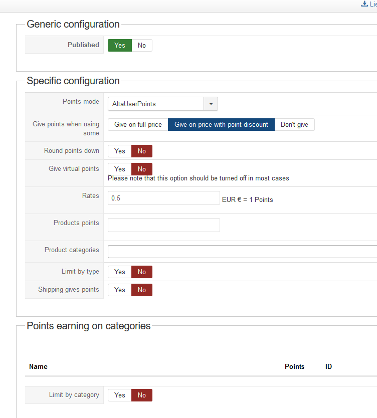

7 years 11 months ago #296058

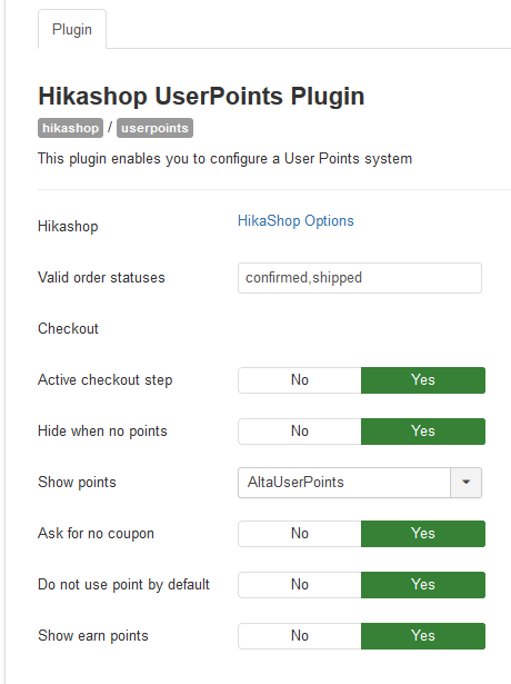

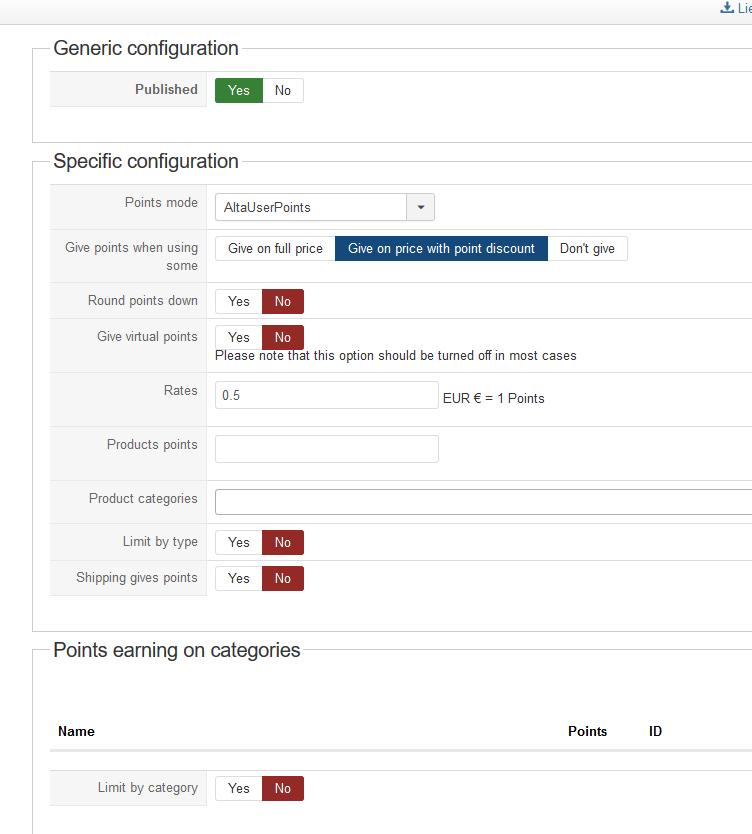

Can you also provide a screenshot of the settings if the user points payment method and the user points plugin via the menus System>Plugins and System>Payment methods (if any) ?
These are where the main settings are for the user points system.
  • Posts: 1119
  • Thank you received: 114

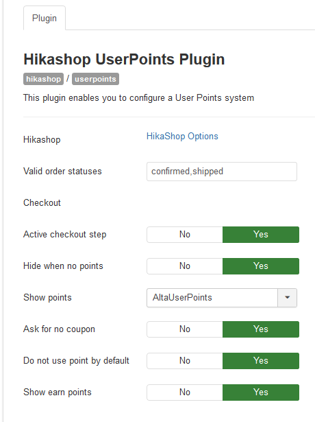

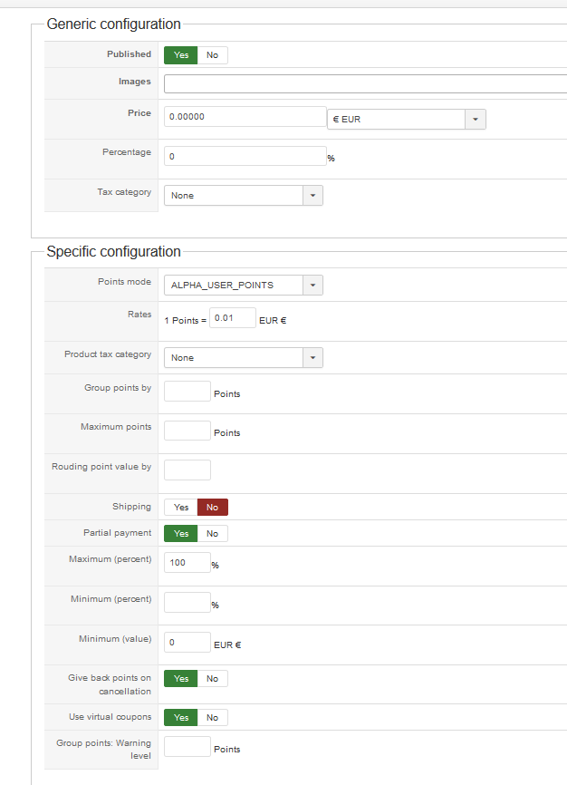

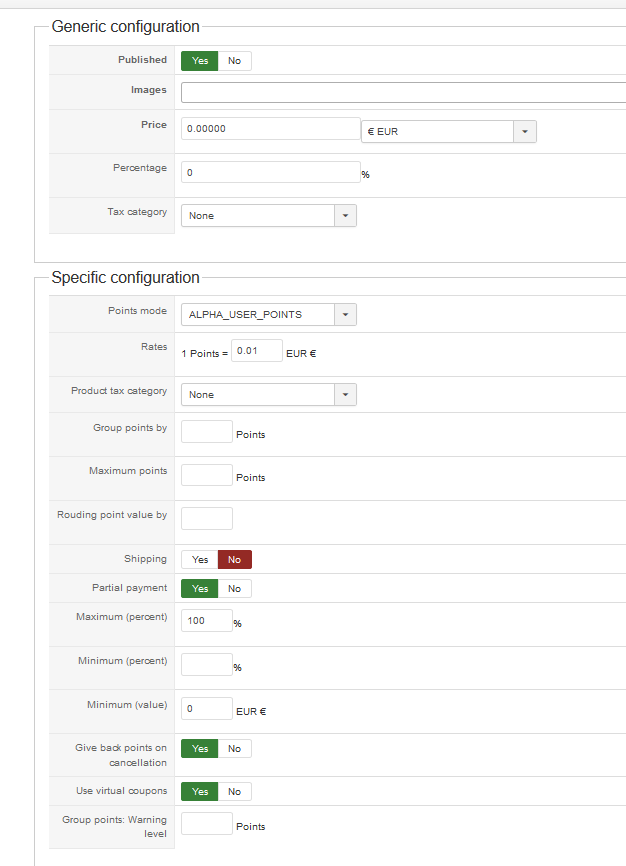

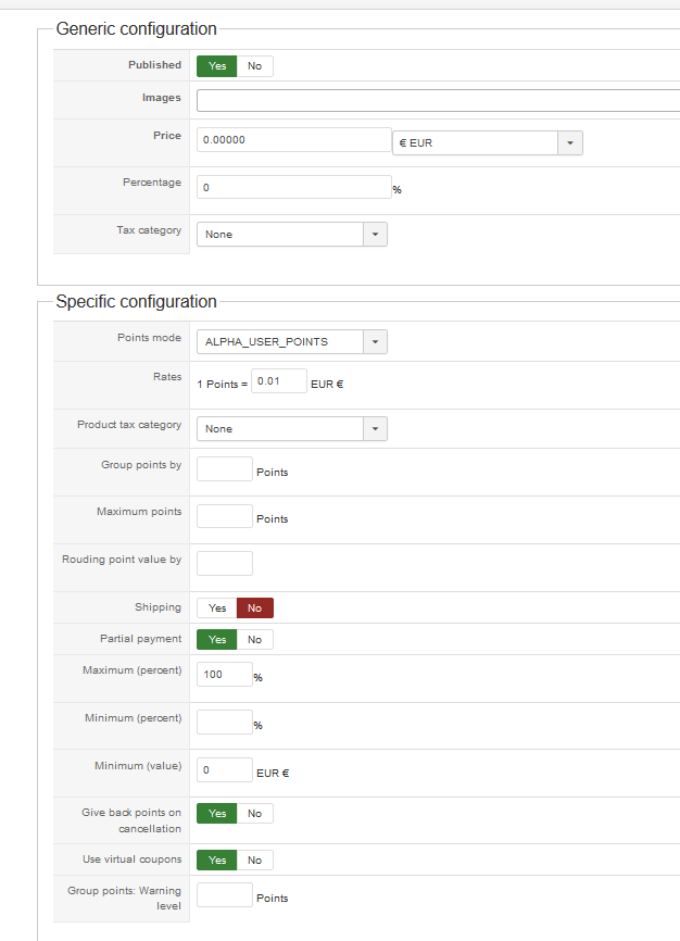

7 years 11 months ago #296080

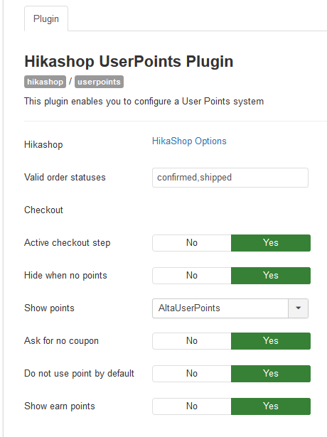

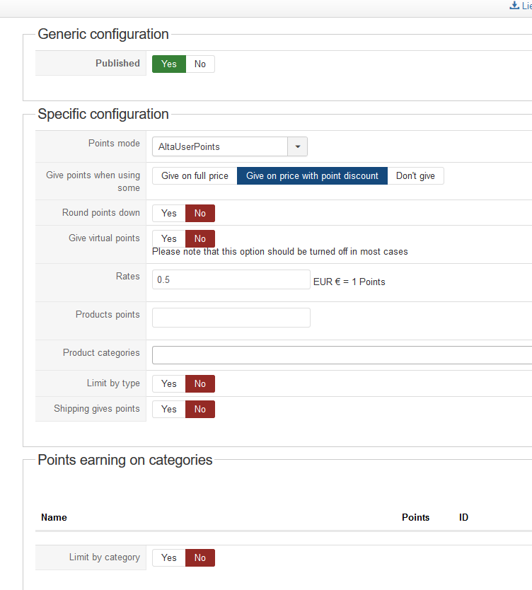

Sure, here is the system -> plugins screenshot:
Only one plugin here, type of userpoints
And another one of system-> payment method plugin
Hope this helps
Thank you
  • Posts: 1119
7 years 11 months ago #296081
Also both plugins have restriction set to "Registered"

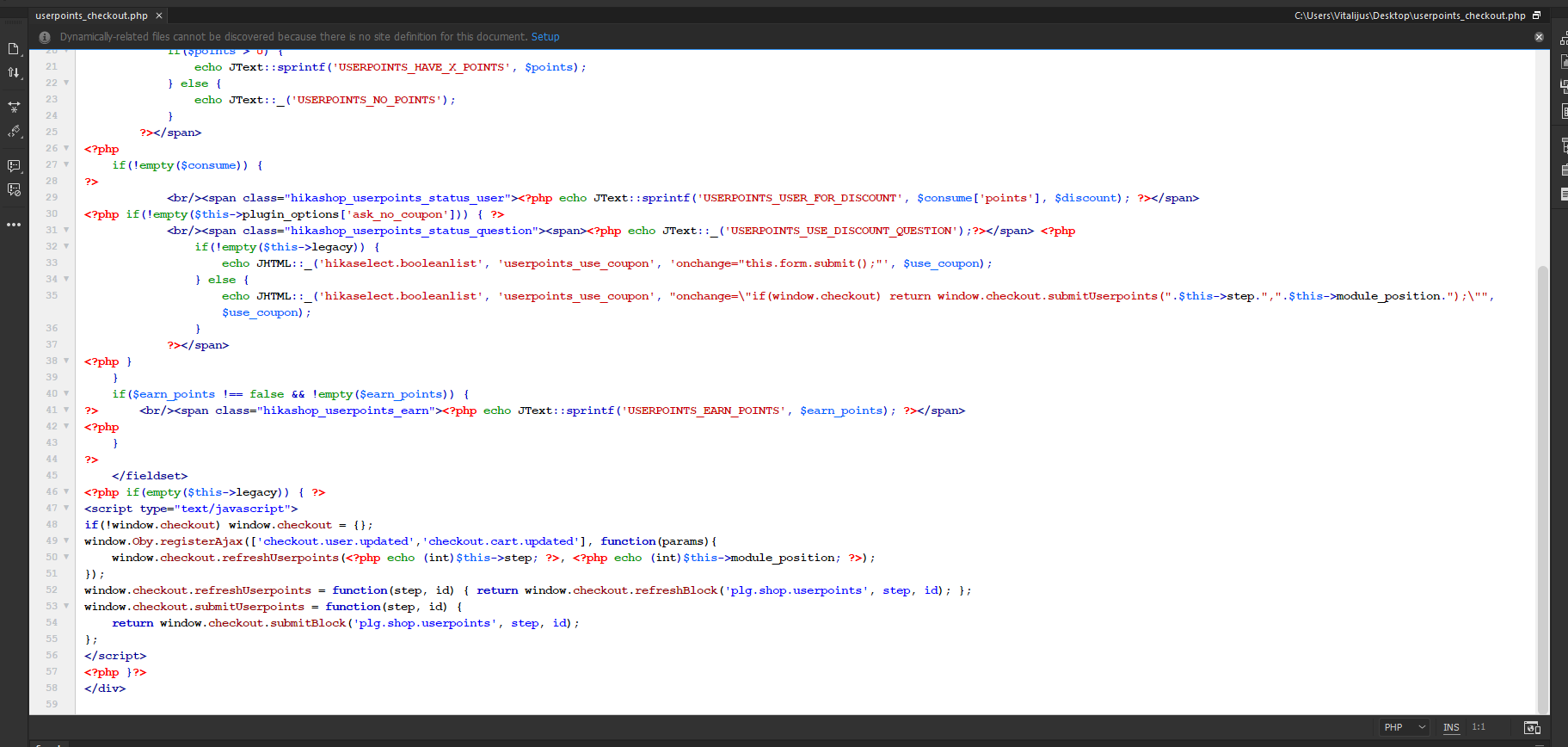

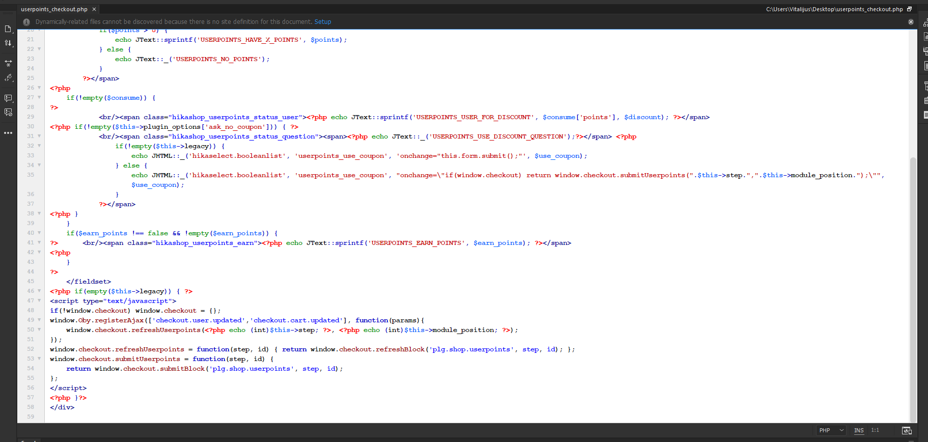

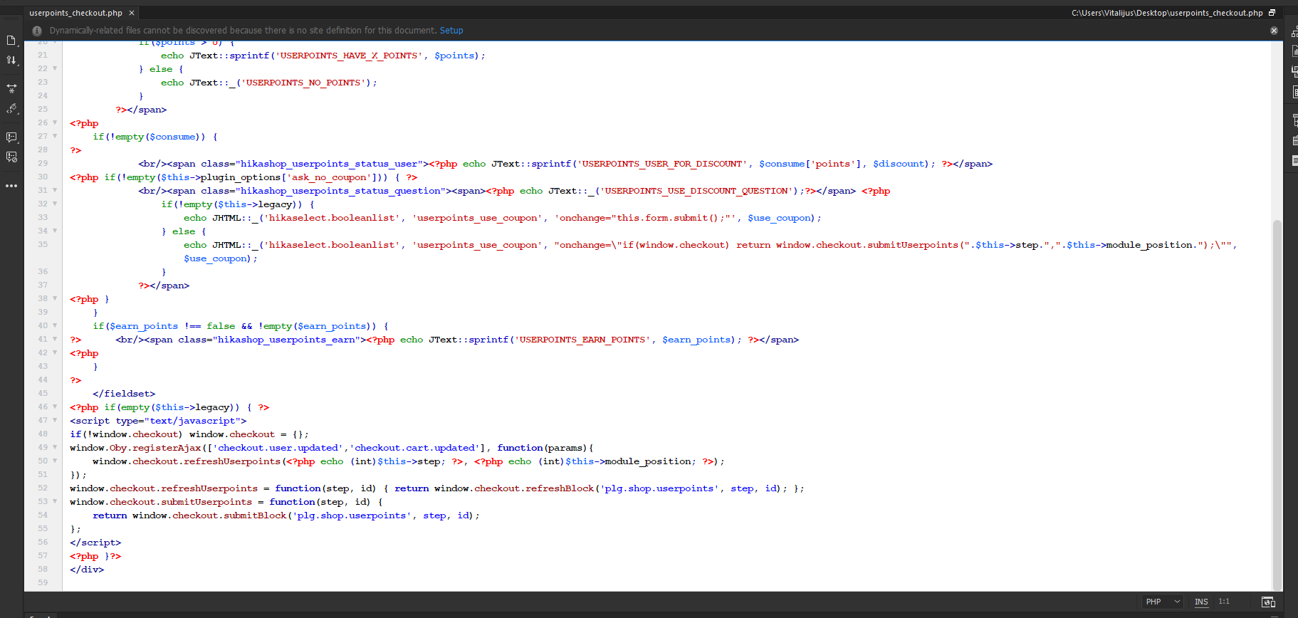

7 years 11 months ago #296168
Ok, I think I know what is the issue.
Change the line:
window.Oby.registerAjax('checkout.cart.updated', function(params){
to:
window.Oby.registerAjax(['checkout.user.updated','checkout.cart.updated'], function(params){
in the file plugins/hikashop/userpoints/userpoints_checkout.php and that should help with the refresh of the user points view when the user logs in on a one page checkout.
Last edit: 7 years 11 months ago by Jerome. Reason: [code] tag is nice
  • Posts: 1119
7 years 11 months ago #296175
Unfortunately it didn't help.
Shouldn't some kinda function to be added in show_block_login view which will add/update user points?
Any other solutions please?
Kind Regards

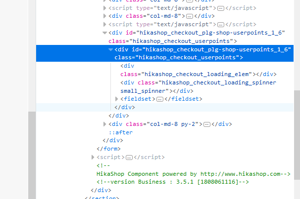

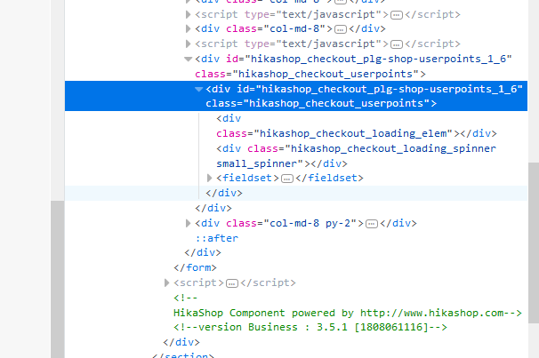

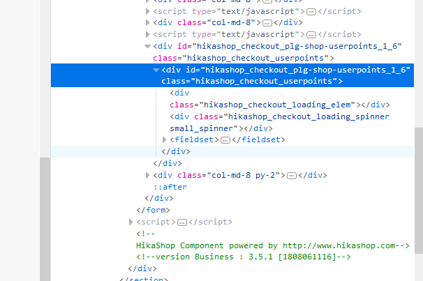

7 years 11 months ago #296328
Thank you, It works fine now. However there is still small issue.
After login or registration the hikashop_checkout_userpoints div is dublicated as per my screenshot bellow:
So i had to apply some css in order to fix that and i am fine with this....
Thank you very much for great support.
Have a great day
  • Posts: 85860
  • Thank you received: 14101
7 years 11 months ago #296332
Thanks. We've added another patch for that.
