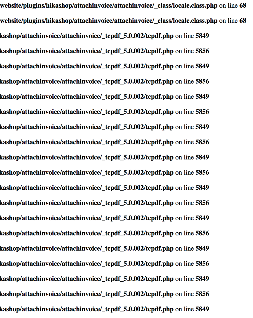

-- HikaShop version -- : 4
-- Joomla version -- : 3.8.13
-- PHP version -- : 7.2
-- Error-message(debug-mod must be tuned on) -- : plugins/hikashop/attachinvoice/attachinvoice/_class/locale.class.php on line 68
when I switch my server from PHP 7 to 7.2 the Hika Invoice Plugin comes up with various error messages, when I try to download invoices from selected orders from the backend. If I switch back to PHP 7 all works fine.
Any ideas?
Roger

Thanks for your report. We've updated the TCPDF library used by the PDF plugin to the latest version so that it can work properly with PHP 7.2.
Download again the install package of the PDF invoice plugin via the download link of your order of the plugin and install it on yours to get the update.
Note that if you modified the invoice.php file, you need to do a backup of the file before the install so that you can put it back after the update in order to not loose your changes.
