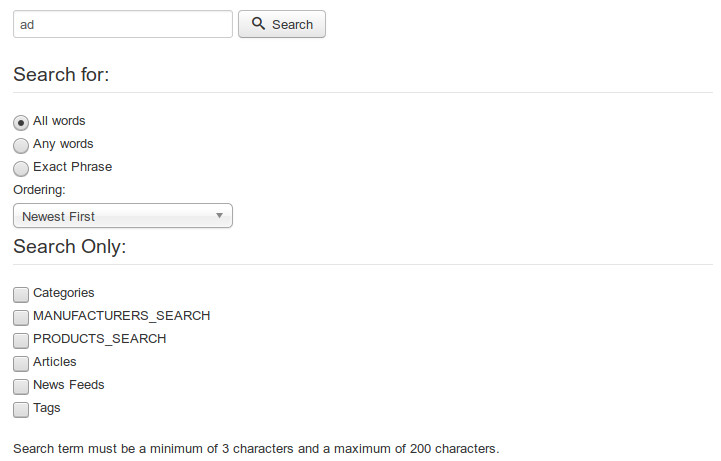

If there is a search error (e.g. try searching for a a term less than 3 characters), the search area strings that should say "Brands" and "Products" instead show as MANUFACTURERS_SEARCH and PRODUCTS_SEARCH. See attached screenshot.

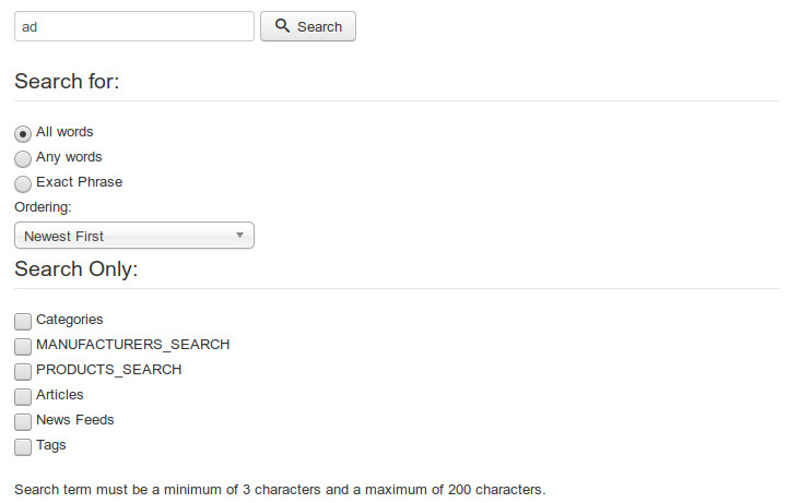

Sure thing. I am able to reproduce this on the HikaShop demo site:
  1. Go to the Joomla Search URL: demo.hikashop.com/index.php/en/?option=com_search&view=search . The search area ("Search Only") names are initially correct here: Brands, Products, Vendors.
  2. In the field up top where it says "Search Keyword", type "ad".
  3. Hit Return or click the magnifying class button. The search area names now show: MANUFACTURERS_SEARCH, PRODUCTS_SEARCH, HIKA_VENDORS.
Please note this is using the core Joomla Search, not the HikaShop Filter. As mentioned, if the search term is 3+ characters (i.e. "headphone"), then this problem does not appear.
