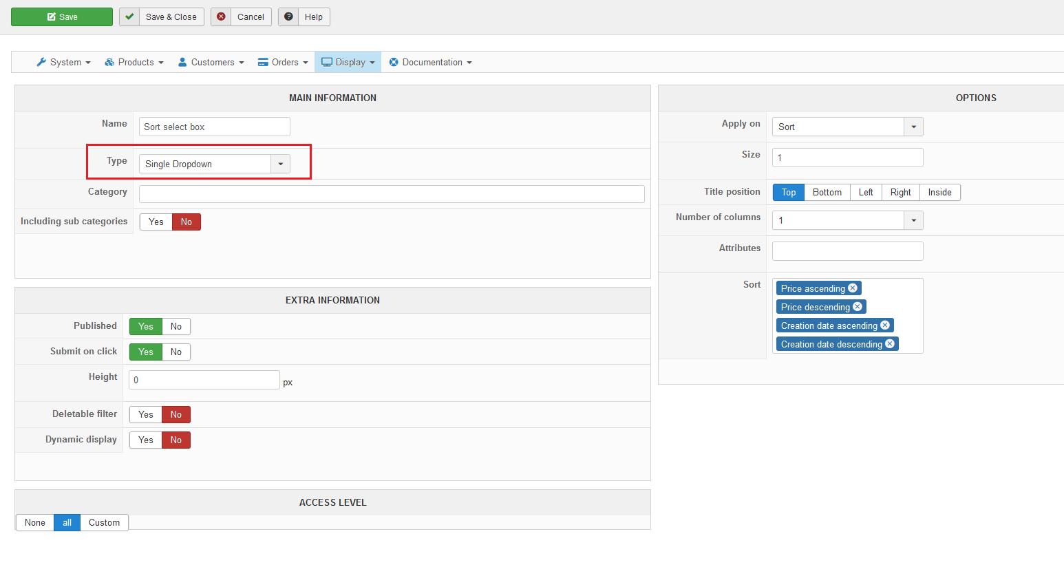

The issue:

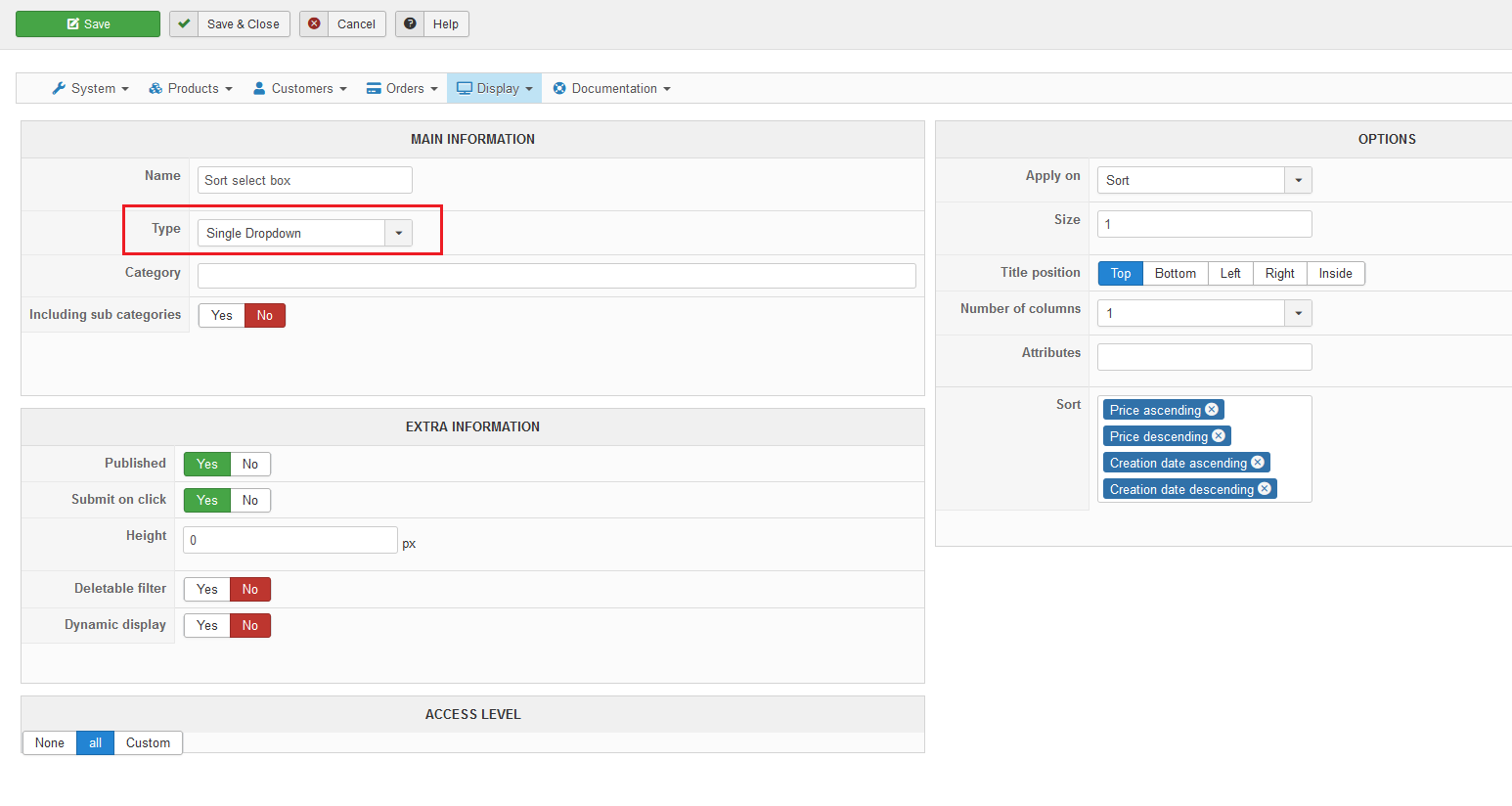

We created filter -> type "Single dropdown" -> apply on "Sort", selected some sort values....
It doesn't matter what you select in "Apply On" settings as the issue is with the select box...

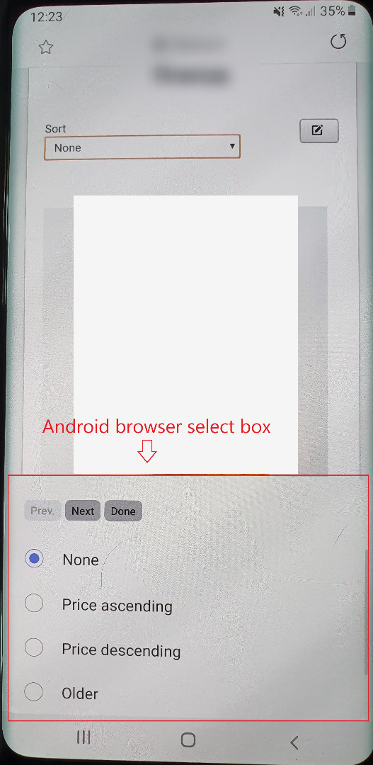

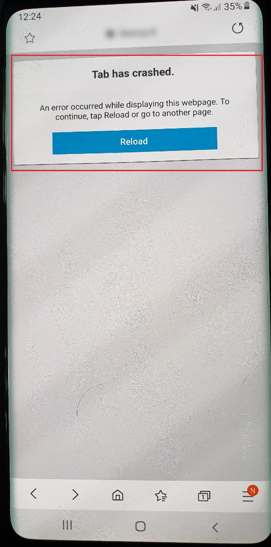

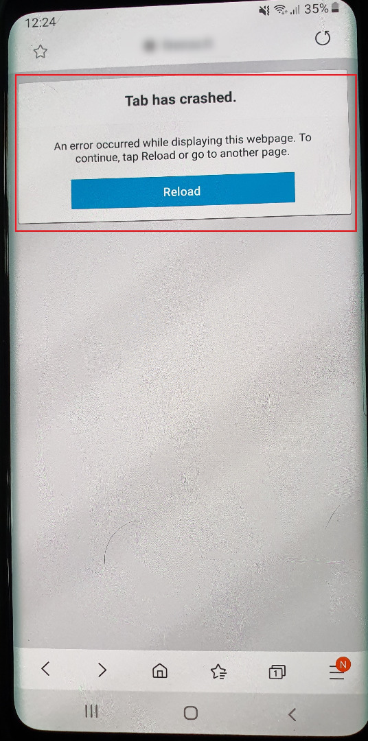

Now, using android default browser and selecting the select box, the select will slide from the bottom ( behivior of this browser ) so you can select any values. It works fine when u select first time, but after filter refresh, trying to select any value again, nothing happens. In order for it to work, you must hide that select by clicking somewhere outside. However this sometimes leads to "Tab crash" or page reload.
I have tried with some other browsers like Firefox, Opera Mini on Samsung S9+ and they don't have this issue. I believe it's because they use a popup as a select box and those after filter refresh it is getting hidden....
I am attaching some screenshot and i hope you can reproduce the issue:
