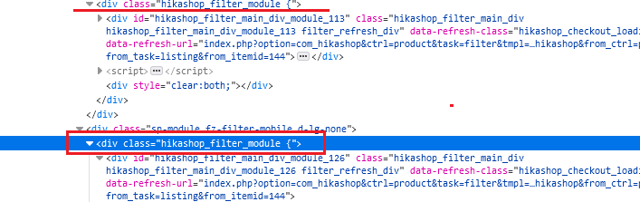

It seems with new Hikashop 4.2.2 there is a bracket added to each module. Seems it is related to changelog:
"The different modules included in HikaShop now support the "module class suffix" setting of Joomla."
Please check attached screenshot.
You probably want to remove it. It has same issue on all hikashop modules as far as i can see.
