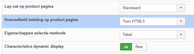

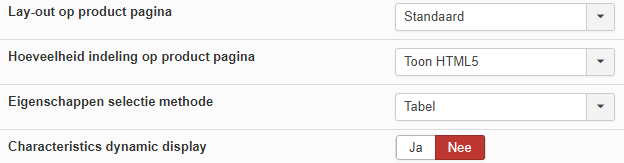

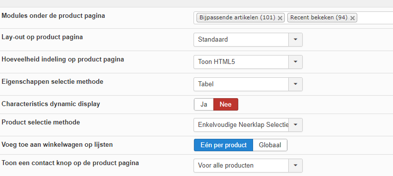

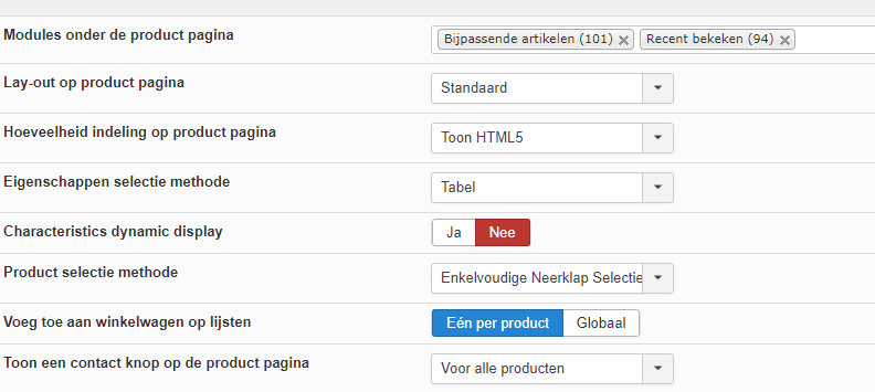

I just found out if I use the following settings:
That the waiting list option will not appear on the front
I adjust it:
Then I will get the notification

I'll explain it step by step:
I have set in the backend:

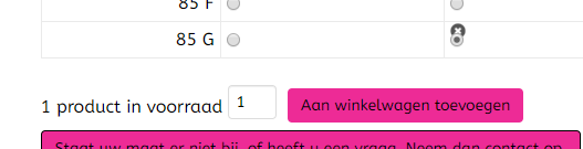

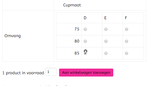

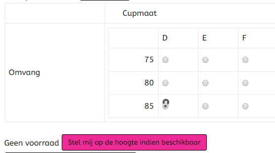

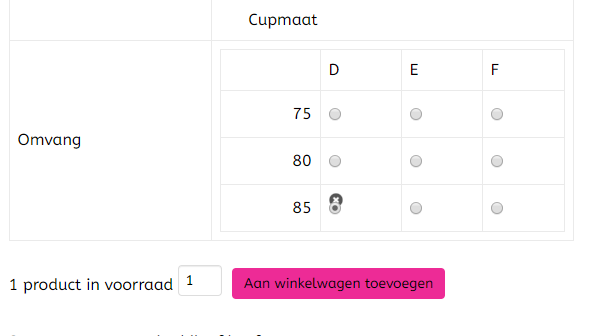

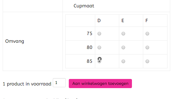

I see this on the front
You will see that I have selected the choice and can click the shopping cart button.
This should not be because the stock is 0.
When I click on the shopping cart, the standard variant is added

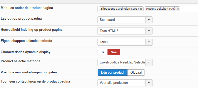

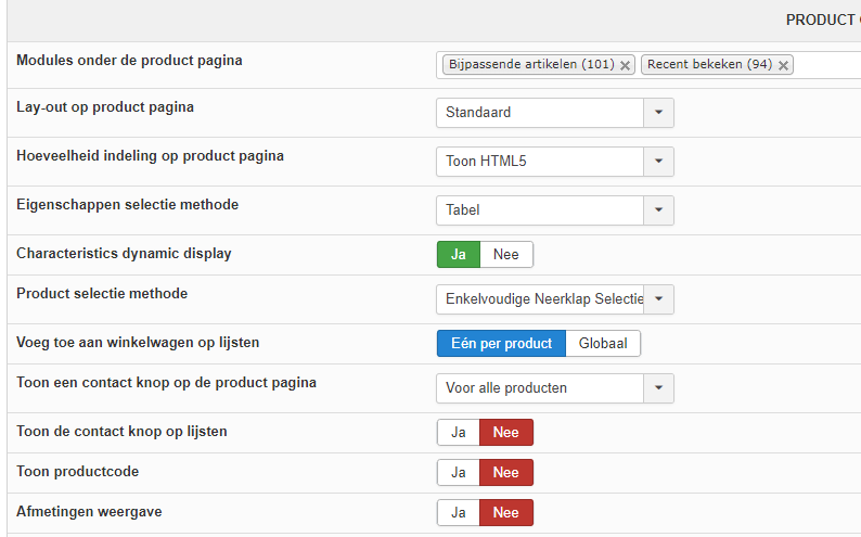

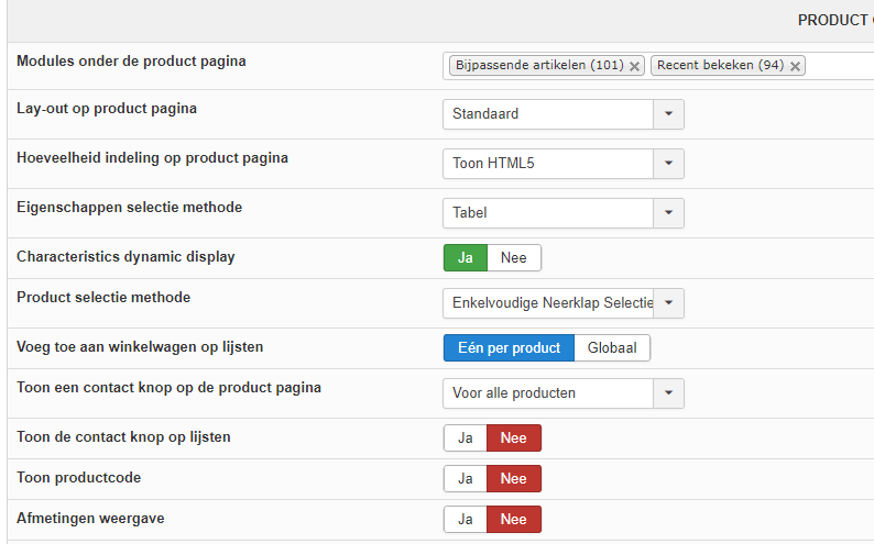

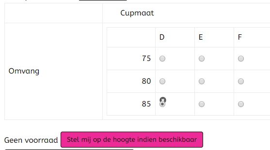

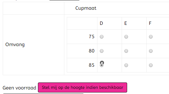

In the backend I now set it like this:
If I go to the front I will see this.
Hopefully you can reproduce it now.

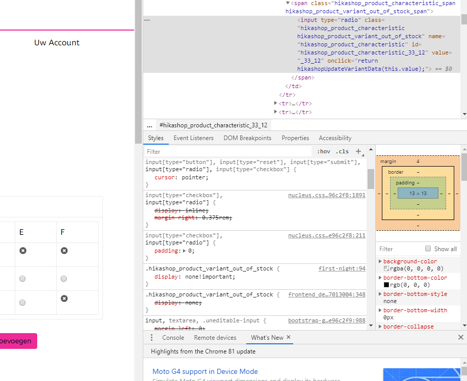

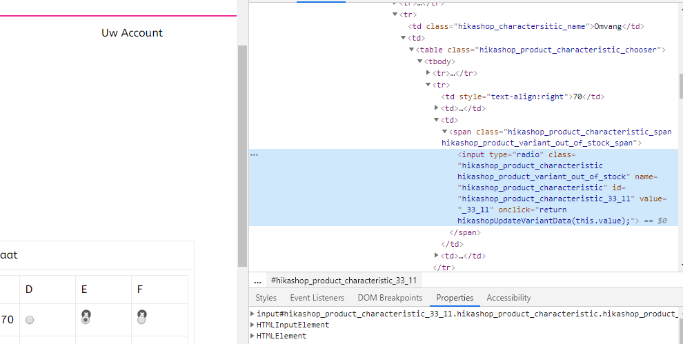

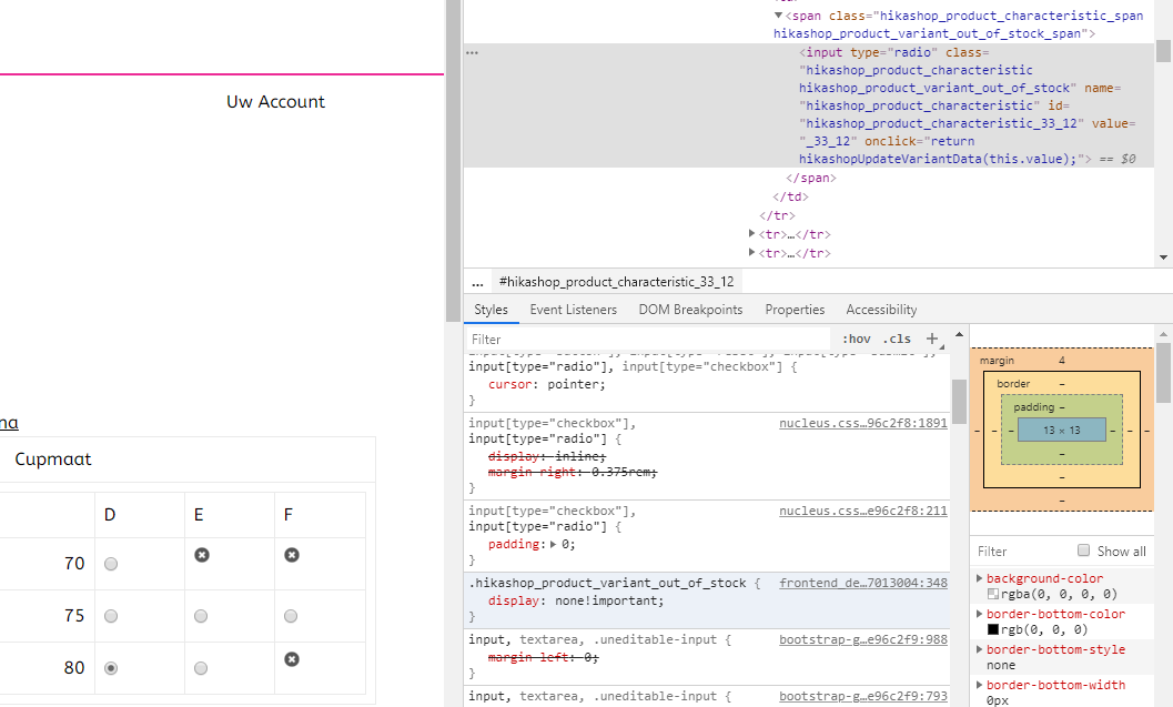

I cannot reproduce the problem on my end either.
That problem comes from your CSS customizations or your template's.

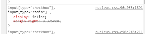

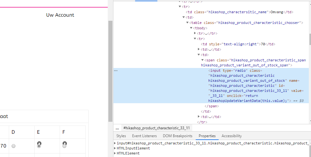

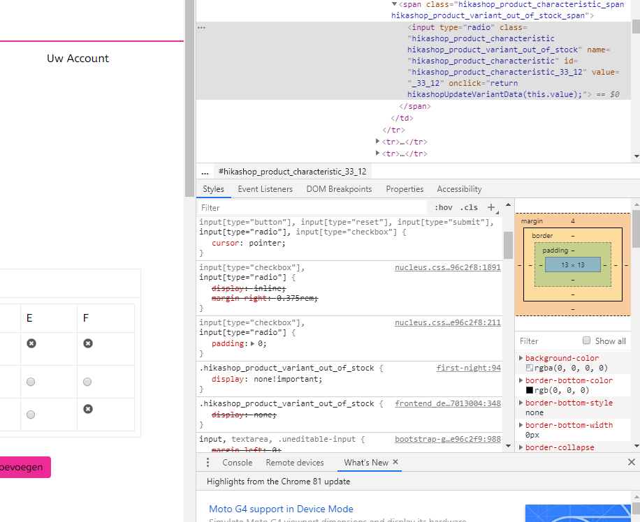

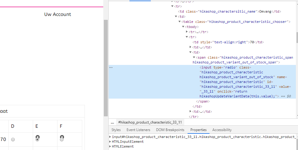

By default, there is some CSS in HikaShop hidding the radio buttons of variants without stock:
monosnap.com/file/vCqS5Sgea70NV6wniRNoaZCZqsckp8
On your website, you don't have that CSS for some reason, or it is overridden by some other CSS and that's why you can select a variant without stock and purchase it.

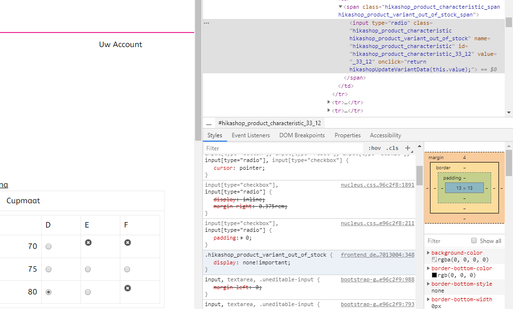

I found it and am in the Grantry Template I am using.
And that is what this piece contains
Your code is further on and I changed it with! Important behind it and then it was solved, because then it takes precedence
