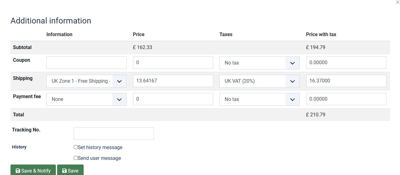

Hi Nicols,

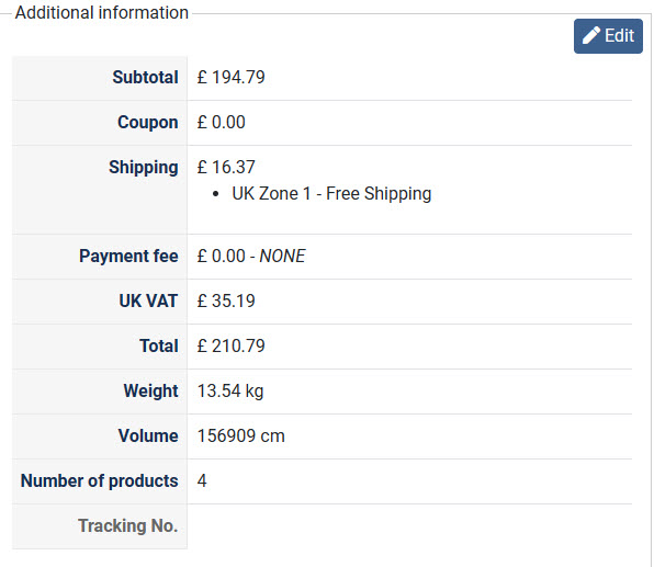

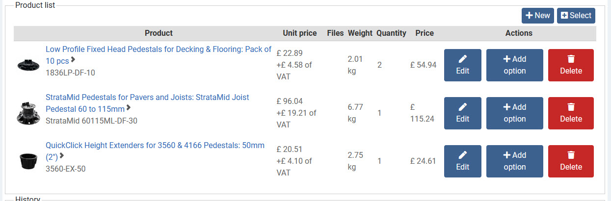

W are gtting errors in additions when using the MAnual Order Creation in the Backend. Basically Goods are being calculated and totalled correctly. When adding Shipping charges, the VAT is caculated and added correctly to create the Shipping sub-total. However, when Hikashop combines the Goods and Shipping sub-totals, th pence colun of the sipping sub-total is not included in the Invoice Total. It looks lim the shipping sub-total is being rounded down to the nearest whole Pound. The invoice totals are therefore incorrect.
Pease can you suggest a fix for this. I have attached screenshots from the transaction and also the problem description from the operator.
Chris Dunn
Manual order.
Calculates product prices and VAT correctly.
Add the shipping in under Additional information. Shows the correct amounts but is not adding the product subtotal and shipping together properly.
Product sub-total : £194.79
Shipping: £36.17
Total should be £211.16, but Hika shop only adding the whole pounds from the shipping and is showing a total of £210.79. Total VAT is showing correctly.

3 years 4 months ago #351162
Thanks for your feedback. I've made a patch which should fix the problem. Download again the install package of the latest version of HikaShop on our website and install it on yours and it will add the patch.
