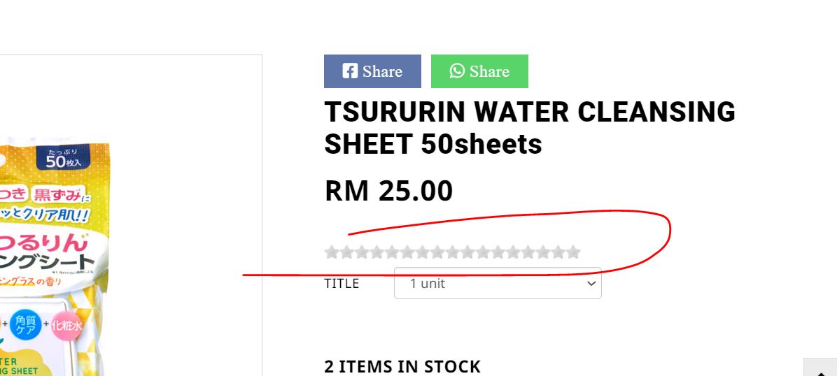

Please help to check this for the vote and comment, the maximum star is set to 5, but end up with got 10 star

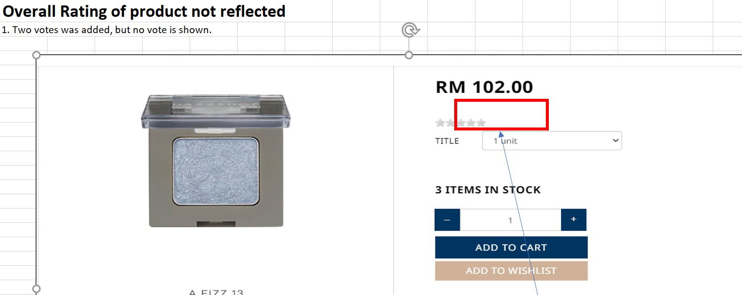

3 years 4 months ago #351658
also for this the voting does not reflect on it when there are votes is added

3 years 4 months ago #351659
There were important issues with votes which were fixed in HikaShop 4.4.0.
I would recommend updating to the latest version of HikaShop. Then, post a new vote on that product, and it should sort itself out.

3 years 4 months ago #351671
I think the most important changes, regarding the vote calculations, were in administrator/components/com_hikashop/classes/vote.php
