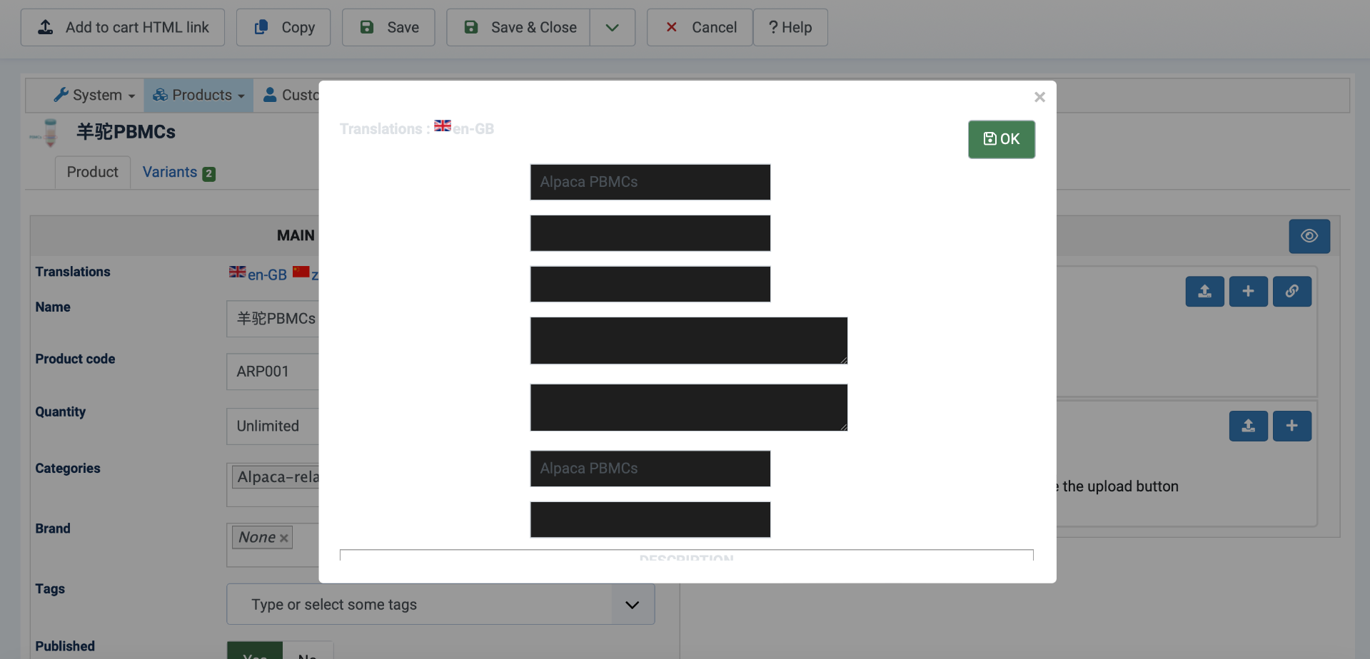

HikaShop backend is experiencing some issues with the color template in Joomla 5; the title information is not displaying correctly. Please review the attached screenshot.

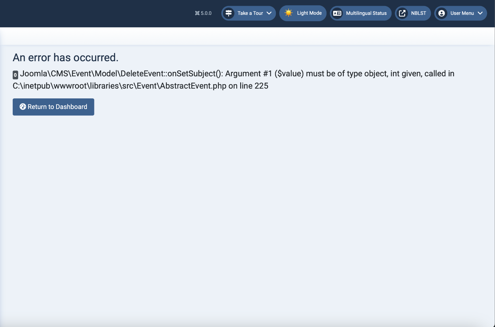

Additionally, when attempting to delete a product that has been created, an error has occurred. Kindly check the attached screenshot for reference.

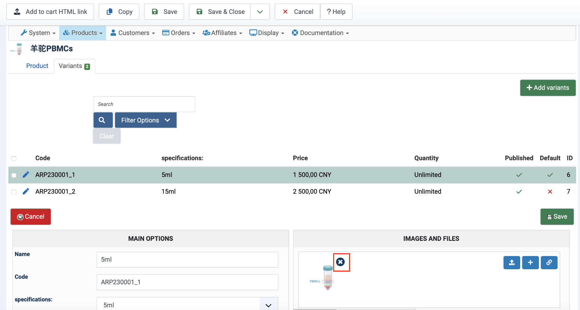

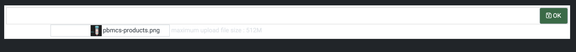

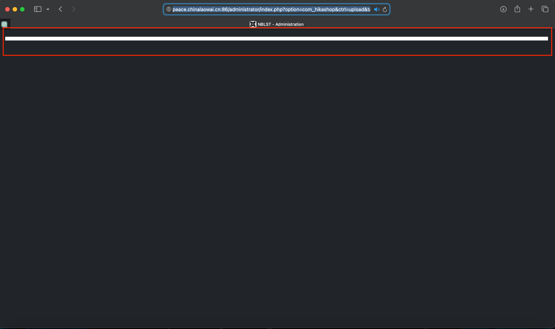

Another issue here: when uploading or selecting an image or file in product variants, it gets stuck on a page with nothing on it. I need to hit the back button, and then the photo or file will appear, but I can't delete it at all.

1. I'm not able to reproduce the issue on my end.
Could you provide a backend access via our contact form so that we can check on the situation ?

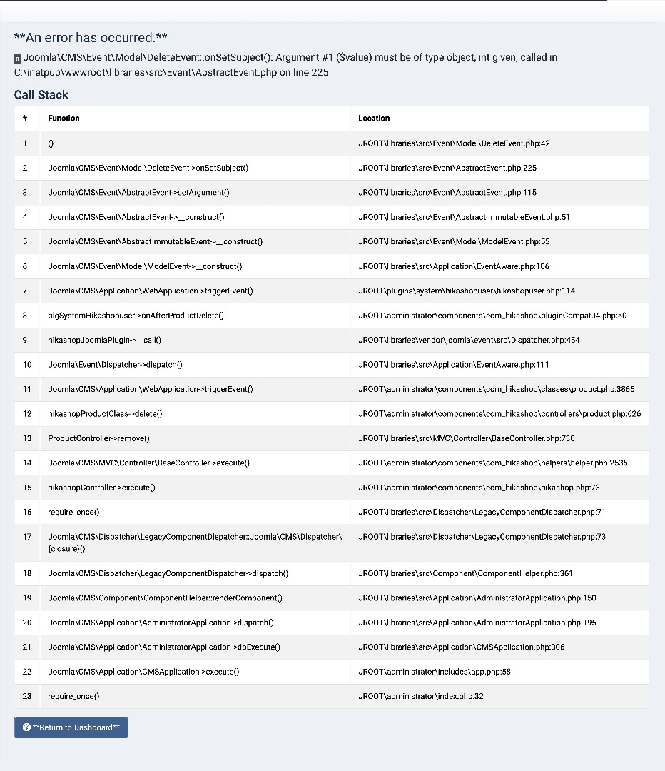

2. This looks like a bug in another plugin which isn't compatible with Joomla 5. Please activate the "debug" setting of the Joomla configuration in order to get the full error message with the callstack. It should help better understand what's going on.
3. This error has been patched on our end. Download again the install package of the 5.0.0 on our website and install it on yours and you'll get the patch. Then, clear your browser's cache and it should work fine.

Issue number 3 has been resolved after installing the latest version of HikaShop. Thank you.

Thanks for the screenshot. I've added a patch on our end in order to fix the problem.
Download again the install package of the 5.0.0 and install it on yours and you'll get the patch.
