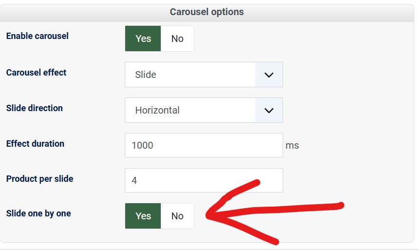

Hello
It seems that on PC and desktop, the "slide one by one" option in "carousel options" does not work when set to "Yes".
thanks

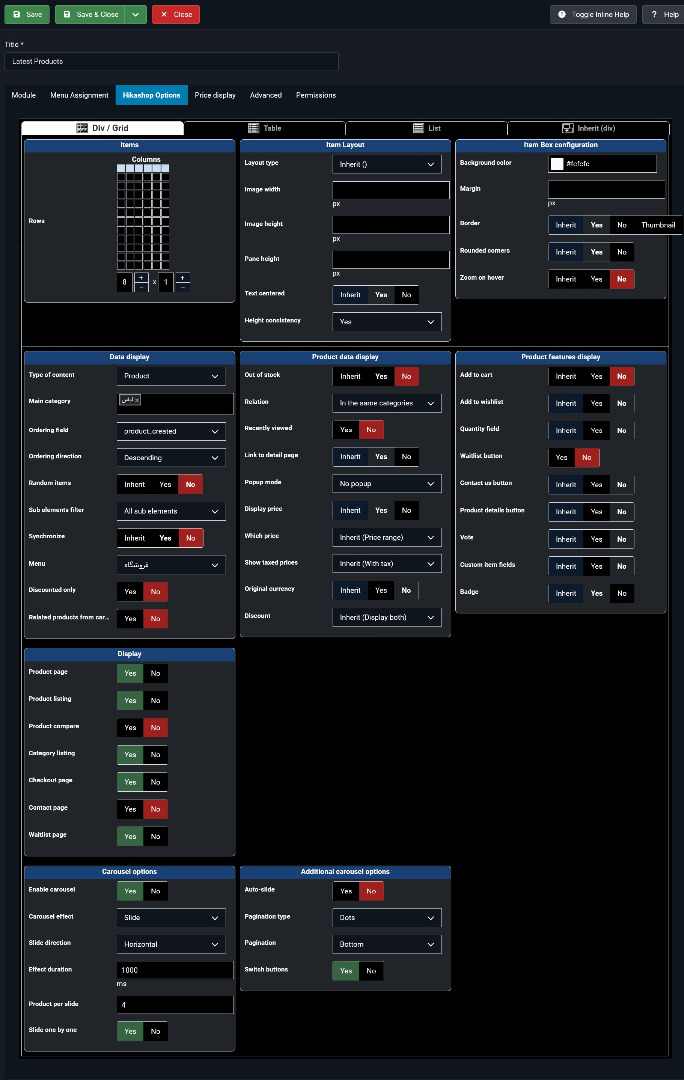

Could you provide screenshots of all the settings under the "HikaShop options" tab of the module ?

rows and columns configured in my module is 8 x 1
the number of products loaded is 8
i attached 2 screenshot for this problem

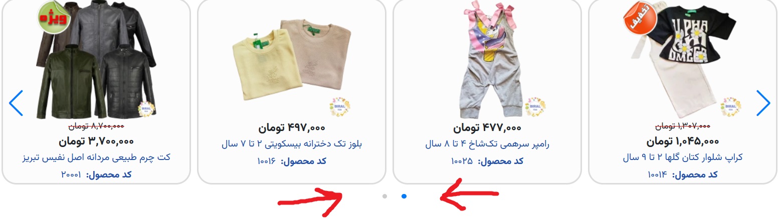

In previous versions, the number of dots under the slide to move between 8 products when the slide one by one option was enabled was 8 dots, but now it has become two dots whether this option is enabled or not, and when scrolling between products, instead of scrolling one by one, it scrolls four by four.
  • Posts: 86181
1 year 4 months ago #367112
Thanks for the details. I've made patches for this issue.
Download again the install package of the latest version of HikaShop on our website and install it on your website and you'll get the patches. It will then work 1 by 1.
