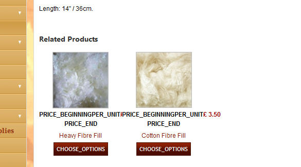

Hi Again, I appear to have broken 'Related Products' the code is showing instead of the wording? I have tried unistalling and creating a new module but this still fails. please see attached, this only effects 'Related Products'

It appers you have modified the language file and have something out of place? Make sure any changes you make are in the override section.

Hi, I have not modified any files since it was working ok? have checked the language file and it looks ok, even used the todate one from your site and this has not worked. I have been installing some modules/extentions and unistalling them as they did not work correctly so this may have caused the problem, anywhere else I could look for the issue?

It indeed seems that you have a problem with your translation file. Please try to retrieve a new version from our servers via the interface in the config under the tab languages.

Hi, still cannot solve this? the language file looks ok, downloaded current version, none of the links work in related product either, not sure if this might identify the problem?

Made some progress with this but still got a problem, it does as first show on the image below as you will see if you follow this link
www.mohairbearmakingsupplies.co.uk/index...ut=listing&Itemid=52
then select one of the related products, you will now see it's ok? select the stuffing tool again and you will see the page where you first landed and was screwed up is now ok?
hope this helps.
thanks

It seems that you edited the file listing_price of the view product and changed the way the price is displayed. It might come from that. Could you check the code there ?
If you reverse the customization of the view, does it work ?

Not changed anything there that I am aware of? price changes are coming from the language file in the override I have tried removing the comments there but it still does not work and has worked ok since the comments were put in the override?

Could you check in the menu Display->Views if the file listing_price of the view has been customized, just in case ?

Deleted the changes made 3 weeks ago, that has not made it work correctly?

I see that you have your related products module as a normal module of your template. Instead, could you unpublish it and add it to the option "modules under the product page" ?

It was already in the modules under prouct page and published. The ordering field in parameters is set to ordering is that correct?

it's ok I have sorted it.

It was the 'modules to display under the main area' that was the problem, published the one under the product page and that one works ok but the other still does not work, still not to worry as this one works.
