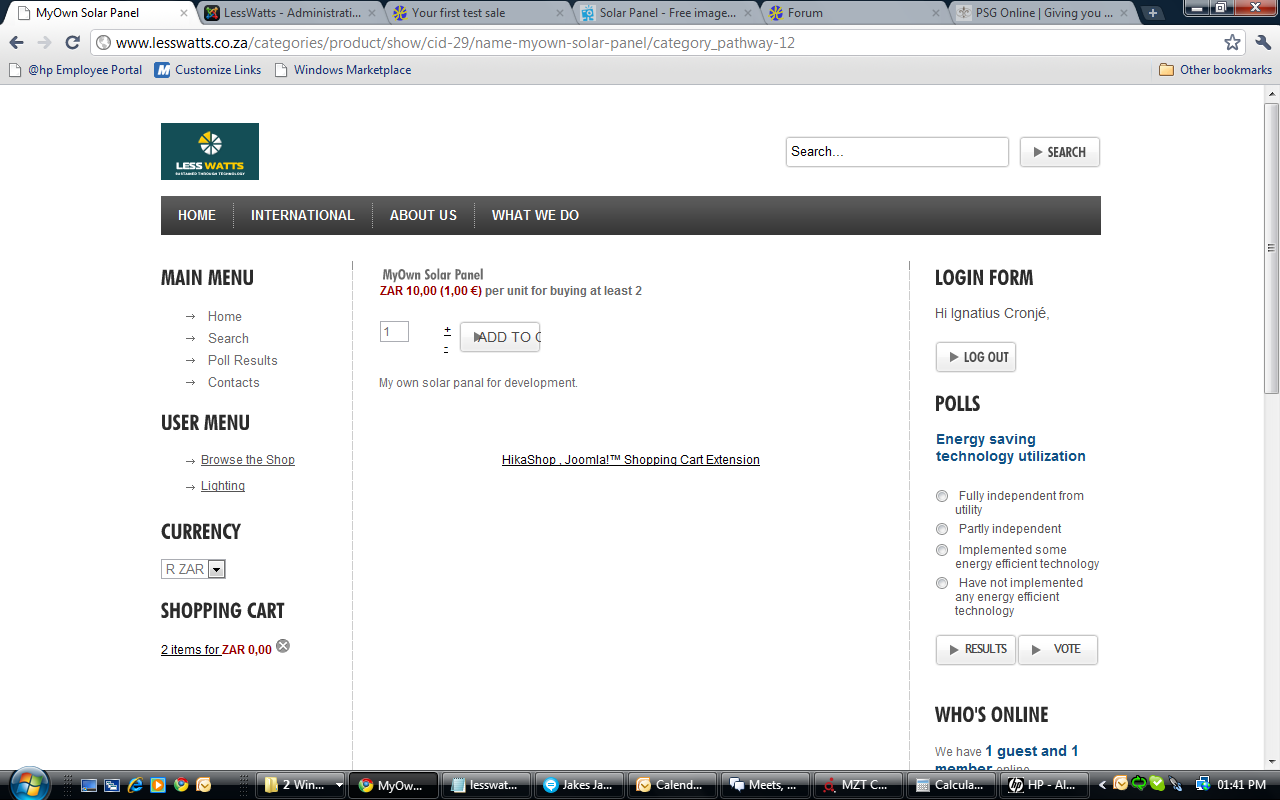

I have spent two day configuring Hikashop, and I must say it is a brilliant product.
I do however find that in certain screens, the layout is not displayed a 100%. Included is a screenshot of one such screen.
Notice the Add to Cart text on the button. It is different to the other buttones on the screen. My guess it has something to do with the template I am using.
Does anybody know how to fix it?

The problem is that your template makes the buttons using an image : templates/theme469/images/button_main.gif
That image has a fixed width and the text of the button is too long to fit in. The easiest solution will be to edit your translation file in the config under the tab languages and change the translation of "add to cart" to "buy" so that it fits in the box.

Is there a way to change the text font and the starting position of the text then?

OK. Fixed.
I changed the Button style under General Display options to CCS and it is now much better.
The nice thing about the default CCS configuration is that it draws attention to the buttons, which will also the process flow.
