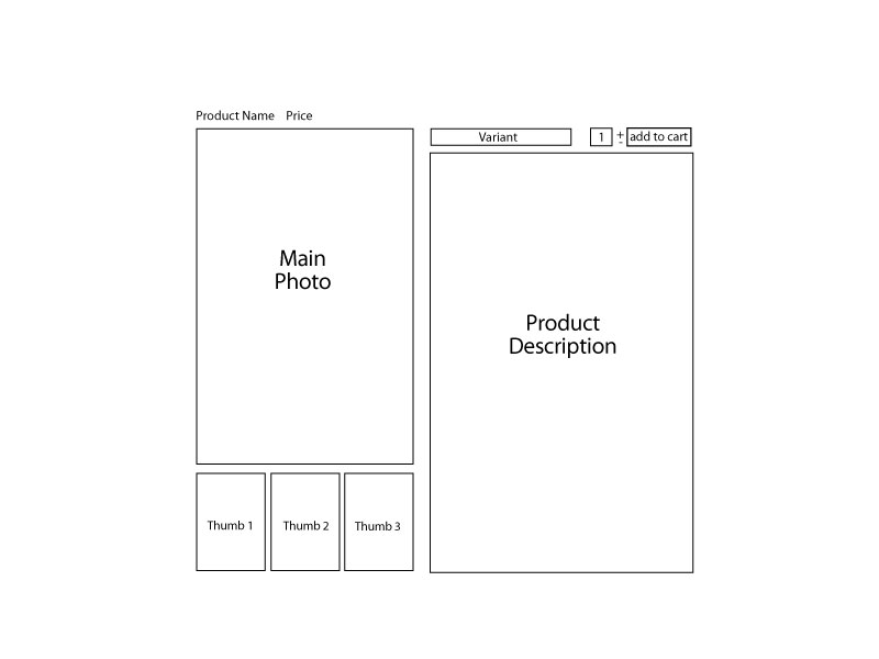

I am trying to change the layout of my product page, but cant figure out where in the CSS(if in the CSS) to make the changes. I have attached a jpeg showing what I want to do. Any suggestions would be very much appreciated.
Thanks.

You will have to edit the file show of the view product via the menu Display->Views to move around the different elements.

It's more about HTML than PHP.
You have four parts on that view: top, left, right and bottom.
You will find the corresponding divs in that file: hikashop_product_top_part, hikashop_product_left_part, hikashop_product_right_part and hikashop_product_bottom_part
Inside each part, you will find one div or span per element: hikashop_product_name_main, hikashop_product_code_main, hikashop_product_image_main, hikashop_product_price_main, etc...
As you can see, the description is in the bottom part. If you want to move it to the right part, just cut and past the description code in the right part div.

That's exactly what I needed. I wasn't able to get it exactly like I wanted, but pretty close. Thanks again.
