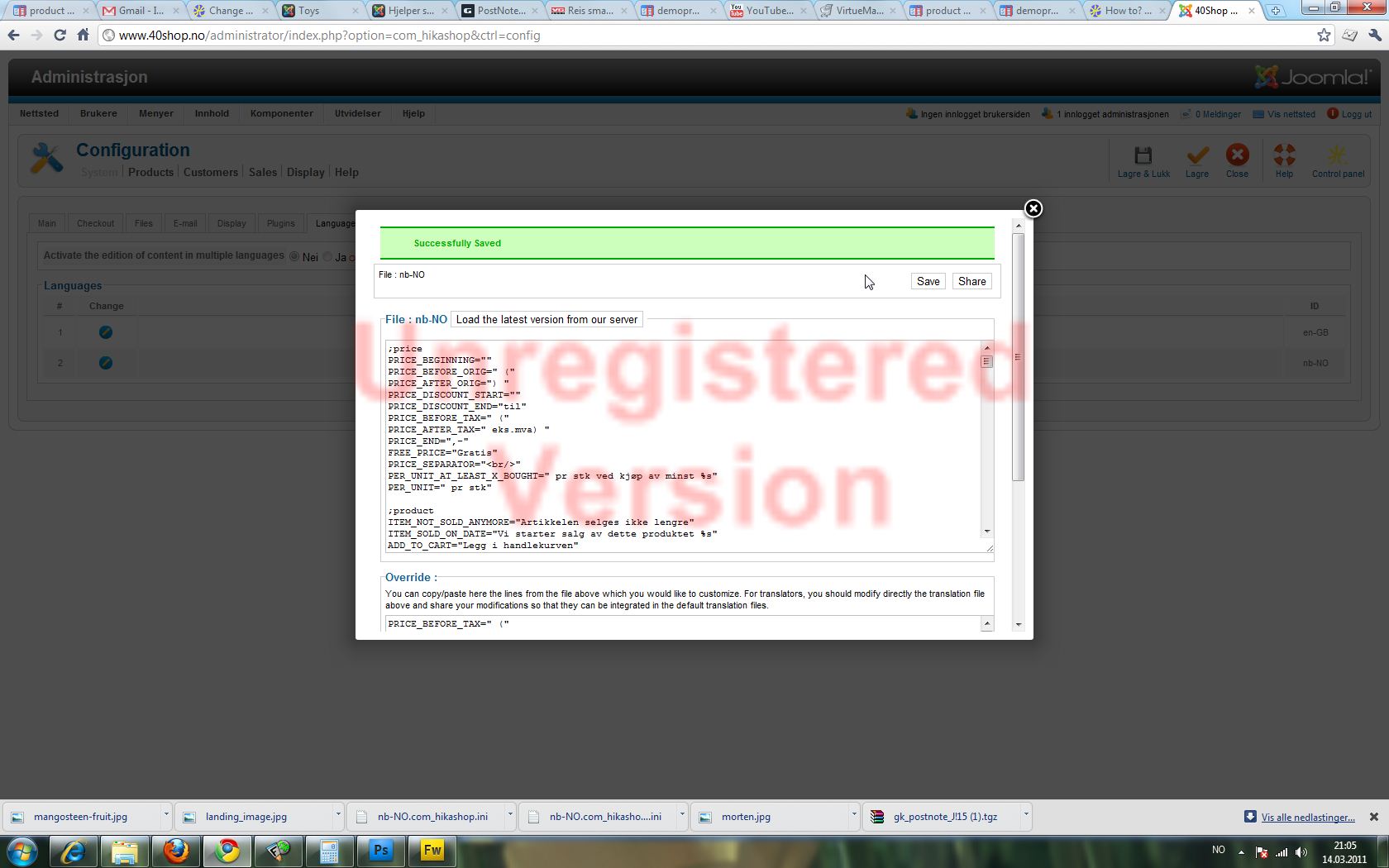

  • Posts: 6
15 years 6 months ago #10949
This is what i see.
Also Norwegian Language is installed.
I think i do it correct.
After i see that green bar i X out from the lightbox popup window.
  • Posts: 86183
15 years 6 months ago #10950
Thank you for your report. We tested the no-NB translation file on joomla 1.6 and there was a double quote missing at the end of line 397. We updated the file on our server so if you reload the translation file from the interface it should work.
  • Posts: 6
15 years 6 months ago #10953
Yes that solved the issue. Working perfect now.
Thx.
