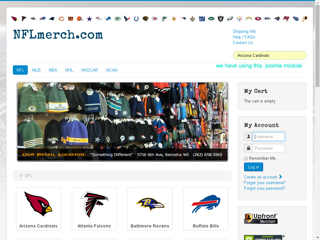

  • Posts: 10
10 years 10 months ago #188112
hi
we have try to Product Picture in Search Results ( joomla default search page.)
please check my website nflmerch. com
can you please help me ?
Deepz

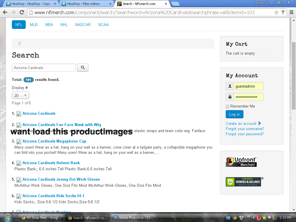

  • Posts: 10
10 years 10 months ago #188161
thanks for your reply.
What i want ?
please check this screen shots. And please help me.
waiting for your biggest Help.
Vinu

  • Posts: 10
10 years 10 months ago #188385
Once you check this link
www.nflmerch.com/component/search/?searc...hrase=all&Itemid=103
we have using default search (joomla)
But i want show product images or thumbs
can you help me ?

  • Posts: 10
10 years 10 months ago #188466
Thanks for your reply
can you please tell me
have any another search extension which is compatible with HikaShop and which supports the images display ?
