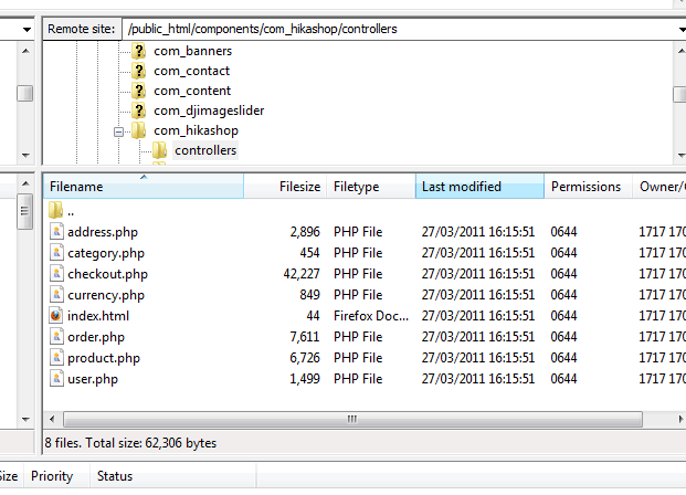

I don't even have the config file. These are the files I have on that path:
Please help.

You're not looking at the good folder.
You're looking at components/com_hikashop/controllers and not administrator/components/com_hikashop/controllers
