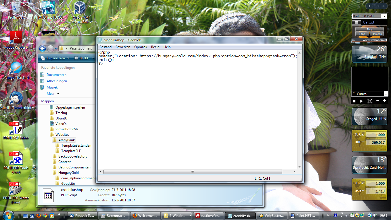

I tried to set up the cron job with the php file into the root. This is the message I get every 5 minutes and in side the Hikashop I do not see a triggered last cron job. Do you have a clue what this means?
The message I get from my server:
Status: 302 Moved Temporarily
Location: my-website.com/index2.php?option=com_hikashop>ask=cron
Content-type: text/html

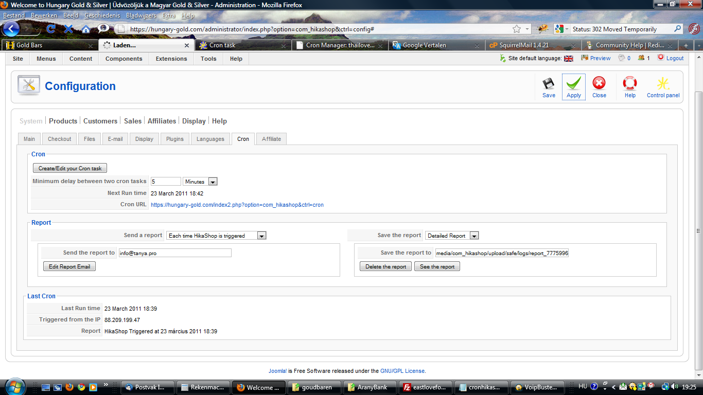

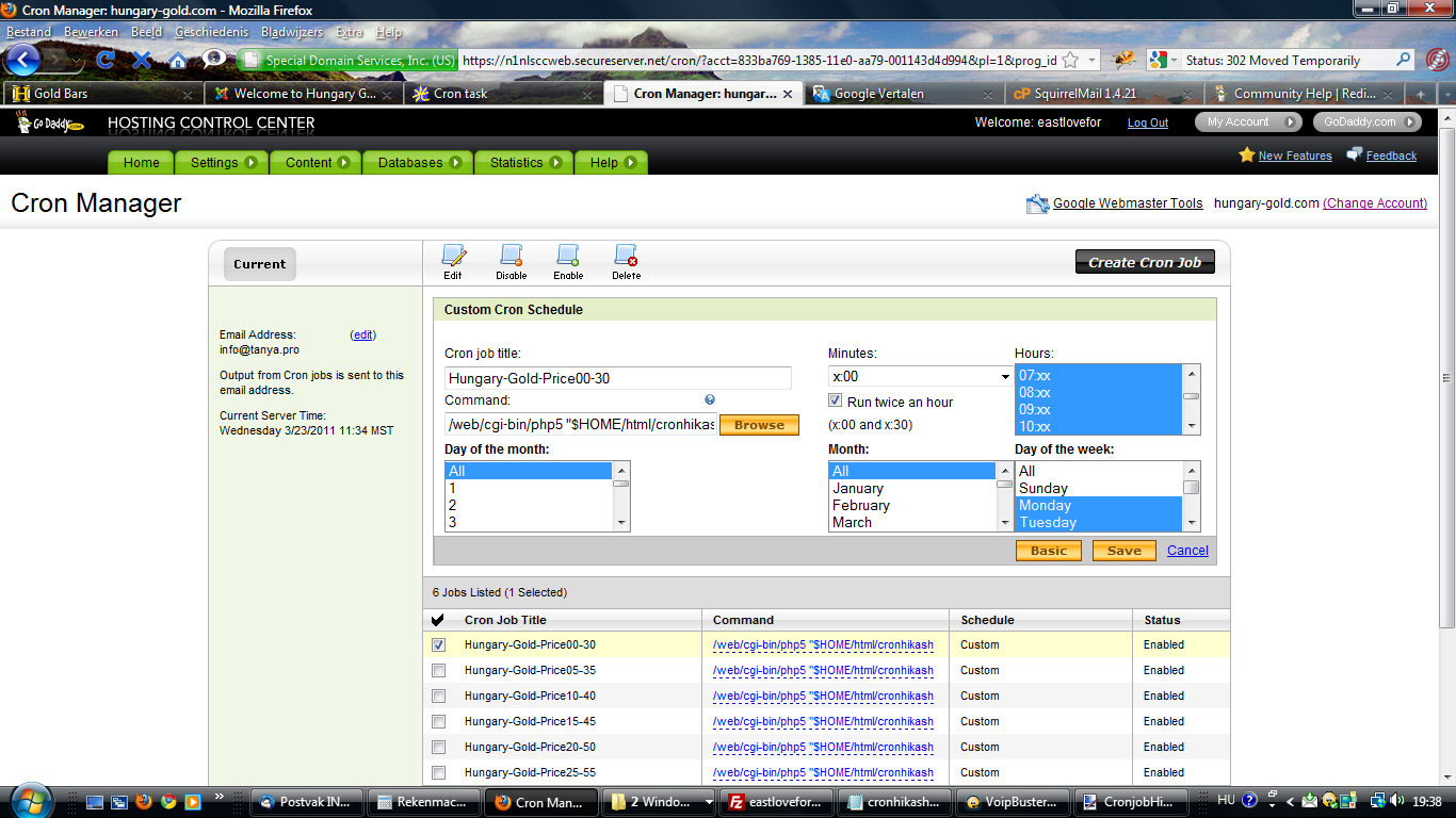

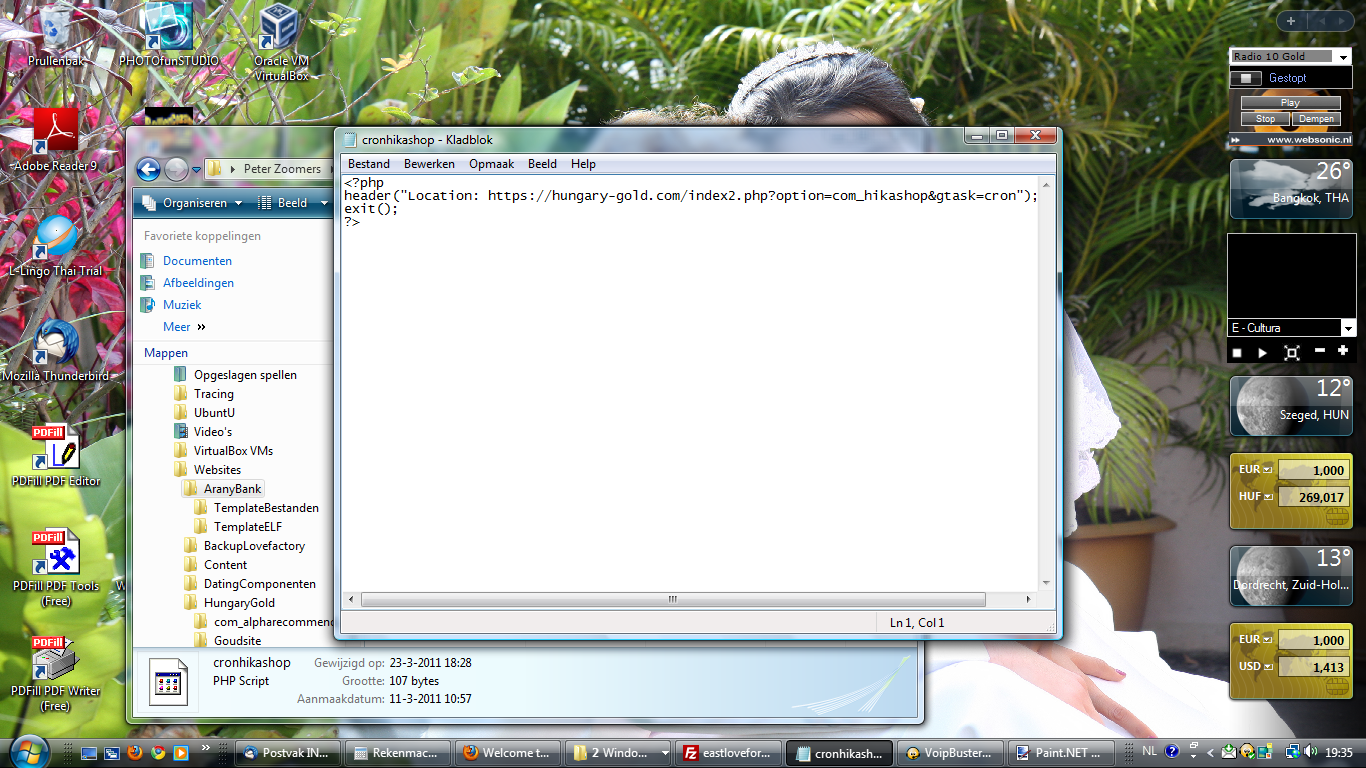

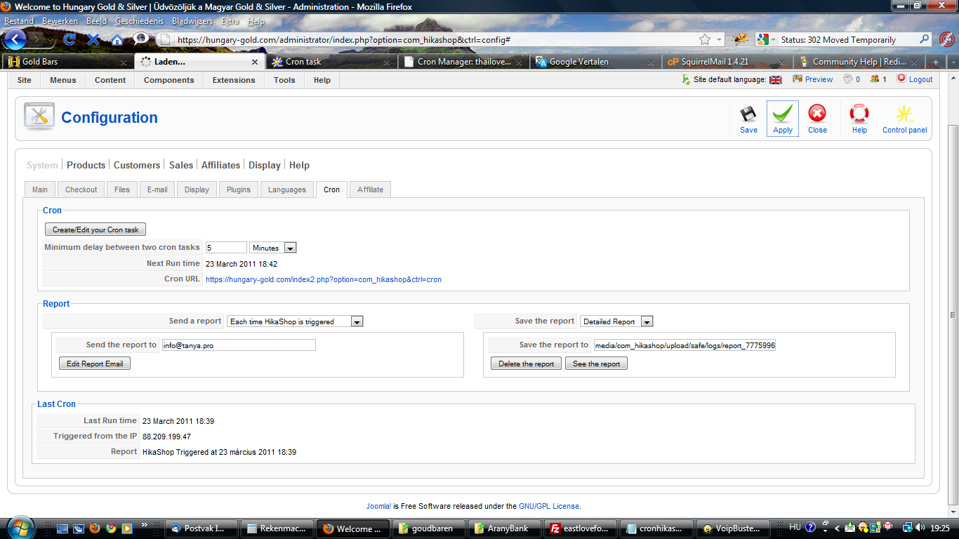

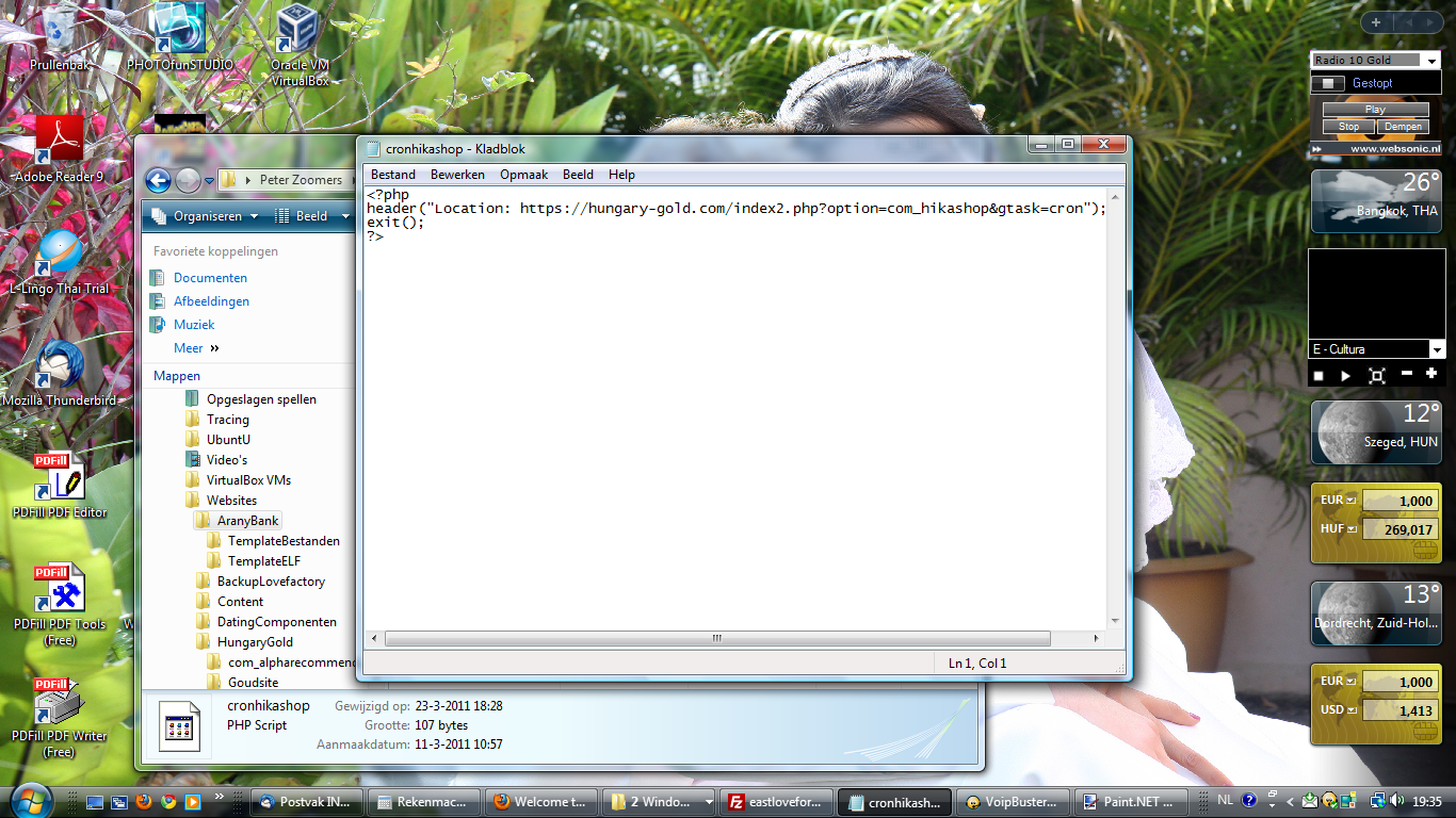

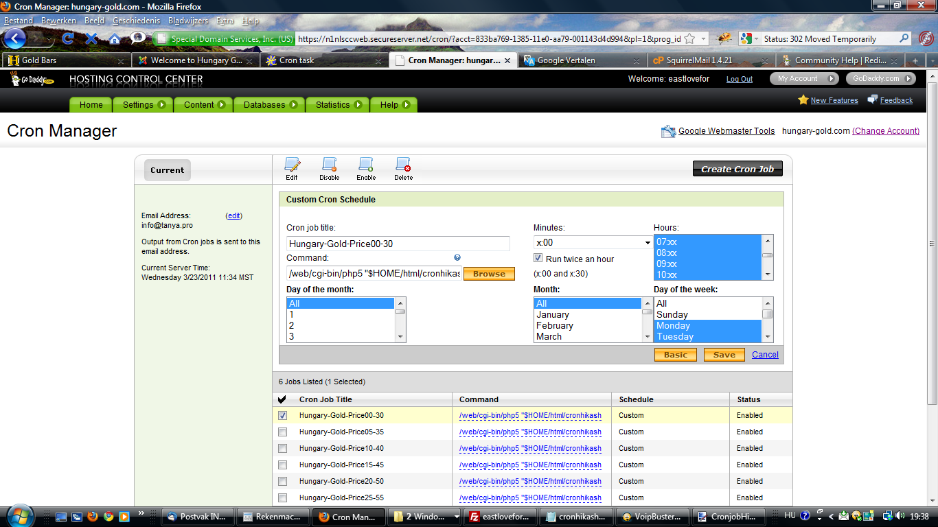

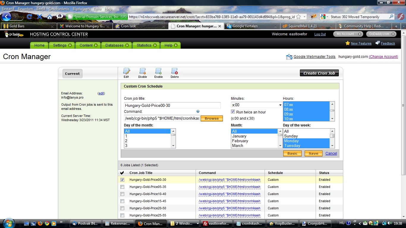

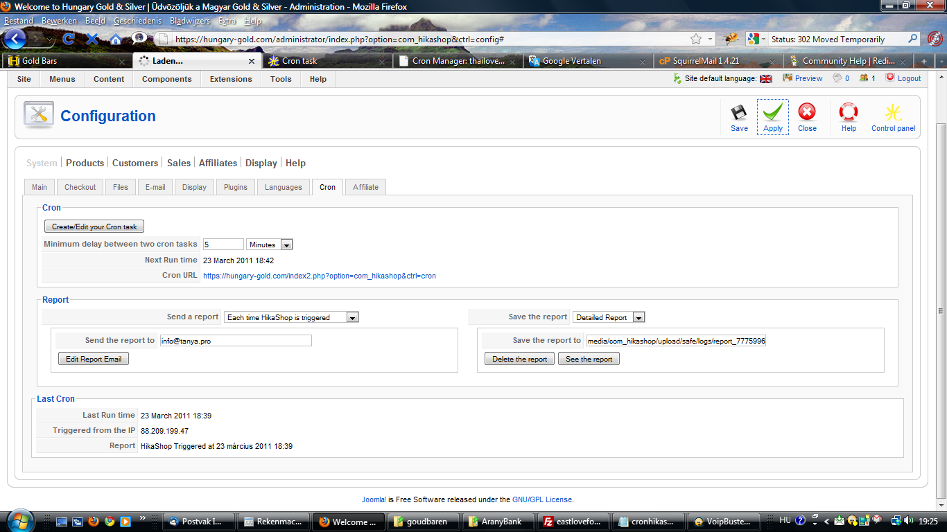

Could you do a screenshot of your cron task configuration ?
  • Posts: 23
15 years 5 months ago #11834
Screenshot
  • Posts: 23
15 years 5 months ago #11835
Screenshot
  • Posts: 23
15 years 5 months ago #11837
Screenshot
  • Posts: 86104
  • Thank you received: 14203
15 years 5 months ago #11841
From what I understand, you're using a command shell like this /web/cgi-bin/php5 "$HOME/html/cronhikashop.php"
in your cron manager.
The problem is that the shell is not able to understand the location commande you set in the headers and is not able to call your page.
In your php file you should write this (supposing that your file is in the root folder of your website):
$_GET='com_hikashop';
$_GET='cron';
include('index.php');
exit;
That way, instead of sending back to the shell a header, you're triggering directly the cron of hikashop without any redirect.
