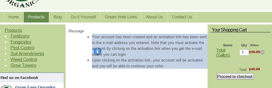

Apparently my email is not connecting with HikaShop. How do I do that? It is set correctly in Global configuration. Users are getting this message "Your account has been created and an activation link has been sent to the e-mail address you entered. Note that you must activate the account by clicking on the activation link when you get the e-mail before you can login.
Upon clicking on the activation link, your account will be activated and you will be able to continue your order"
No email is being sent, however.
