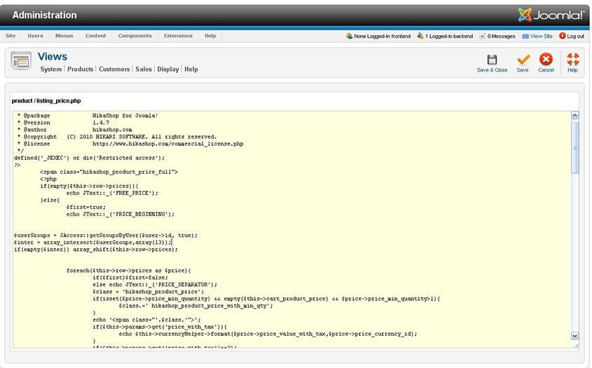

  • Posts: 86181
15 years 5 months ago #12504
You should be able to do that in the file listing_price of the view product via the menu Display->Views:
$user =& JFactory::getUser();
if($user->id != 62) array_shift($this->row->prices); //supposing that 62 is the id of your coop user

For 1.6, it's more complicated as you will get an array of groups:
$userGroups = JAccess::getGroupsByUser($user->id, true);
$inter = array_intersect($userGroups,array(29));//if group 29 is for coop
if(empty($inter)) array_shift($this->row->prices);

15 years 5 months ago #12648
ok, when I put this in it works great if the logged in user is in userGroup 13 (my coop group id), but when the person is not logged in it shows no price or add to cart field.
I added it right at the beginning after:
$first=true;
echo JText::_('PRICE_BEGINNING');
and before the foreach
am I not putting it in the right place?
I feel like maybe I need to make that statement an if and have the else be
$inter = array_intersect($userGroups,array(1)); // where 1 is public group
with no array shift? but I keep breaking it and losing the add to cart block.
I REALLY appreciate the help on this. my customer brought this issue up to me again today so I really want to get it right if at all possible (and anything is possible if one knows php well enough? :blink: )
Last edit: 15 years 5 months ago by dontflinch. Reason: typo

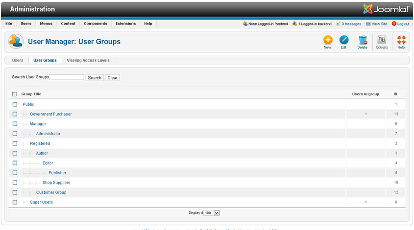

15 years 5 months ago #12662
Could you post the piece of code you used and a screenshot of the groups listing you have in the back end so that we can see the corresponding ids ?

  • Posts: 52
15 years 5 months ago #12729
ok I found how to do it in joomla. I am so sorry to have been a bother!
I edited the user group options to set the guest group to "customer" and had to move the special group back under registered. but now it seems to work as my customer wanted.
now I just have to manually edit almost 700 products public price to "customer" group, lol.
thank you again for your help - you guys are really fantastic!
