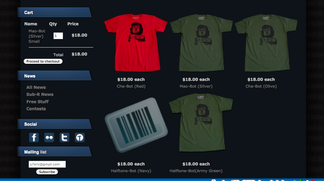

Hopefully this will be the last time I bug you. I have come a long way in a short time thanks to your help. Right now, I have three image questions.
1. Could you tell me where to go to change the spacing between images on the main product listing page?
2. Along with spacing those images, how do I get the name and price centered for those images? Right now they are slightly to the left of center.

1 and 2. If you edit your products listing menu's hikashop options, you should be able to change the margin between each item box. The information should already be centered. The problem seems to come from the fact that your thumbnails are too big for the item box and they go over it. Reducing the thumbnails size in the config should greatly help...

There is no size for the boxes. Their width is generated automatically based on the width of your content area and the number of columns you set in the hikashop options of your menu/module. If you reduce the number of columns, you will have each item box bigger.

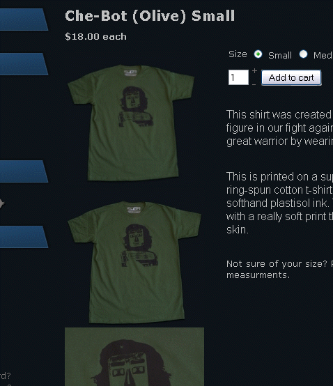

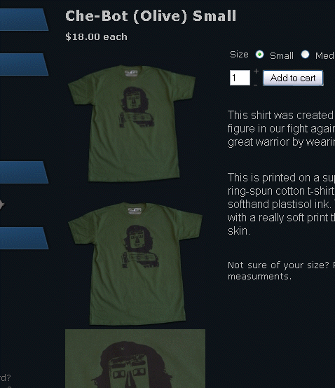

I swapped the code and ninja shadowbox is working on the child images. The problem that I have now is that the layout of the images has changed. Rather than having the main image with the child images under, the child images have become the same size as the main image.
Also, the main image still uses SqeezeBox for the pop-up, which I understand because the code is targeting the child images. Could you let me know what to change for the main image?

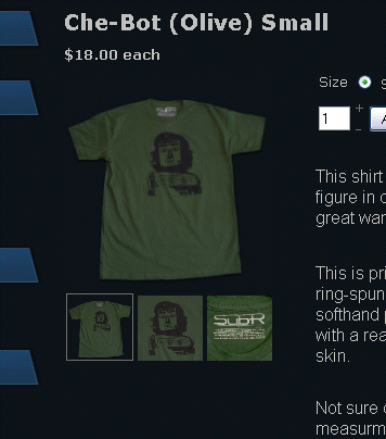

After the code change:
How I want it:

You need to do the same modification for the main image code:
echo $this->image->display($image->file_path,true,$image->file_name,'id="hikashop_main_image" style="margin-top:10px;margin-bottom:10px;display:inline-block;vertical-align:middle"','id="hikashop_main_image_link"');
Then, you just need to force a height on the small images in CSS so that they are reduced like you want.

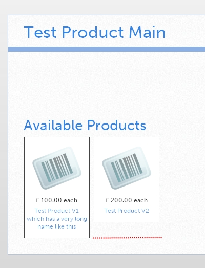

Has this situation changed? We have related products listed in our shop which use the same thumbnail image but which have a title of variable length depending on the exact part number.
See the attached image file. Is there any way I can make the item boxes the same size so that their lower edges will all be aligned? (That is, apart from trying to make the titles all the same length?)

Note that the question was for the width of the boxes.
For the height, there is no value set, but you can easily set it in CSS like that so that all the boxes have the same height :
.hikashop_subcontainer{
height: 350px;

Thanks Nicolas,
That works perfectly :)
